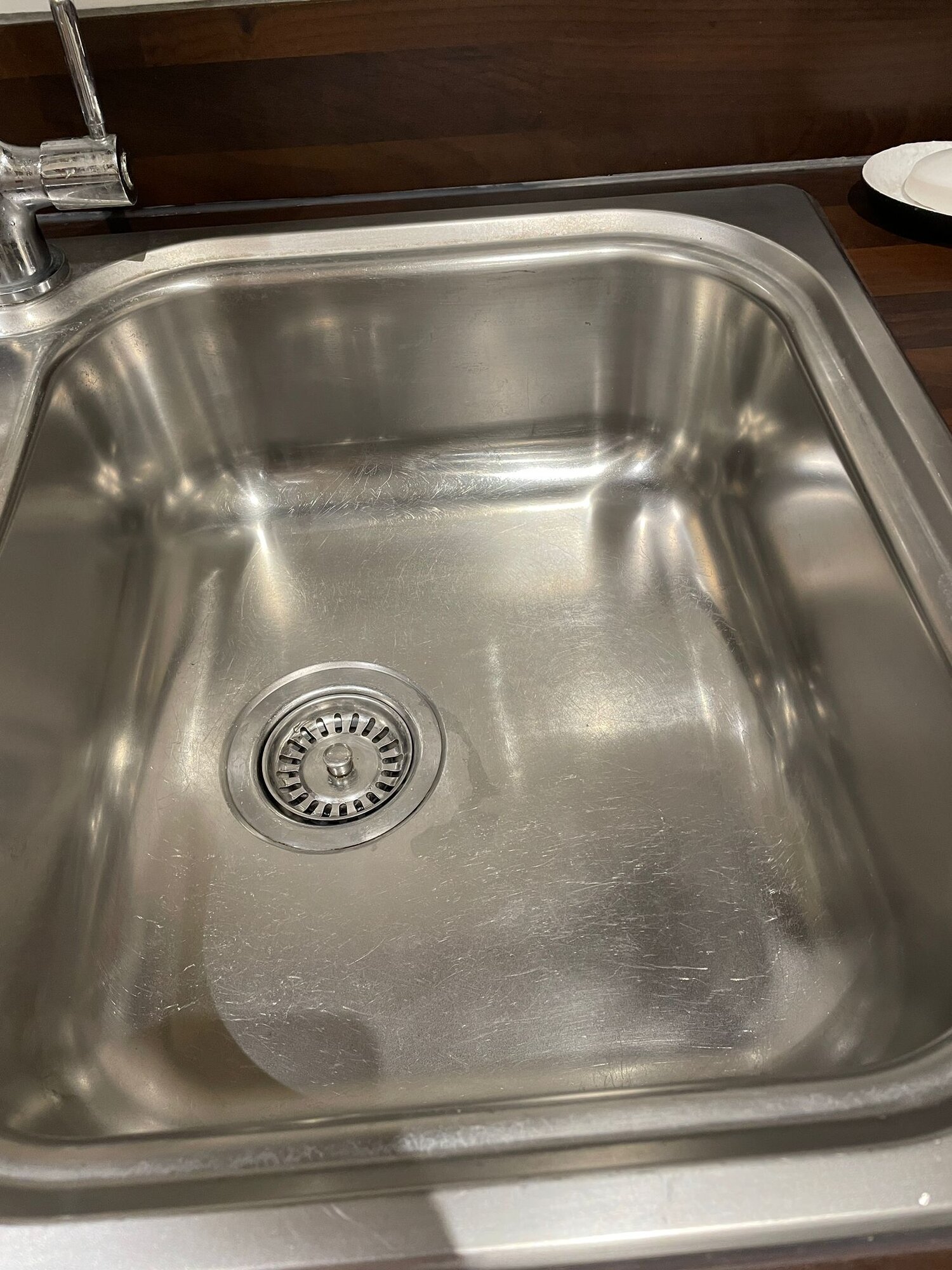

Hi all, I wanted to clean my friend's metallic sink before she got home, so I put bleach on it and left it.
Now it's stained, see the image below. Any tips on how to fix this?

Wire wool (if the sink has a matt finish already)?
As above, it should polish out.
It was bleach rather than something like the black Harpic? Bleach will not damage stainless steel, the black Harpic contains acid. I once made the mistake of using in my bathroom basin. It removed the chrome from the plug hole.

Don't use wire wool as it'll leave mild steel traces in the stainless which will eventually rust.
You could try a abrasive cleaning paste such as car chrome cleaner or even vim (if it's still available). Use a green scouring pad to assist with the abrasion.
green scouring pad is what I use. There is also a black variety that is more abrasive (and a white one that is very mild, for keeping it polished once you have restored the surface). Start with the finest grade that will do the job. An old, used pan scourer that has gone floppy is less abrasive than a new one.
Name is "ScotchBrite"
only rub to and fro in the direction of the brushing, not across it and never in circles which will leave prominent swirl marks

Clean stainless steel protects itself from rust by a chemical reaction with air that leaves a protective film on the surface. Some chemicals strip this off and cause corrosion. Including salt, vinegar, chlorine and other acid products.
HCl is hydrochloric acid. it is produced by adding chlorine to water. Household bleach contains chlorine.

It's a sink which hasn't been uniformly cleaned with bleach.
It's not some pressure sensitive industrial equipment subject to SSC requiring passivation and protection of its passive layer.
Cleaning it properly with bleach once to get a uniform appearance will do it no harm whatsoever.
My SS sinks get bleached weekly and they are still fine after 20 years.
Don't use mechanical buffing. 'Twill look horrendous.
You can get domestic stainless steel cleaner from most supermarkets if you don't want to bleach it. Its a light pickling solution so does a good job as well.
