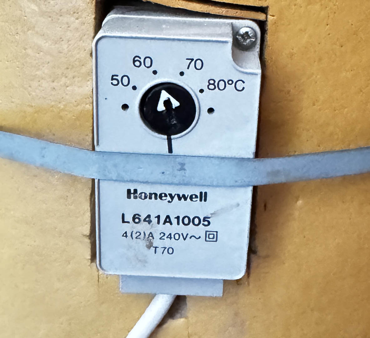

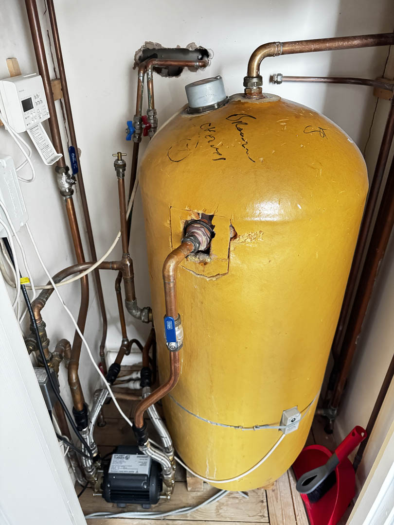

I have a honeywell timer in the cupboard with my emersion heater and its set to come on about 4am til about 7am so we have hot water for morning showers. Is it normal that the pipes out of the emersion are still hot mid day? There is no light on the honeywell so shouldn't be on and the electric switch to the emersion is off so it's not on that way either. I just want to make sure its not on all the time for some reason.

The DHW outlet pipe will stay very hot if you are drawing off even a litre or so of hot water every hour or so, you speak of pipeS being hot, some systems have a pump that circulates the DHW around the system and back to the cylinder.
You may also have a gas or oil heating coil in the cylinder and a hot cylinder can sometimes cause circulation by convection causing the cylinder to lose heat.

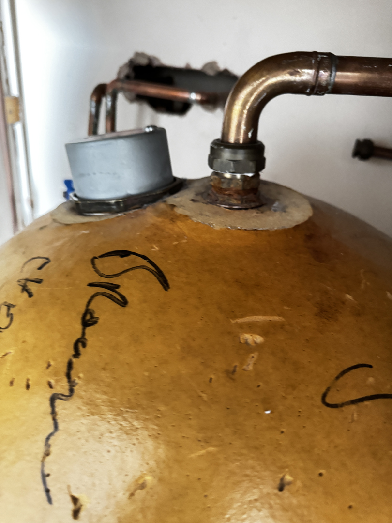

We are done with showers by 8am and then not really used. is there any way it could be on all the time? if i where to check say 5pm would you still expect it to be hot? there is a pipe out of the top of the cylinder and another out the middle into a shower pump. both are hot. I cant upload photos as too big on phone.

The pipe going up from the top of the Cylinder will be hot from convection of hot water rising. This will not continue where the pipe turns down again on its way to your taps.
If a supply pipe to a tap is hot, water is running through the tap or escaping through a leak.
Some photos of your pipe layout will help.

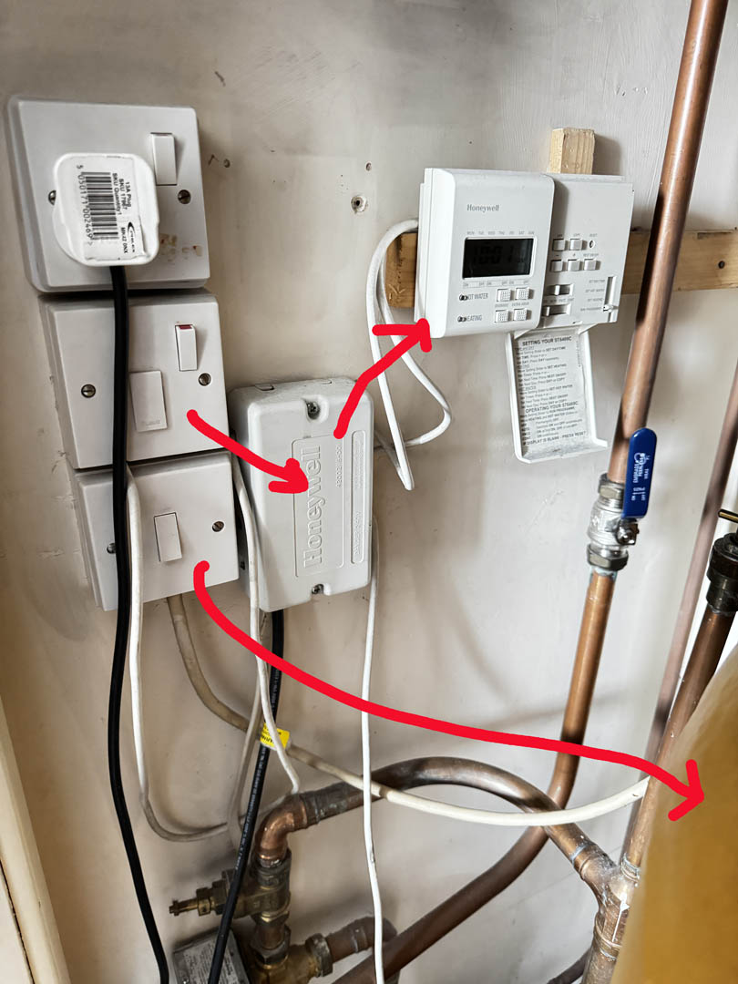

The thermostat on the top of the cylinder - the switch connecting to that is always off. I only had to switch that on when we had a boiler issue. So is it the small box on the cylinder that switches on and off via the honeywell?
In your consumer unit, turn off the Immersion Heater breaker and watch the meter to see if anything changes.
