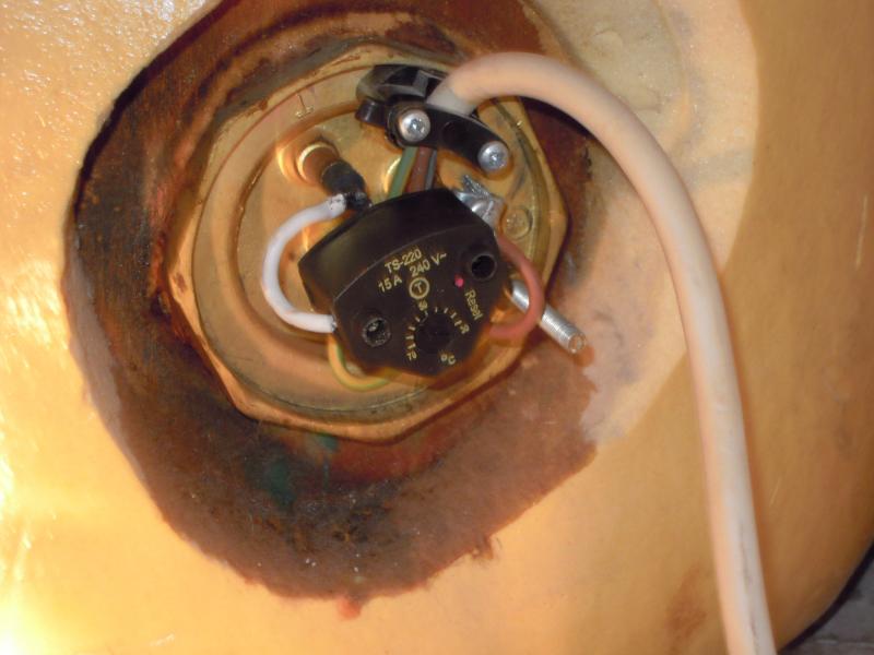

Hi
An update to this is that the water was boiling hot, and using lots of units.
I have now replaced the thermostat.
There were no instructions, so I have rewired the new one the same as the last. See photo attached.
Could anybody please confirm this is OK.
Thanks.
An update to this is that the water was boiling hot, and using lots of units. I have now replaced the thermostat.
There were no instructions, so I have rewired the new one the same as the last. See photo attached. Could anybody please confirm this is OK.
Assuming that the blue and green/yellow ('earth') are connected to the right places (we can't really see from your pic), that looks fine.
