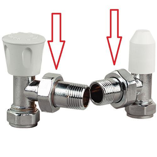

The remainder of the tail goes inside the rad. If im honest i don't like using them if i can get away with it they are prone to leaking.

Simply us a 1/2" bsp to 15mm straight coupler and whatever length of 15mm copper you require.
Tape the 1/2" thread and screw that into the rad. That then leaves you 2 15mm compression joints to make, one in the rad valve and one in the fitting in the rad. Cut the copper to the required length and ther you go.Discard the tail provided with the new rad valve.
The above is best done on a valve with a 1/2" union nut, not 3/4".

Most domestic rads have 1/2" tappings so that fitting in my picture is male 1/2" BSP to 15mm copper straight coupler, and yes you can get them in chrome.
