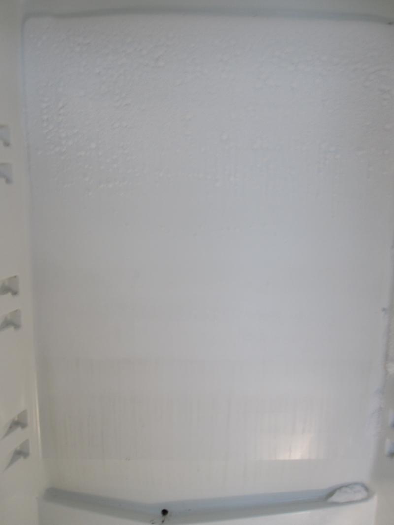

At the back of the fridge there is a black hole (shown by picture). I wonder if something is missing from here? A fan or something?
No, this is the drain hole that any condensing water forming on the back plane of the fridge will escape through. it goes down to a tray that sts above the fridge compressor where it is warmed and evaporates to the atmosphere in your kitchen. Fridges naturally dry the air inside them as a consequence of how they work
