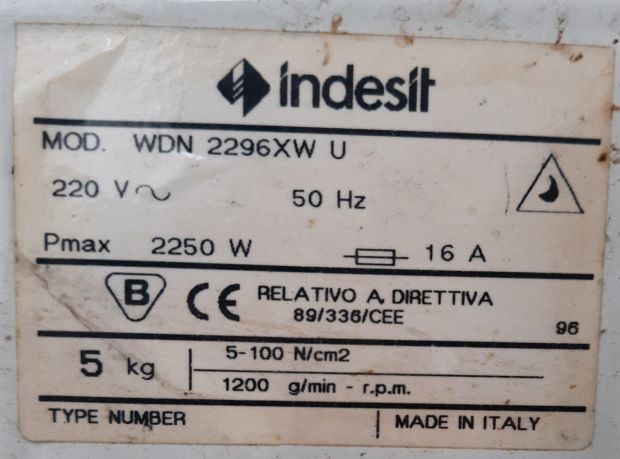

Here's the washing machine.

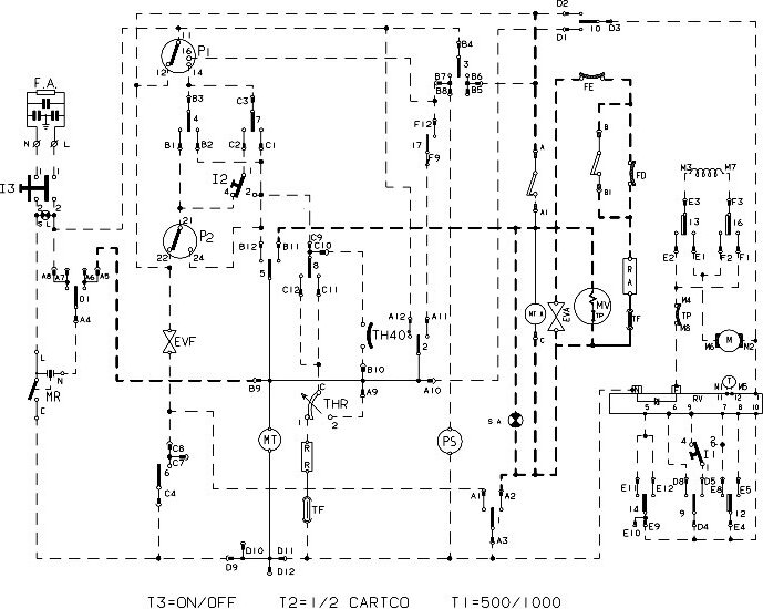

Here is its electrical diagram.

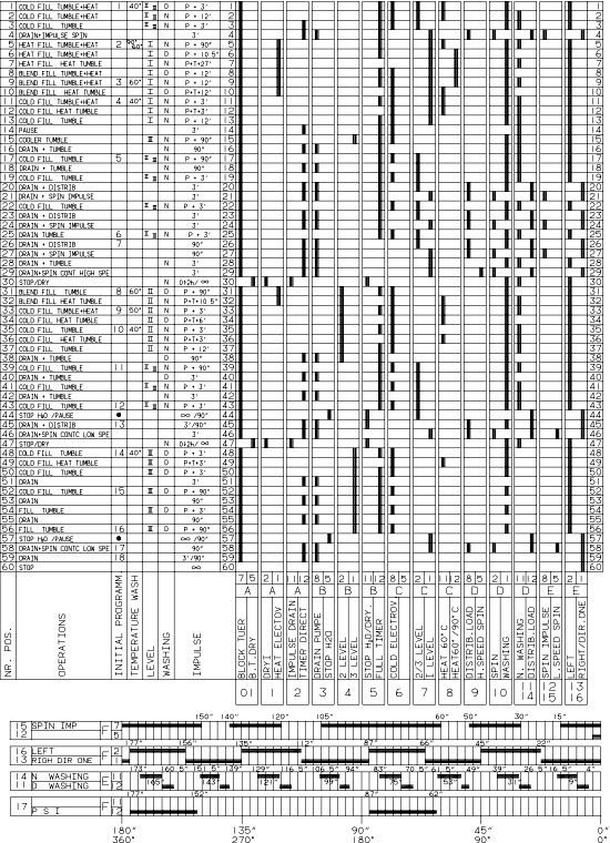

Here is its cyclogram.
Unfortunately, there are no captions, so the symbols are not entirely clear. Can you provide a link to an online page that explains this cyclogram? I want to test all the electrical circuits.
Or could you explain it in the context of this chat?
As I wrote above, I couldn't find an explanation of the cyclogram anywhere. Therefore, I assumed that the thick vertical black lines to the right of the program number indicate which switch contact is closed. The switch numbers are at the bottom (01, 1, 2, 13, 16). It's unclear why the data for switches 15, 12, 16, 13, 14, 11, and 17 are listed in a separate table below. Moreover, they don't correlate with the program number, but with the rotation angle (180 - 0 degrees, 360 - 0 degrees).
Can someone explain?
