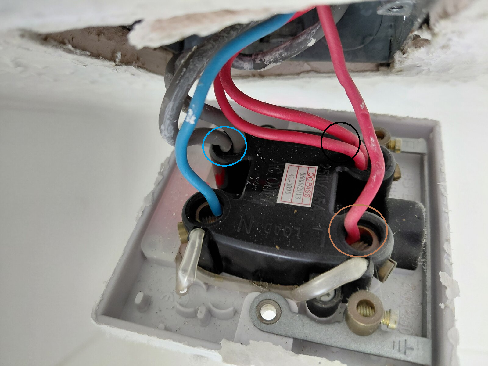

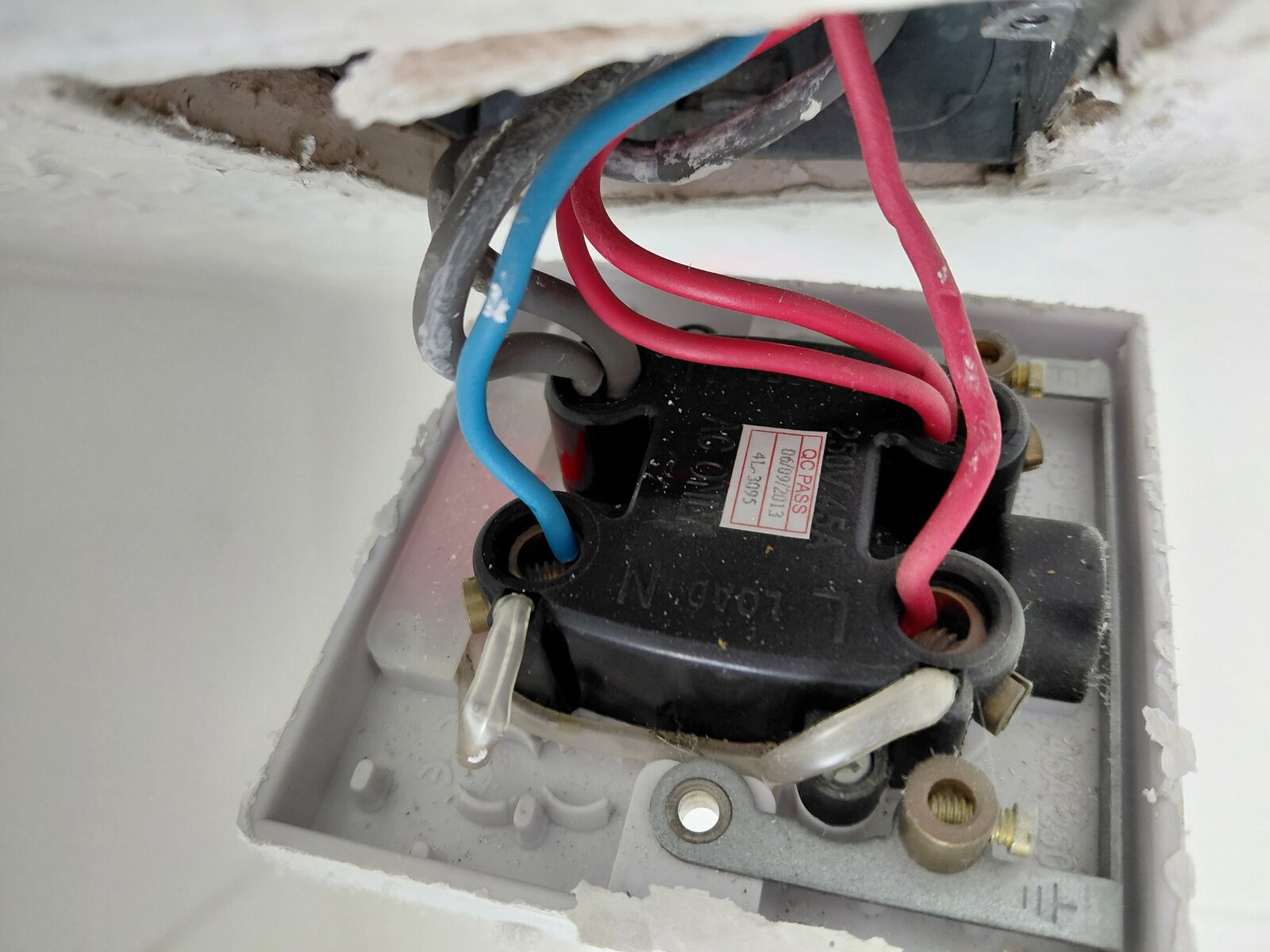

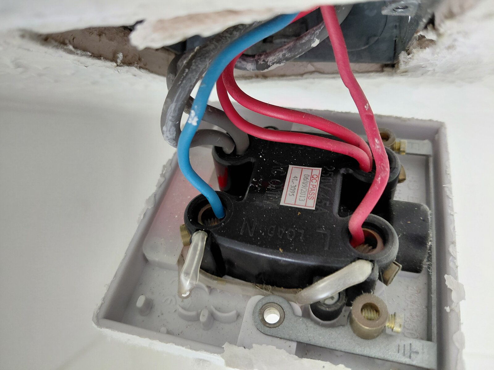

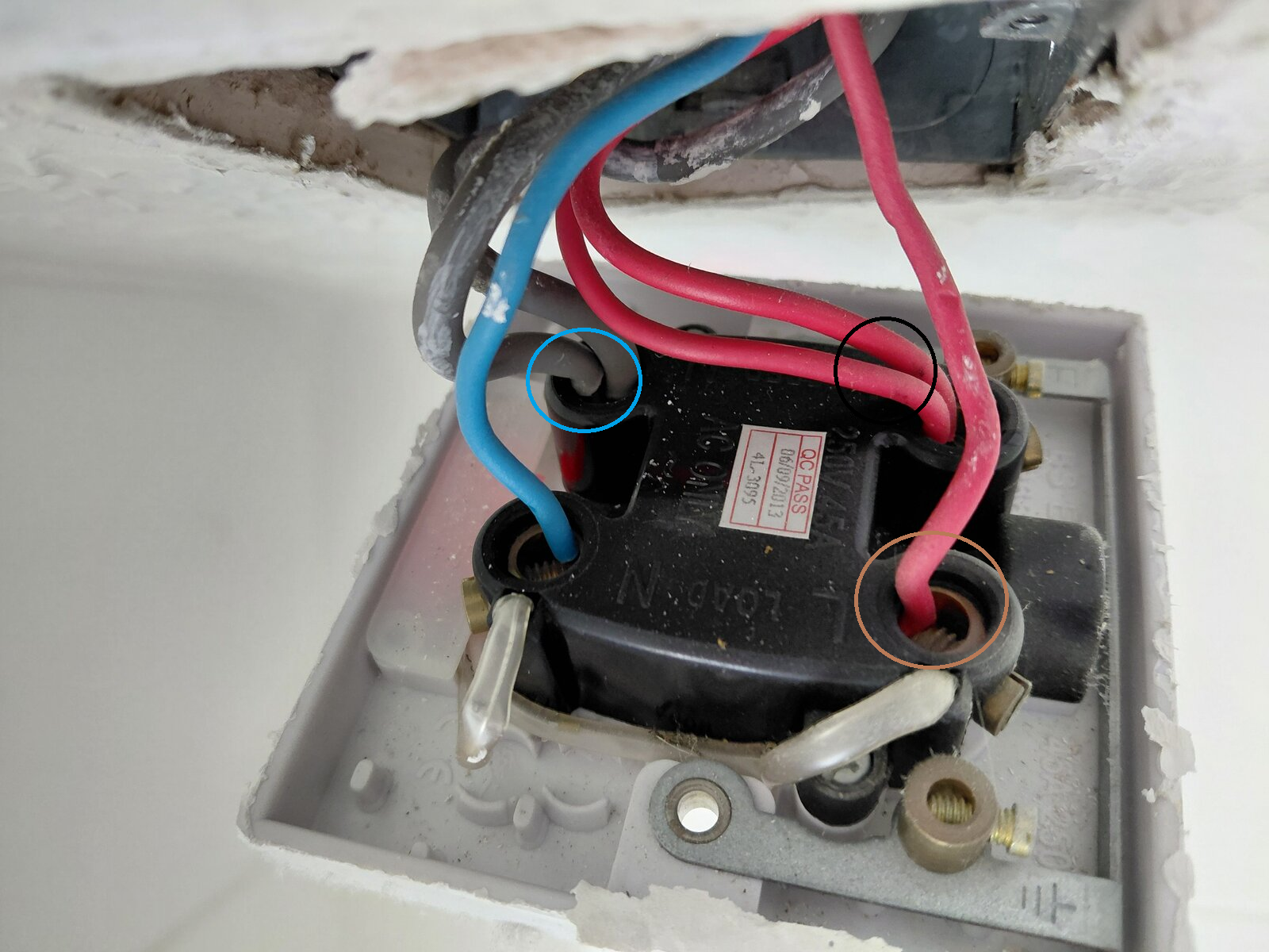

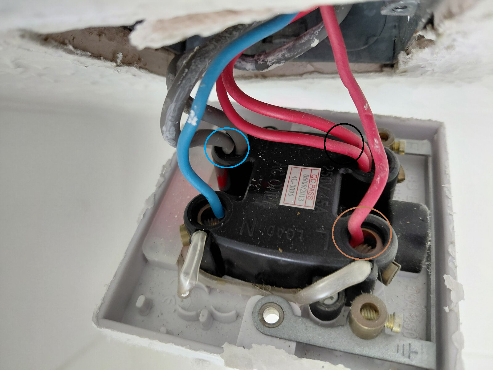

Good day folks, I hope you can help me with a query. I have purchased an AirTech-UK bathroom extractor fan kit with LED light and adjustable timer. The previous extractor fan was fed from a shower pull cord switch and I want to connect the new extractor to it. The fan comes with a pre-wired 3-core feed cable = Blue (N), Black (L - Constant Active) and Brown (LT - Switch Active Trigger). The pull cord was previously wired as shown in the photo below. I assume the blue on the 3-core goes to the Neutral and the Black to the Live terminal, but where should I terminate the brown? Thank you.
