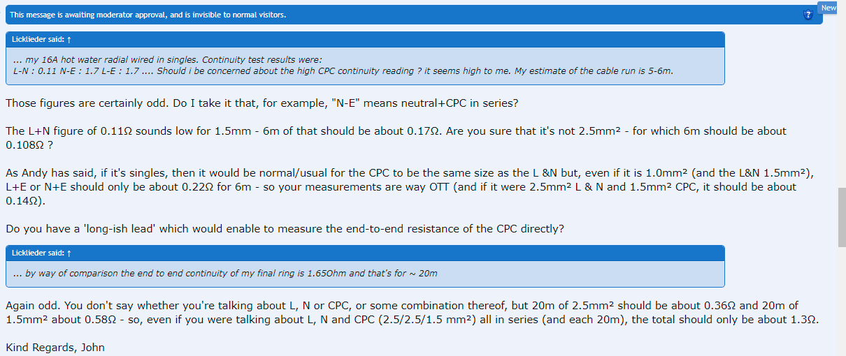

... my 16A hot water radial wired in singles. Continuity test results were:
L-N : 0.11 N-E : 1.7 L-E : 1.7 .... Should i be concerned about the high CPC continuity reading ? it seems high to me. My estimate of the cable run is 5-6m.
Those figures are certainly odd. Do I take it that, for example, "N-E" means neutral+CPC in series?
The L+N figure of 0.11Ω sounds low for 1.5mm - 6m of that should be about 0.17Ω. Are you sure that it's not 2.5mm² - for which 6m should be about 0.108Ω ?
As Andy has said, if it's singles, then it would be normal/usual for the CPC to be the same size as the L &N but, even if it is 1.0mm² (and the L&N 1.5mm²), L+E or N+E should only be about 0.22Ω for 6m - so your measurements are way OTT (and if it were 2.5mm² L & N and 1.5mm² CPC, it should be about 0.14Ω).
Do you have a 'long-ish lead' which would enable to measure the end-to-end resistance of the CPC directly?
... by way of comparison the end to end continuity of my final ring is 1.65Ohm and that's for ~ 20m
Again odd. You don't say whether you're talking about L, N or CPC, or some combination thereof, but 20m of 2.5mm² should be about 0.36Ω and 20m of 1.5mm² about 0.58Ω - so, even if you were talking about L, N and CPC (2.5/2.5/1.5 mm²) all in series (and each 20m), the total should only be about 1.3Ω.
Kind Regards, John

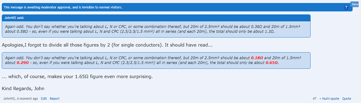

Apologies,I forgot to divide all those figures by 2 (for single conductors). It should have read...
Again odd. You don't say whether you're talking about L, N or CPC, or some combination thereof, but 20m of 2.5mm² should be about 0.18Ω and 20m of 1.5mm² about 0.29Ω - so, even if you were talking about L, N and CPC (2.5/2.5/1.5 mm²) all in series (and each 20m), the total should only be about 0.65Ω.
... which, of course, makes your 1.65Ω figure even more surprising.
Kind Regards, John
