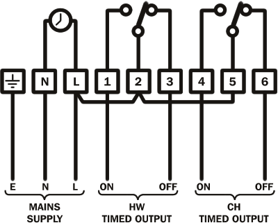

Hello Folks,
Im after some advice from some of you knowledgeable heating engineers.
I own a holiday home and its heated via an OIl Fired Grant Boiler.
The heating is split into TWO ZONES for upstairs and downstairs and also HOT Water.
This is done through a HORSTMANN Channel Plus H37XL programmer, see picture below, at the moment but if I plan to fit a NEST Gen 3 I believe I can get rid of the programmer altogether, is that correct?
Question: How does the wiring from the programmer shown below equate to the NEST Heatlink wiring, is it fairly straightforward? Note: I have already fitted a NEST 3 in my own Gas boiler without any problem and that was only for the heating, ie ON/OFF the hot water is still controlled via the boiler.
Question 2.: Would I get adequate control of my hot water from the NEST or would I be better to leave the programmer in situ and just control it from there but have the heating wired into the NEST?
The holiday home was wired by an electrical company on build so I haven't seen the wiring configuration.
Thanks for any advice/assistance much obliged.

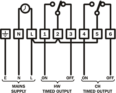

Hello again,
Ive just found a wiring diagram for the HORSTMANN H37XL Programmer, will this equate directly across to the NEST Gen 3 heatlink wiring??
Alex

can a DIYer fit the Honeywell Evohome?
If you're struggling to understand the wiring diagram for your existing programmer, the answer is probably no. Sorry. Installing Evohome is step above bunging a Nest on the wall.
Get a personal recommendation from Dan (if he's not close to you) or Richard at The Evohome Shop and they'll put you in touch with the right person for the job.
