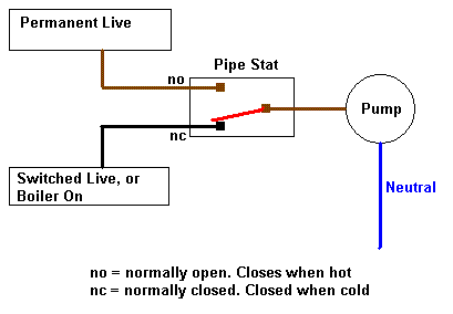

Thought, can you wire or programme the pumps to continue operating for say half an hour AFTER the boiler has finished its heating programme in order to disapate the latent heat in the system via the radiators OR is there some other solution?

If you want to add a pump overrun all you need is a pipe stat:
