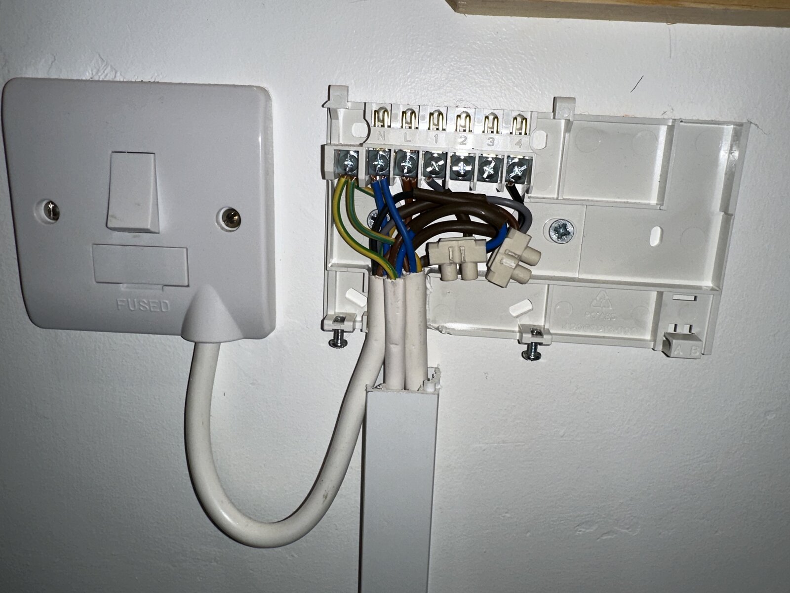

Hi guys
I’m trying to install Hive on Combi oil boiler
Am l right to think that l just need to remove the current thermostat controller?
What would the cabling diagram be after removing the current thermostat?
Hard to tell exactly, but yes, sounds feasible. Looks like existing has a permanent live and permanent neutral, common and heating on, which is what you’d need for a Hive single channel receiver.
The same back plate is used for thermostats, programmers, and combination thermostat/programmer. The norm is to look on the back of the item removed there is normally a diagram. Many oil combi boilers are really a boiler with a reservoir inside the boiler for the hot water, as hard to make an oil boiler modulate.
The wire on 1 and 4 with 2 and 3 unused seems odd, so would want to see diagram on back of existing unit.

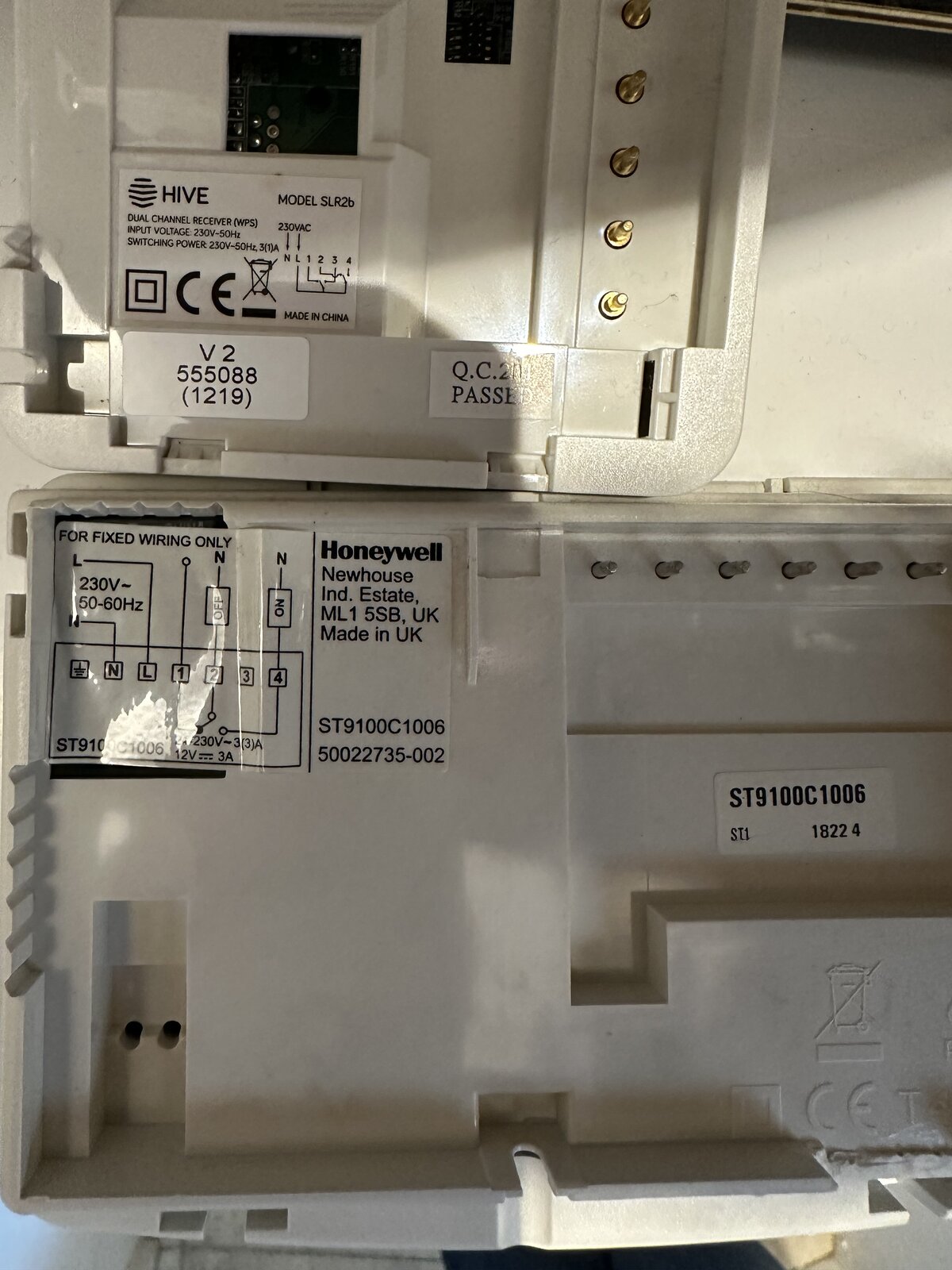

Here is picture of the diagram on back if the existing unit
We have dual channel hive receiver

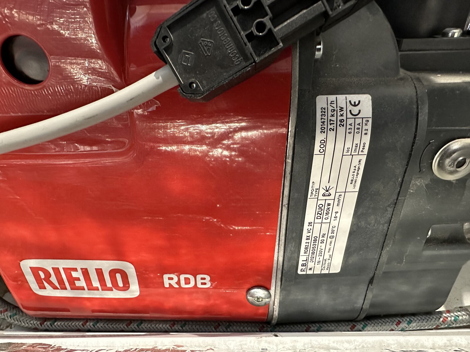

Which model Grant combi?
Some require a permanent live (we are Grant
G1 registered installers)

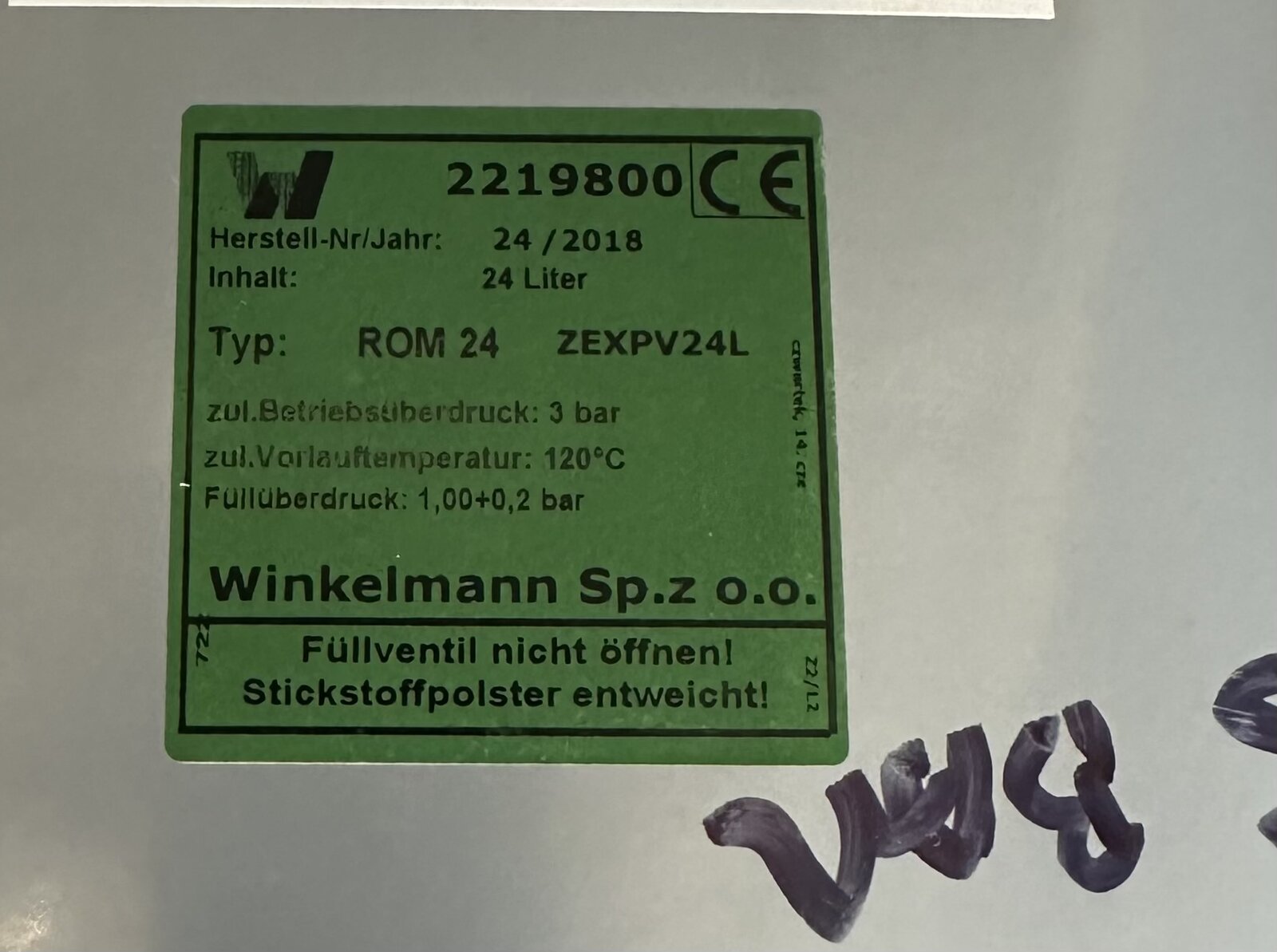

Internal combi boiler
Unfortunately neither of those pics are of the data plate
Is your boiler a vortex pro? Approximately how old? there are a number of variants.
Not sure why you've bought a Hive dual channel channel to replace a single channel? I think you need to safely to terminate the common on existing (1) and then transfer the wires over copying the same layout. What you also need to do is decommission the existing thermostat if you have one link the wires or turn it up to maximum and let the hive take over
