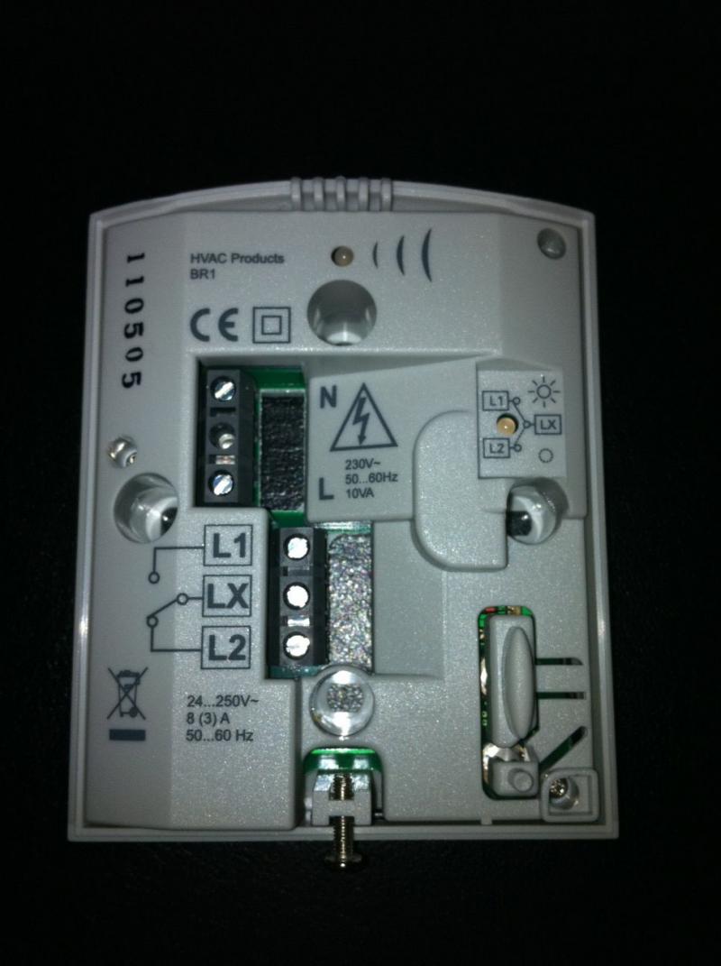

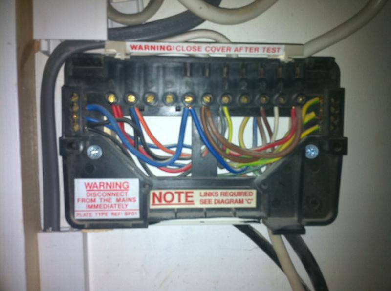

Hi all,
my 1st post here! I have searched all over the net and can really find an answer to my quest!
I have a Potterton Netaheat Profile 40e boiler, controlled by a Potterton Ep2001 timer.
I currently do not have a room thermostat in my house. But would like one fitted to my living room.
I have seen youtube video showing how to wire up a wireless thermostat to "a" boiler. Im pretty good with electrics so im pretty sure I can install one.
The problem Im having is, can a room thermostat be fitted to my Potterton netaheat profile 40e?
I basically need to know where the wires go as I don't have a wiring diagram for my specific boiler?
Also if I have a thermostat fitted, what do I do with the original timer controls? Keep them in place and have them set to constant and let the thermostat control it?
Matt[/b]
I have just found the Potterton EP2001 timer manual. I have a fully pumped heating/water system. So I believe that would be diagram H on page 3 of the manual?
My timer control diagram
http://www.gtts.co.uk/EP2001/PottertonEP2001InstallerGuide.pdf
Wireless receiver diagram
http://www.free-instruction-manuals.com/pdf/p4766387.pdf
What wires from the wireless receiver would I tap into on the timer or the boiler?
my timer panel opened.
My thermostat opened.
