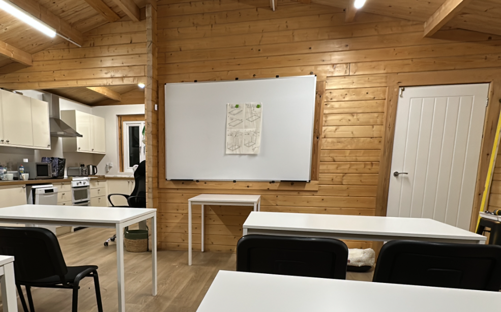

I am repurposing a log cabin building, it was originally built with this large opening in one of the internal walls:
In the new use, a large whiteboard has been added:
But obviously this is terrible for noise between the two rooms. I want a low-effort way to insulate the hole in the wall - it is 75mm thick timber so my thoughts are to use some sort of non-glass insulation roll (50/100mm), but then I came across low cost acoustic panels about 25mm thick for the same price per square m. I know neither will be perfect but I don't want to sound-proof, just provide some basic benefit.

yeah makes sense, I don't want to surface mount anything I just want to fill in the 'cavity' - there might well end up another white-board on the other side
Couple of layers of plasterboard in the hole. It's not great as it is.
Is there any insulation in the other internal walls?
I’d go for rockwool in the cavity, and plasterboard /timber over the faces.
Double up on the plasterboard if you can and use a mastic or similar to seal joins.

All the walls are solid 75mm timber. To clarify I don't want a sound-proofed room, I just want it to be as acoustically insulated as if there wasn't a massive hole in the wall. So it seems like regular insulation wool (non-glass) sandwiched as you and others have said is the obvious answer.
I did wonder about the door, there aren't big gaps anywhere but it is pretty thin. I'm open to replace it if that ends up being a problem but figured on doing the obvious thing first and then re-evaluating to see.
Thanks :)
Either a fire door or make one out of 2x2 frame covered in thick ply filled with plasterboard.
