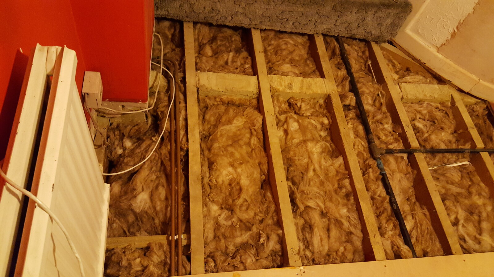

As I have all the ceiling void exposed. before closing down i would like to stick some insulation between the joist. What would be the most cost effective option? Not looking for crazy expensive stuff considering the large quantity but something that still will work at considerable price.

As Benny touches on, what is the insulation for? Generally your upstairs and downstairs will be the same temperature so the insulation won't be doing much temperature control.
Sound insulation is a different matter. It should help reduce noise transfer and imo is well worth the time and effort. There you probably want to go for the specialist acoustic insulation slabs, but they're pricey and bog standard loft roll will do something at least.
Could cause issues with the electrics as you could be derating cables.
when cables are surrounded by insulation, the heat generated by the current they carry cannot escape, and they can overheat which (at least) shortens the life of the PVC insulation. This is particularly important with the cables to electric showers and immersion heaters which will be carrying sustained heavy loads. Lighting cables in a house have very low loads.

Loft insulation is cheap and gives good heat insulation. Because it is very light it muffles sound a little, but heavier insulation is better. You can get slabs of mineral wool as used in cavity walls fairly cheaply, or purpose-made sound insulation quilt which will be dearer. mineral fibre teated with Ecose does not shed irritant dust and fibre like the old yellow fibreglass (it is brown, and widely sold as an own-brand or as Knauf, you will see the "Ecose" name on the packaging).
If you squash loft fibre tightly around the perimeter of the room, it will block draughts which usually come from gappy brickwork and the holes that joists are built into, and rise up under the shorting and though gaps in floorboards.
mineral fibre does not damage cables as plastic foam can, and does not burn or create poisonous fumes in a fire, as plastic foam does. Since Grenfell I would not have plastic foam in my house.
here's one I did earlier:

Any insulation derates cables, probably won't be an issue but worth considering.
I`m aware about that and was taking into account to buy fire rated downlight and if possible use the cover cap or push. insulation away from the floor board above
Got 175mm joist and cable usually run in the middle. Using 100mm insulation these will cover up or stay below cable.

On the cables, as long as they're not surrounded by the insulation you'll be ok. lf you use 100mm slabs it'd be best to move the wires a bit higher on the joists if needed so they're visible and clear. Both for derating and so you can find them in two years.
