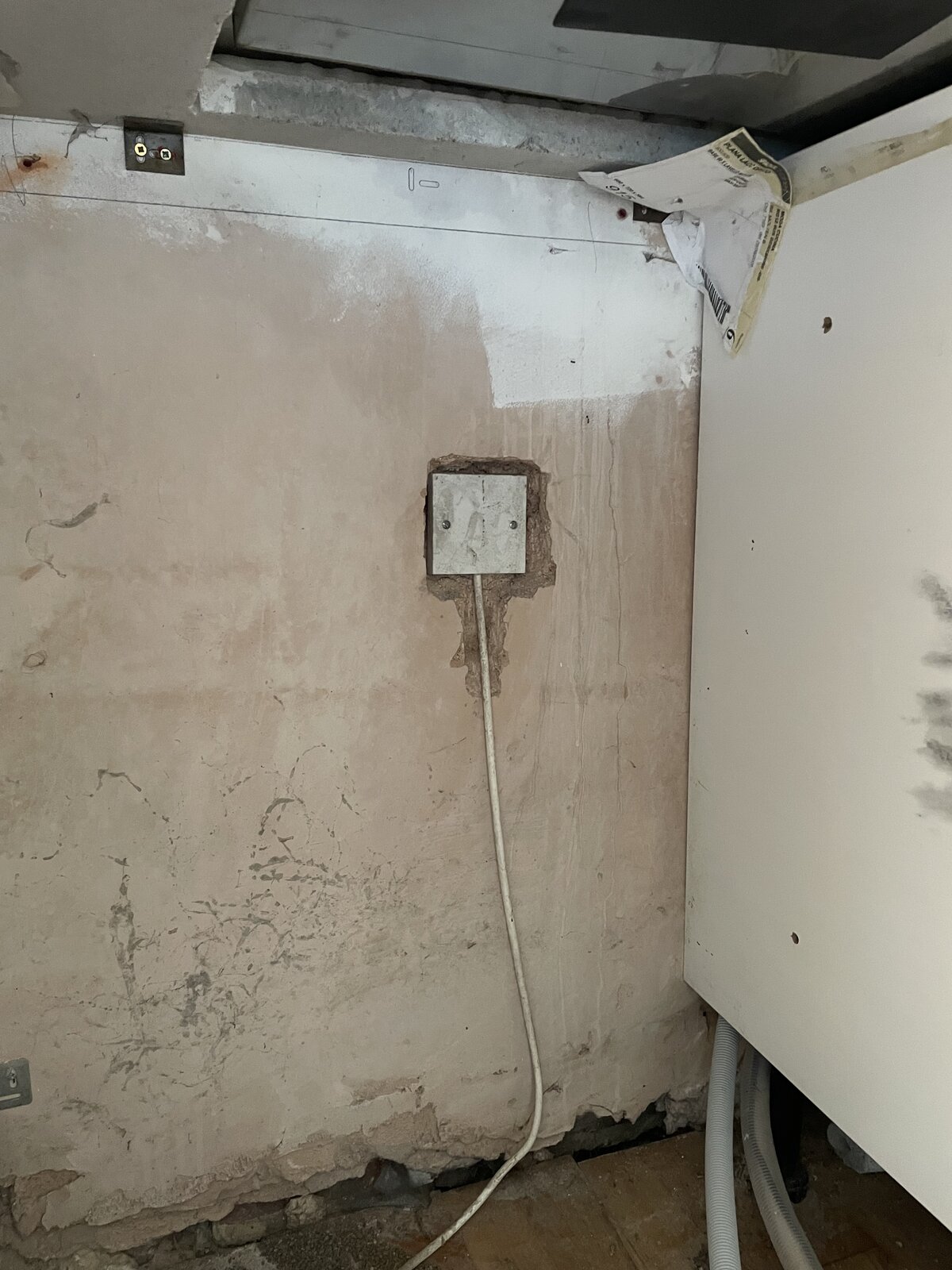

One question though. My old integrated one was hard wired. I’m assuming it would be the case of removing the plug and wiring up the old connection. An electrician would do this though pretty sure with power off I could do it!

If there's a above counter fused isolator switch for the dishwasher then you could look to replace a cord outlet plate behind the machine with a 13A socket rather than hard wire it; depending on the gap available.
My integrated dishwasher has a socket in the adjacent cupboard and a fused isolater above the worktop.
Why was it "hard wired"?
Edit, if you can wire a plug, you should be OK (wiring in to a fused supply unit is probably easier than wiring a plug). Just make sure that the power is off when doing the work.
you can change your existing connection to a socket. but try not to put the socket directly behind the washer as the thickness of the plug will make it stick out. Where, and what sort, is your existing power switch?

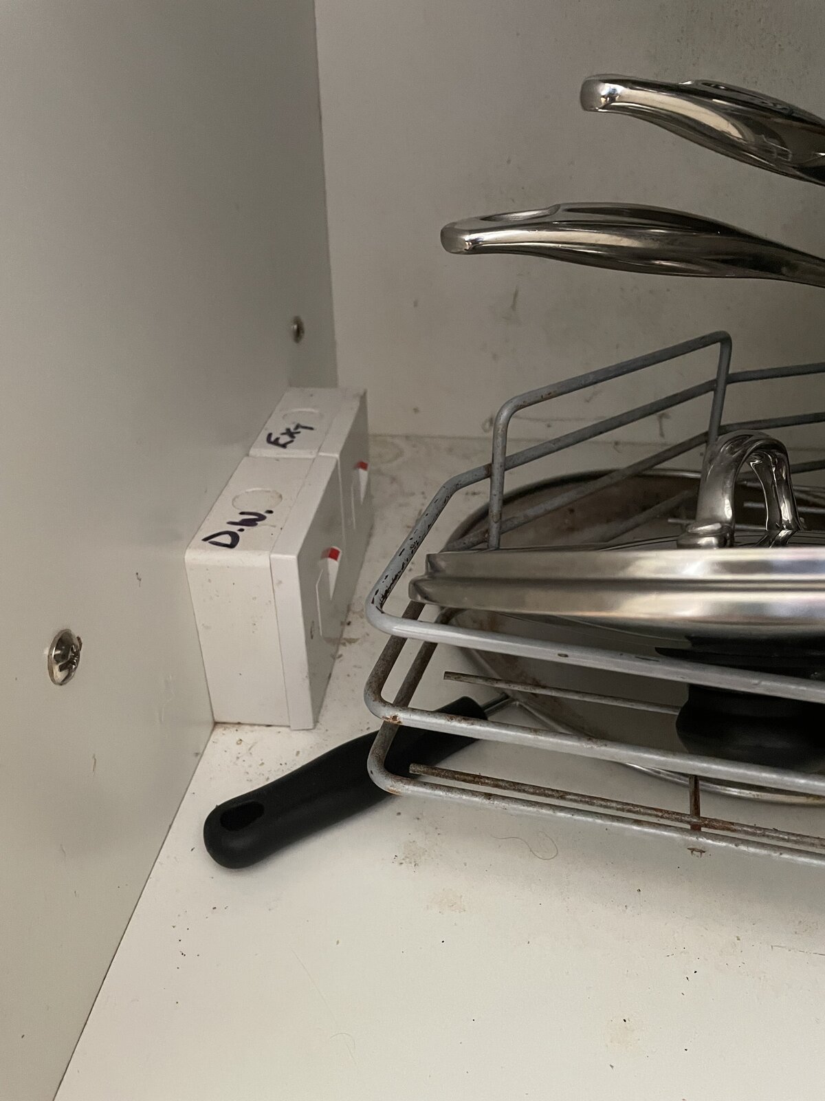

The dishwasher is to the left of the sink but annnoying the electrics are in the unit to the right of the sink with an isolator switch. Think it would be too fiddly to replace with a plug there and definitely not possible to fit a plug behind.

Actually I was wrong- half wrong as it is hard wired but there might be sufficient space to fit a plug at the back. I think that I’m better off using the existing wiring and it also means I can shut it off at the isolator rather than having to pull out each time.

All the integrated appliances ( only washers and driers, fridges and freezers) I have ever seen have come with a plug, even in the past 30 odd years. You usually have to cut off the plug if you want to connect to an fcu. I would guess someone could not get yours to go far enough back with a plug and socket. Some electricians used to instal an an isolator above the work top which then fed a connection unit or an fcu.
All the integrated appliances ( only washers and driers, fridges and freezers) I have ever seen have come with a plug, even in the past 30 odd years. You usually have to cut off the plug if you want to connect to an fcu. I would guess someone could not get yours to go far enough back with a plug and socket. Some electricians used to instal an ansolator above the work top which then fed a connection unit or an fcu.
I think that’s what I have. All the kitchen had to be required- now I have the isolator switch on a cabinet.
