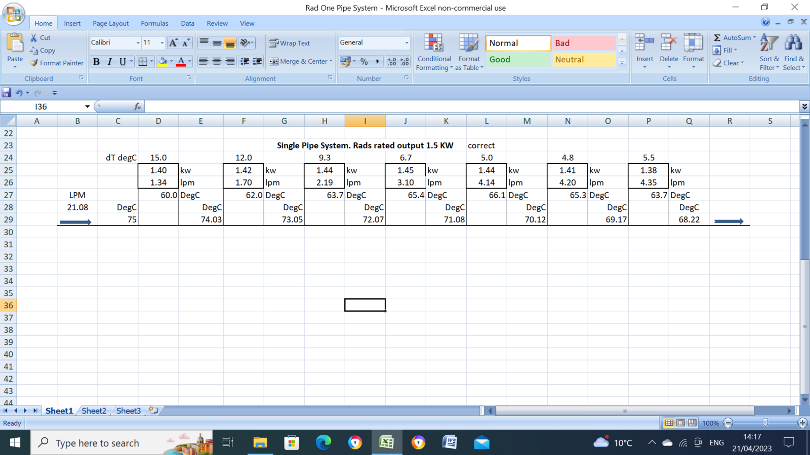

Thank you - No matter how well flushed and filter installed it will always have debris from radiator rust - One other point was whether a one pipe system would have too large flow return differential and therefore trip faults all the time. Do you expect that to happen ?
If yes am I advised to buy a cheap heat only boiler (Baxi main) which has less sensors or is it no different on the cheap ones
I don't think a one pipe system would have a very high flow/return dT except all the rads are in series with each other, this is the way I would have thought they might look like but maybe this isnt a true one pipe system.
Wow thank you so much! I have massive 2 inch pipework and 17 radiators so i expect the diff to be massive by the time it returns to the boiler
Technical team in Viessman told me this might well be a problem and the boiler will always trip up which is why I posed this question
Do the cheaper boilers measure flow return diff and therefore encouraged to buy in my cirumstances?
