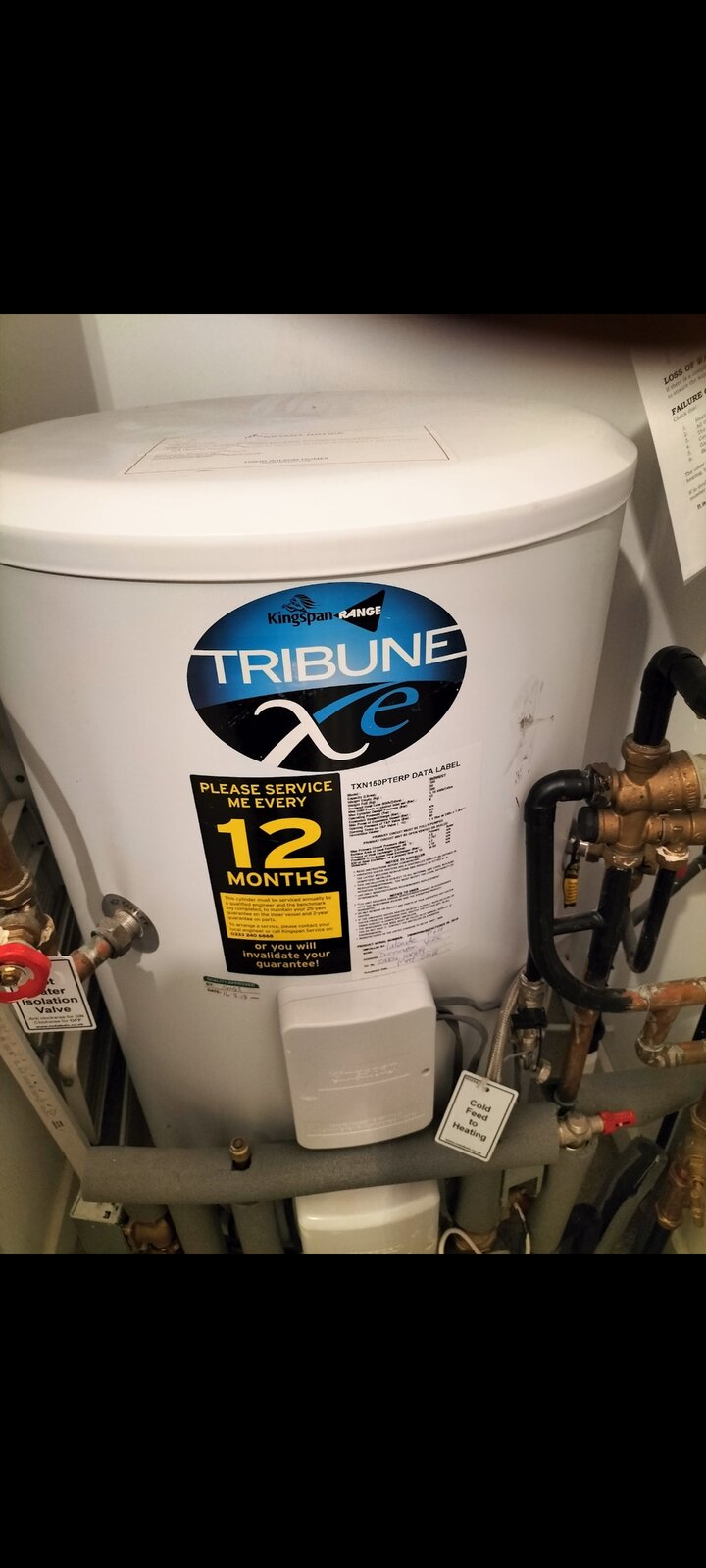

Got a pressure relief dripping on an internal bubble hot water cylinder. To recharge the bubble it's close the cold fill to cylinder. Open a hot tap and run till it stops and open pressure relief and refill?
Thanks it's one of these.

I've found the instructions, how long should you leave the immersion/boiler off before draining?
Step 2 in the instructions of the manual applies, surely? :unsure:
Step 1: Turn off the boiler and immersion heaters to the cylinder.
Step 2: Allow the water to cool through your normal usage. Alternatively run off all the hot water by opening the lowest hot tap in the property until the water runs cold. Once complete turn the tap off.

Thanks so there suggesting turn boiler off/immersion and run hot tap till water cools?

Presume it states this as its very important, that you also open the cylinder T&PRV when the hot water has finished draining and leave it open until water stops coming out of it, if any, then reshut it.
I'm not too sure if its necessary to let the cylinder cool down before recharging the bubble, I've recharged a neighbours Megaflo a few times without letting the cylinder cool down and the bubble lasts ~ 10 to 12 months.
Thanks. Once isolated and running the lowest hot tap. It should stop pretty soonish?
In essence then by opening the tprv water is only getting drained from the cylinder to this point

Indeed they are. But many people would skip that step 2.
With the T&P valve open (45 degree twist) you should hear 'gurgling' that will be fast at start and then slow -- gurgling and water flowing out should stop eventually. Will take some time as the air gets in via the T&P valve to the cylinder in the main.
The air bubble is above that T&P valve --- closing it sooner than water stopped completely just means a slightly smaller bubble I think.
My OSO instructions are different and reference using a 'commissioning valve' lower in the tank. But that involves a hosepipe and a dreadful leak everywhere draincock valve. So I shortcut using the T&P valve only.
Yes, but if the expansion relief valve has lifted then there could be up to 40L of water (assuming a 200L UVC) still above the T&PRV when the water stops running out of the hot tap as the bottom of the dip tube extends down to ~ 25% of the cyl height/vol. so could take a pretty long time to drain off through the T&PRV.
