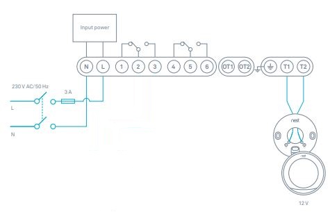

The Nest Heat link part requires 230V mains supply to power it connecting to N and L on the left.
The Nest thermostat requires 12v to power it this can come from a USB adaptor, or by wiring it to special 12v terminals inside the Heat link. (T1 & T2) on the right
The actual switching contacts (Terminals 1 to 6) are voltage free, so can switch whatever voltage is applied to them 230V and 24v are the most common, which may vary depending upon your system. Some systems the thermostat is wired to the boiler and the boiler provides the control voltage (eg 230V or 24). Other systems have motorised valves which are 230V.

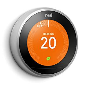

There are two sorts of Nest you can use here, the most common is the 3rd Gen that has a separate thermostat and Heat link that I gave details off, and as in the Screwfix link you posted. The other version suitable for the UK is a battery operated e-Nest, but this doesn't provide hot water control.

The Nest thermostat
Then communicates wirelessly with the Heat link. The thermostat can be powered via a plug in power supply or connected to the Heat link, whichever is easier.

The Heat link
1-jpg.178432
Contains two simple switches inside, one for the central heating and one for the hot water.

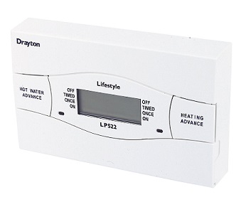

The programmer, hopefully something similar to this...
.....also contains two simple switches inside for the central heating and hot water, exactly the same. So, the programmer is removed and the wires removed from its terminals go to the terminals of the Heat link that have exactly the same function. No additional wires will be required, only what is already there will be needed. [Assuming your existing system is wired and working correctly]
If you don't want to have the Heat link where the programmer is, it can be located somewhere else, but it then becomes quite a major wiring job, not just a simple exchange of one item for another.
The old existing room thermostat needs to be decommissioned to stop it interfering with the Nest. This is done by tracing the existing thermostat cable back to its origin, disconnecting it and then inserting a wire to bridge the terminals where the two live wires that went to the thermostat have just been disconnected from. [If that's too difficult, the old thermostat can be left where it is and set to its maximum setting]
Finally the Nest thermostat requires 12v to power it. It can get this by being wired to the Heat link, (terminals T1 & T2 are provided specifically for this purpose) or by using a separate plug in power supply for it.
