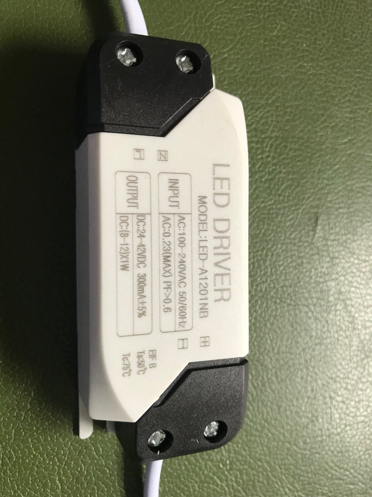

I have installed a 3rd generation Nest thermostat with requires a 12 volt supply normally taken from the Nest Heat Link. In my installation that option is not possible so my question is: can I used this LED driver to transform my 240 volts into the 12 volt required by the thermostat? (see pic)
No that driver is fixed current it will not work. However it seems the remote thermostat can be also powered from a USB or a battery, although it seems latter does not last that long. So it would seem there is a large latitude in the supply volts from 5 to 12 volt. I have looked many times at how to use USB to power Nest and it seems there is no real option but have a local USB outlet.
