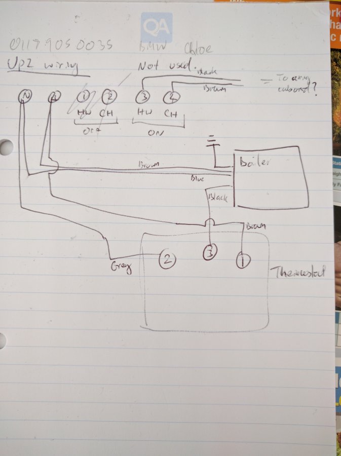

Hi guys, I know there are several Nest posts on here, but couldn't find the answer to my question.
Replacing my UP2 programmer with a Nest 3rd gen looks fairly simple, except one thing. There are three wires to the current Honeywell thermostat, Live, Neutral and one that goes to the boiler. I can't figure out from the Nest wiring diagrams where this wire should go in the Nest programmer. Is it required at all with the Nest system?
If I can find the answer to this one question I'll save myself £50 on installation!
Many thanks in advance guys.
Adam.

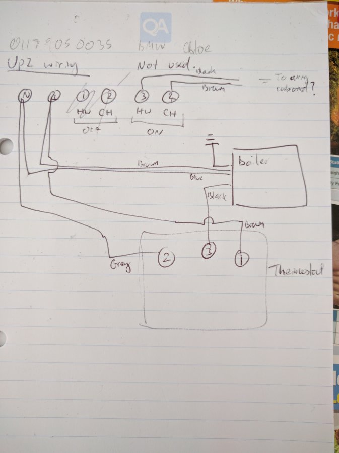

Here's a pic of the wiring diagram I drew. Top right says 'to airing cupboard'.

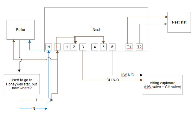

Hi guys,
I went quiet as I didn't end up buying a Nest... until now!
I have connected L to 2 and 5 in the Nest for power to both CH and HW parts.
I have connected the wire that used to go to my UP2 programmer port 3 (HW on) to 6 on the Nest (HW normally open).
I have connected the wire that used to go to my UP2 programmer port 4 (CH on) to 3 on the Nest (CH normally open).
I don't know what to do with the wire that used to go to the Honeywell thermostat from the boiler (hertsboilers, I note you say this should be connected to 3 on the Nest, but then where does the one I currently have in 3 go to?)
The current situation:
Ask Nest to turn on the heating - nothing happens.
Ask Nest to turn on the hot water - the boiler fires up, but there's no water circulation! The boiler gets hot but the HW tank doesn't.
I am very confused - this should be quite simple in theory! (although given I have a spare wire I'm not surprised it isn't working).
I wonder if someone would be kind enough to review my setup and provide advice, please? Many thanks!!

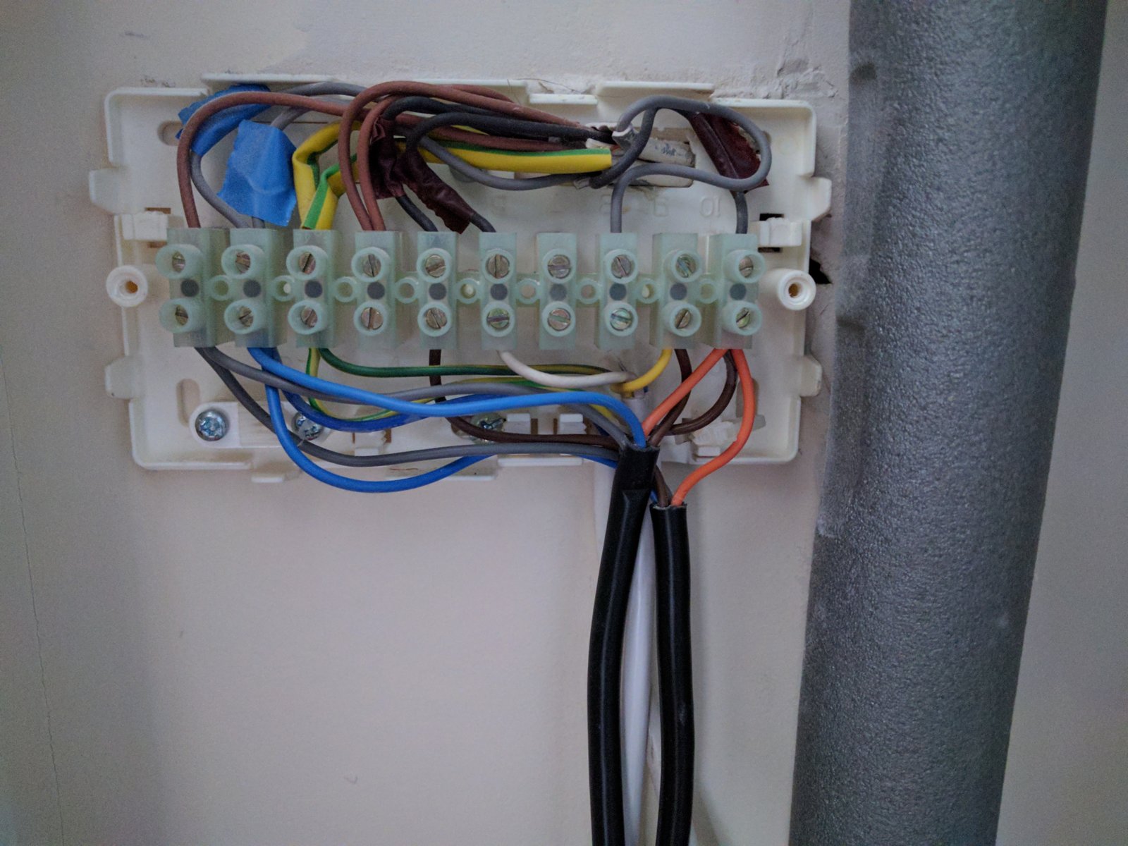

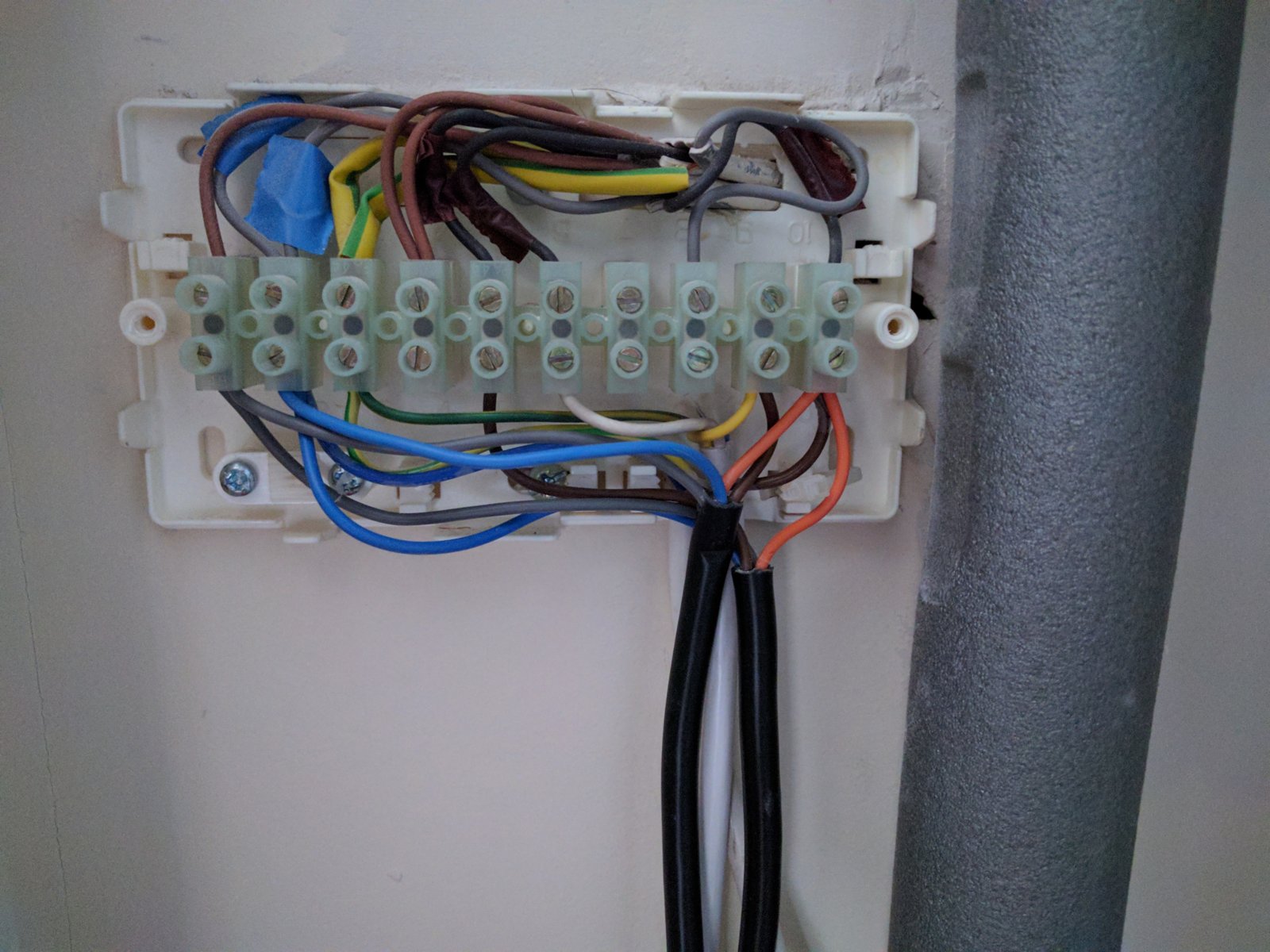

What motorised valves do you have?
Can you put up a pic of main wiring centre that the motorised valves are wired to
And also boiler make/model and pic of wiring inside boiler if can do safety without compromising safety, i.e. Opening wiring area without disturbing any combustion seals etc
Thanks for your reply McCombi!
Here's the block the two valves, water pump and tank thermometer are wired into - more complicated than I thought!

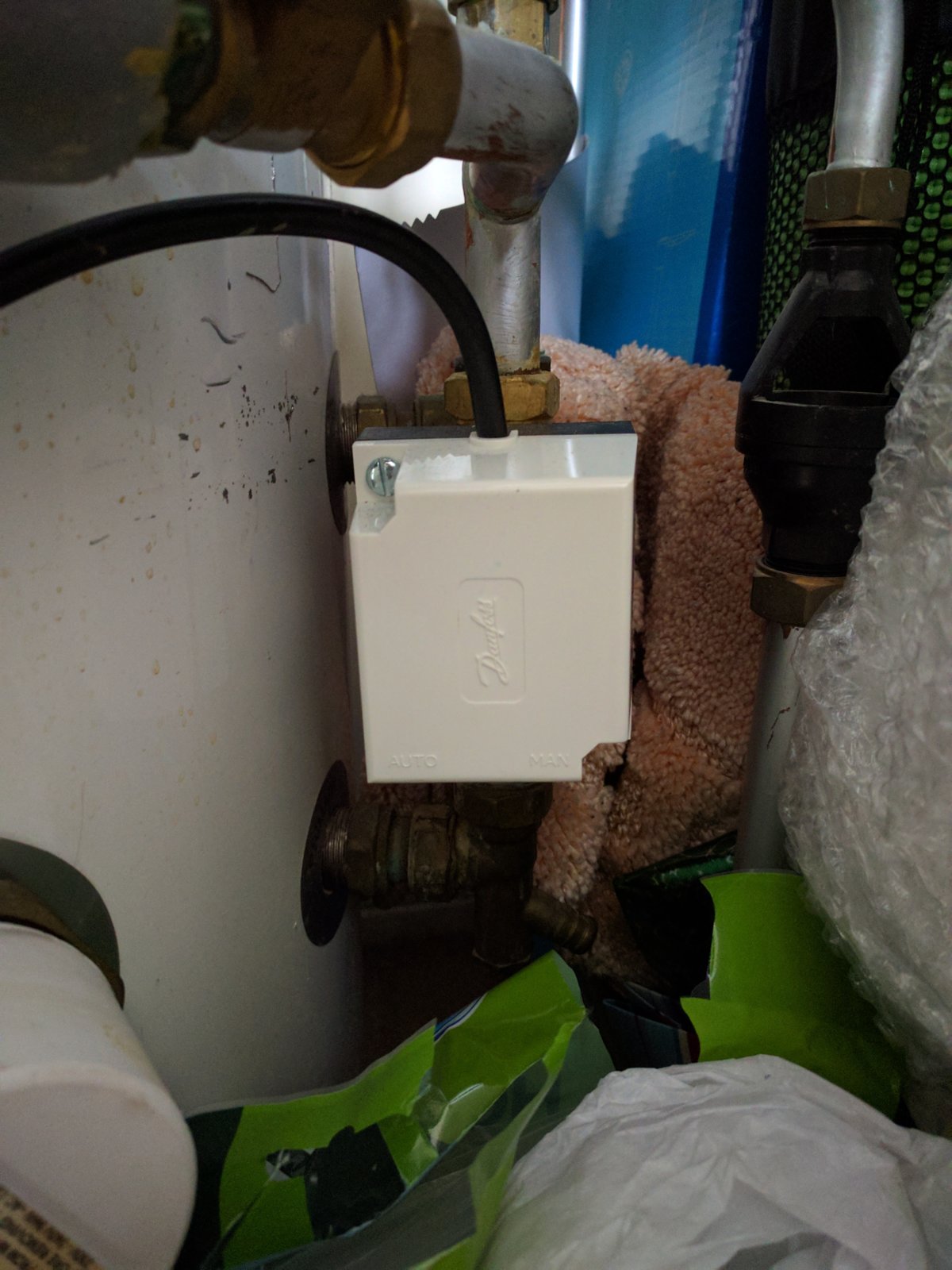

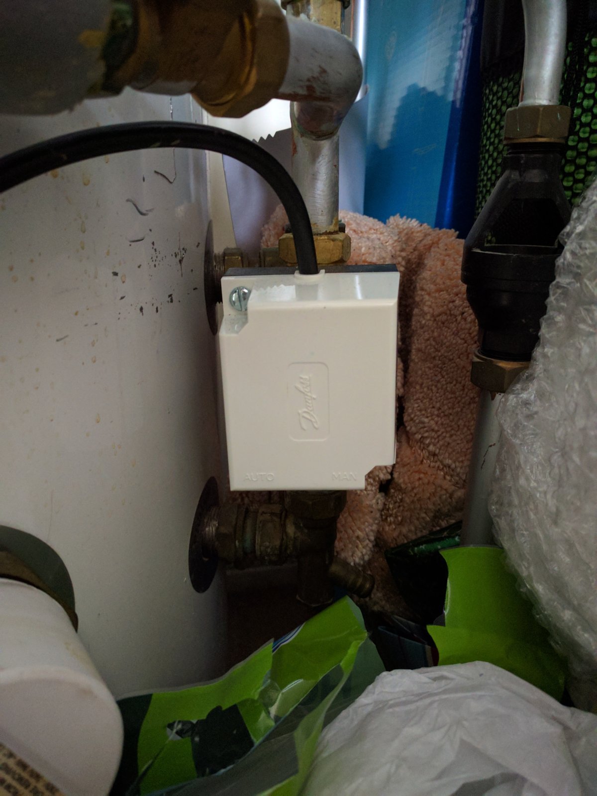

And here's one of the two valves (Danfoss HPA2)

It's difficult without seeing it, but couple of things to note going by your prev posts.
The wire from boiler you said went to stat prev, are you sure?
As the boiler has a permanent L N E, should have a pump live connected to it also and also needs a switch live to fire boiler when demand created. This wire will be coming from the terminal in main wiring centre that have the orange wires coming from both of the danfoss 2 port motorised valves (white square boxes in pics)
The permanent live in heatlink should be linked to no 2 and no 5 as you have done, then wiring goes as follows.
No 3 (call for heat) should be wired to the brown wire of the central heating 2 port valve (this makes the motor turn in 2 port, opens valve and makes a switch inside the white box which sends power back to boiler switch live via orange wire)
No 5 call for hot water should be wired to/sends voltage to cylinder thermostat common, if cylinder is asking for heat i.e. Thermostat not satisfied, it then sends voltage back down to wiring centre to connect with brown of hot water 2 port valve (white box in pic on the pipes going to cylinder, thus making motor turn, opening waterways and making switch in valve to send power back to boiler to turn on via switch live orange wire.

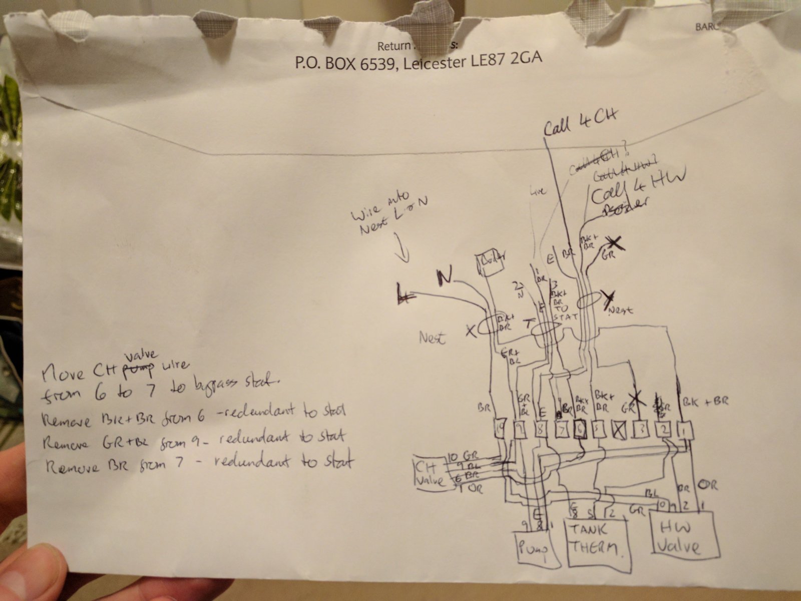

McCombi, you legend! When I read what you put in the quote above I thought "yeah, of course, oh, erm, hmm, am I sure, perhaps I got it wrong?..." Then I did what I should've done initially and traced all the wires from the connection box pictured above and found things were a lot different. The result was the spider diagram below...
Then, after looking up how my HPA2 valves are wired I eventually managed to figure out how the whole system is wired up, which then allowed me to figure out how to power the system, bypass the old thermostat and wire in the Nest.
The result: IT WORKS!!
The moral of the story is to not assume you know where all the wires go without checking - thankfully I didn't break anything, or anyone :)
