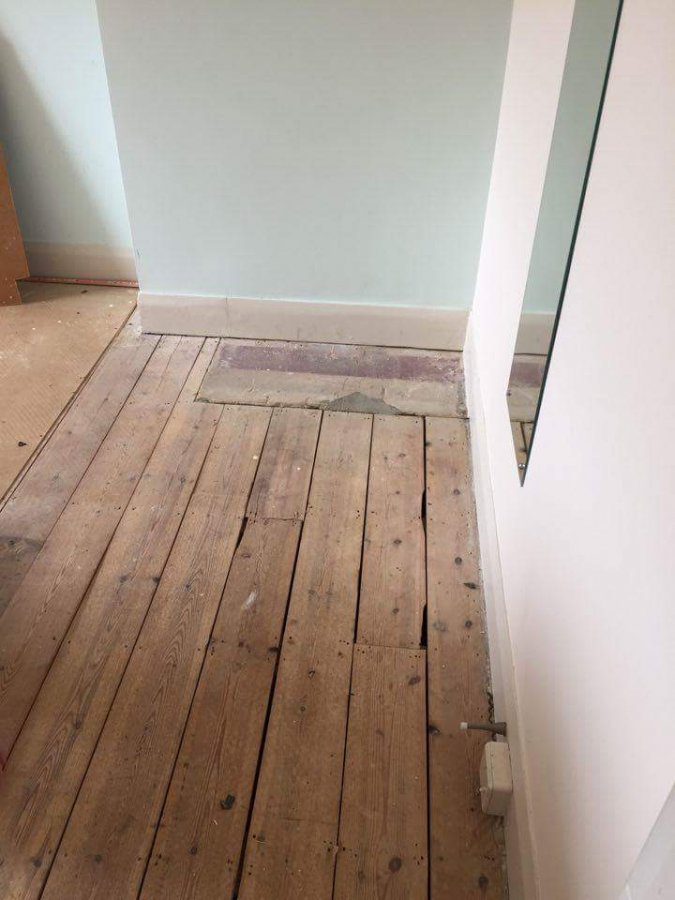

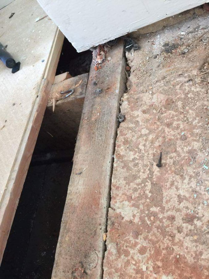

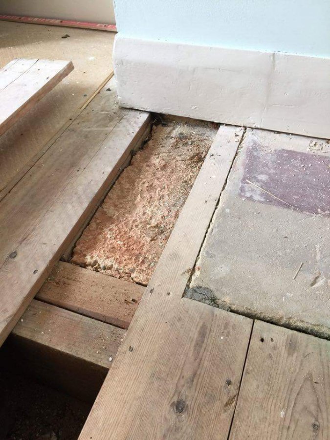

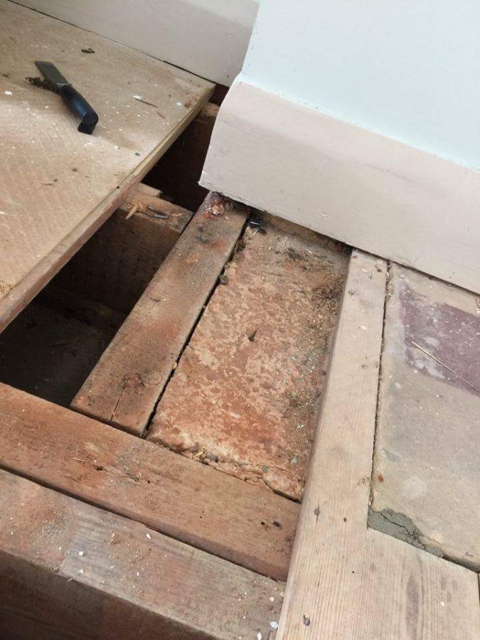

Hi there everyone,
First house....... and survey said when left hand side of ground floor chimney removed potentially not supported.
The survey was pre purchase and we then got a structural survey that said no evidence of steel support found and further inspection needed.
Lifted board on first floor yesterday.
Could anyone advise if it appears supported?
If not I feel a big bill coming on!

A photo of the ground floor chimney breast remnants would help. Stand back to give a larger view photo.
Your first three photos show trimming joists and a concrete consructional hearth in the first floor c/breast area - no steel support is shown.
Is the wall with a mirror in photo 4 a partition splitting the bedroom? Does the chimney breast appear on either side of the wall?
Whats above the first floor?
Does the chimney breast proceed up to a stack above the roofline?
All flues must be vented top and bottom and should have been swept (rarely done) before blocking up.
FWIW: the floor boards in photo 4 are loose looking, & the outlet on the skirting should be removed to a higher, safer position.
