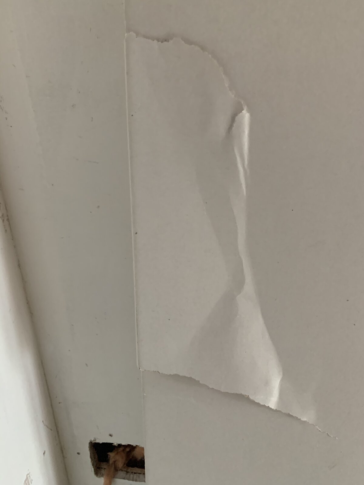

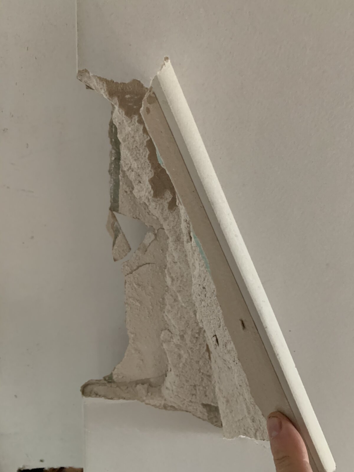

2400 x 1200 but one area is damaged as per photo.
can I still use this or should I just get another new sheet?

it’s a new panel I’m using to overboard some existing. It will be skimmed
take the loose out , neat pva the damaged area fill it out with plaster then pva that area again before skimming.
or cut it out
