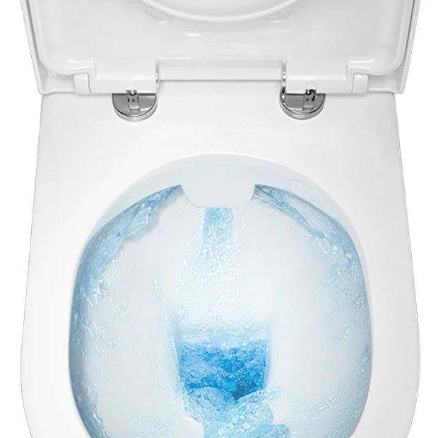

Out of curiosity - what is a rimless toilet? On the web it doesn't look any different from a traditional one, apart from modern styling.
It doesn't have a overhanging flush rim all around the inside of the pan where normally it's a moulded section with holes/a rail to carry the flush water all around the pan, it only has a diverter piece at the back of the pan.
They say they are meant to be more hygienic but the 3 I've seen don't flush the whole pan, it misses some of the top/front section and TBH normal rimmed toilets just need cleaned properly :unsure:
OK thanks. That looks more convincing. The one I found, below, described as rimless, but looks like a traditional. Maybe it's the way the pic's taken.
They should flush all round the pan. The ones I've used in hotels and even public toilets do so. So does the one I've installed myself recently.
They can over-flow over the front edge when flushed if the water level / height of flush tank is excessive so the makers provide a toothed flow-reducing washer to fit at the end of the flush pipe (ie at the toilet) that needs bits removed until the flush is correct. I found it was OK without the reducer (just).
Other brands may do it differently?
That looks like my downstairs toilet - RAK Resort?
There's no hollow channel around the rim where the water flows - there's just a slight overhang that the water is propelled around before falling into the bowl. Works well.
