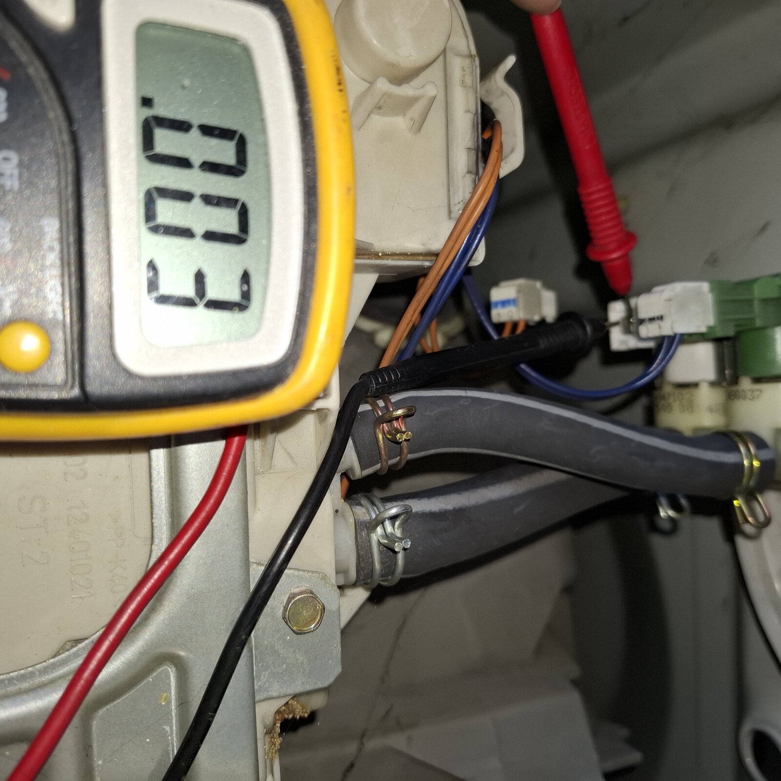

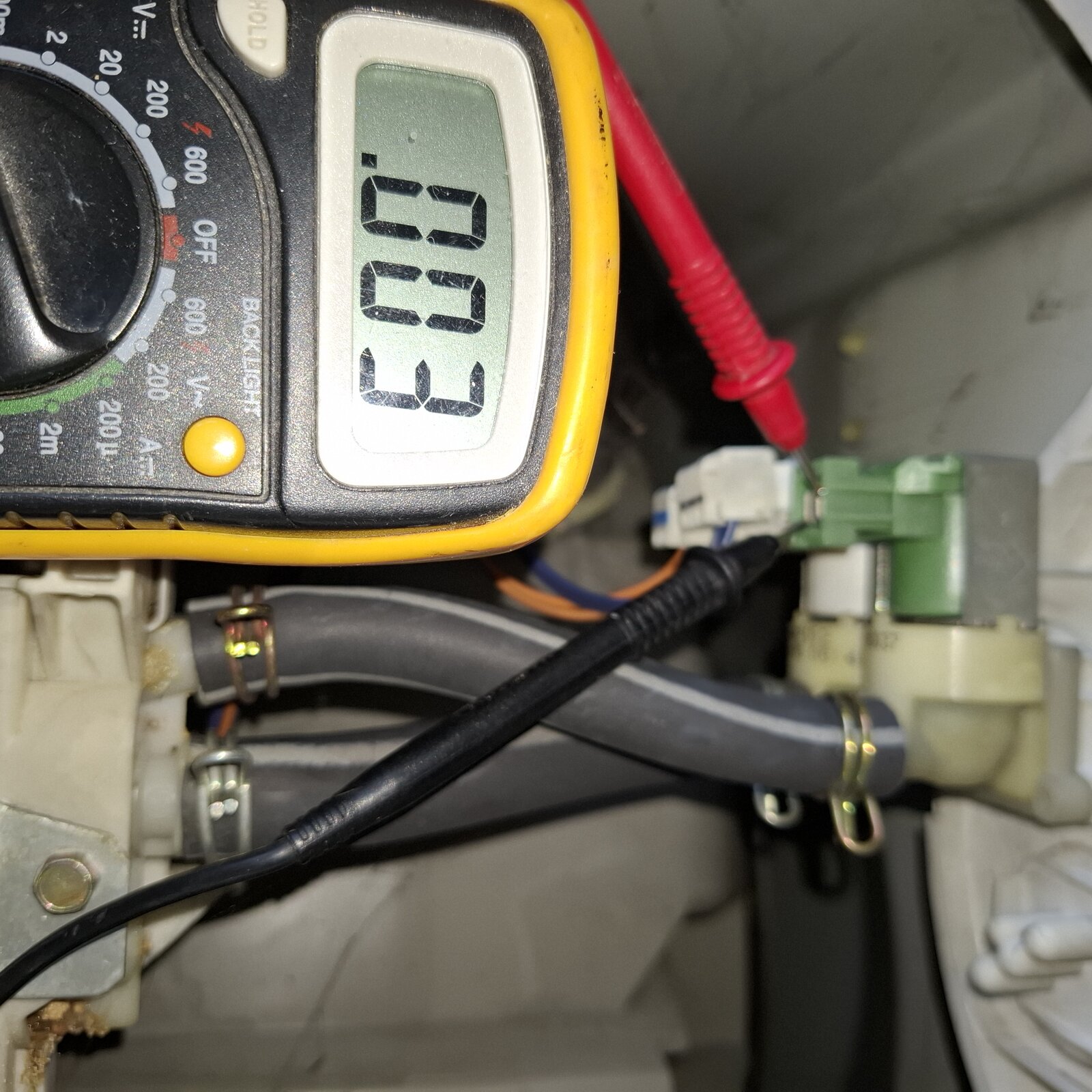

On the highest scale of my test meter, 2000k ohms the valve coils read approx. 5 ohms. You will need to disconnect the wiring to the valves to access the terminals.
Thanks Assuhors, ive set mine to 2M ohms and each valve reading according to the meter (attached) is .003? If i set the meter to 200k ohms i get 3.8 from one valve and 3.7/3.8 from the other?
HB I also looked at the pressure switch inside and saw some tiny water droplets on the diaphragm where the tube connects to it and i realised i probably didnt blow through the rubber tube after flushing it so i did that and reconnected the pressure valve and tube and now the machine doesnt trip the fusebox when trying a wash cycle. Still the same original problem though where the wash cycle goes to zero (and drains the water) part way through initial filling.

-checked water valve solenoids based on advice here
All appears fine but the machine still goes to drain and ends cycle as described.
