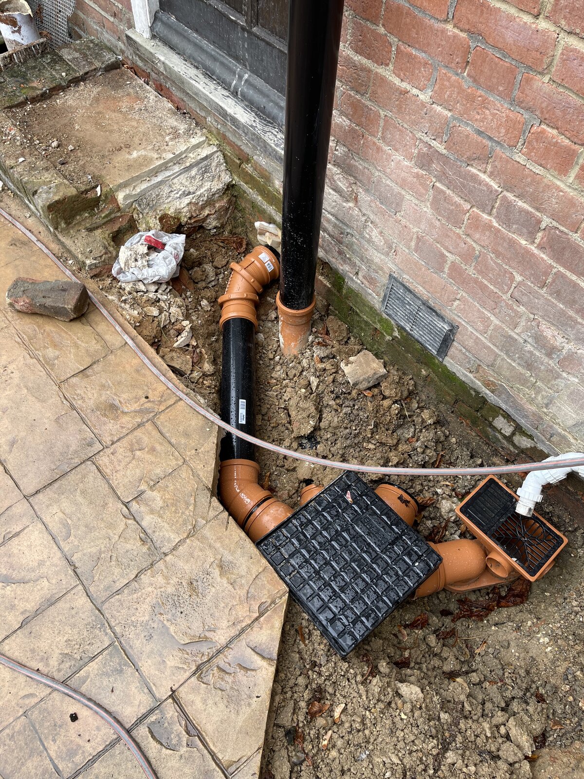

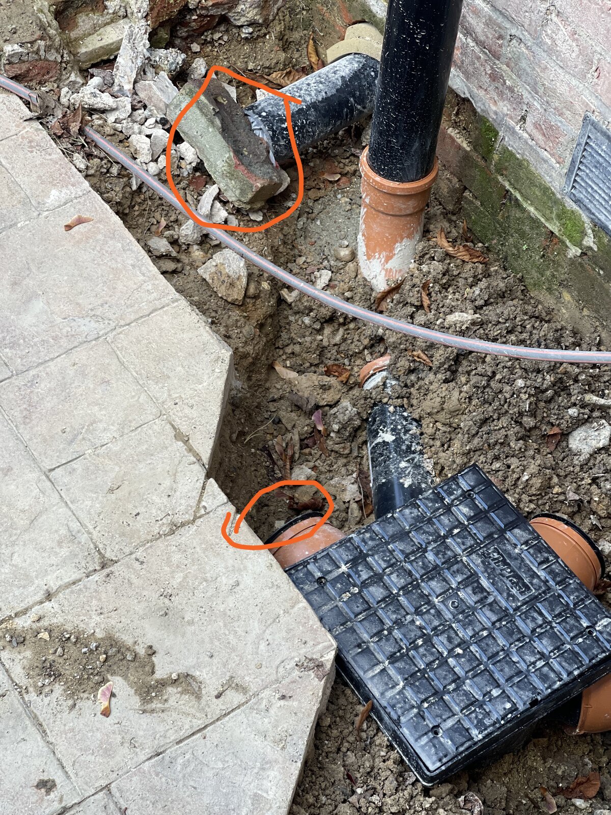

Joining soil of 2 different levels
That should be ok, just keep an eye on things. The more shallow the fall of the short section from the downstairs WC the better, reduces the risk of solids flying into the chamber and building up on the opposite side, as as said, hopefully the throughflow from above will help keep it clear.
