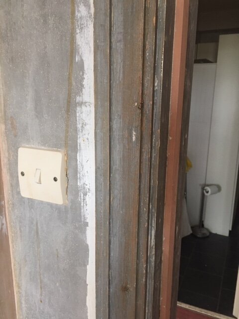

Hi,
I'm repainting skirting boards, architraves & door frames that had multiple layers of gloss paint in the last 50 years. I've stripped the paint with heat gun due lead paint present in the last layer (or the very first coat of primer/undercoat?). I would like to use Johnstone's Aqua Satin for my top coat, which I'm supposed to use the Joncryl Primer because it's the same system. However, previous painted surface had many knots coming through and I want to avoid this. Will Joncryl primer block stain? If not, is zinnser BIN the right product to use for water-based satin?
Many Thanks.
BIN will be fine for spot priming the knots but it dries so fast that I would not want to use it prime all of the wood. I have seen videos of Americans using it to prime woodwork architraves and skirting but none of them ever zoom in so that you can see the quality of finish.
Oh, and it is pig to sand flat. On the up side, it doesn't raise the grain of the wood. All waterbased paints do. That said, I prime timber with Leyland Trade waterbased primer but I do so because it is a dream to sand flat. The key difference is that I then apply oil based paints over the top, safe in the knowledge that there will be no more grain raising.

Think id get knotting solution over the knots then zinsser cover stain over the the lot. That builds up a bit and will denib really nice.
Then use your chosen matching undercoat and top coat following guide.
Consider scuff-x as a satin finish. So much nicer to use and way easier application.
Zinsser BIN as a all in one shellac will work. I'd apply 2 coats then undercoat to kill colour followed by satin paint.
All these options will work fine. The paint world has moved on so much and there are many ways to tackle these jobs. Study drying times in the data sheets following application advice. People do rush and get paint trouble not allowing enough drying times

So I've created new problems for myself now:confused:. Just took a closed look of the skirting board and saw that I've melted some knots off the skirtings and architrave in the process of using heat gun. Also, some part of skirting had very a stubborn layer of OB paint that just wouldn't bubbled up so I had to scrape it with force and I've created some dented surface scratch. I suppose I'll have to use a wood filler but the surface has lead and is there any tips on sanding down the filler? Also, is there a good general wood filler or must I use 2 part filler for long lasting finish?
2 pack filler will be more resistant to knocks from vacuum cleaners/etc. It also has the advantage of being sandable after 30-40 minutes. It is harder to sand though.
For minor dinks that are unlikely to be hit by things, I would use either Toupret Redlite or RedDevil OneTime. They are lightweight fillers that are easy to sand.
I strongly recommend against using powder fillers that you mix with water. I used them when I first started decorating until I redecorated a room 5 years later and discovered that most of the filler had blown. I now only ever use them on plaster.
My sanders are connected to dust extractors, some times you can connect sanders to standard vacuum cleaners using masking tape.
I'd use ronseal 2-part personally on skirting. It starts to go off ridiculously quick though, so get moving! It sands pretty easy I find.
On the paint subject, I tend to use knotting solution then Leyland Trade acrylic primer, goes on nice and dries quick, sands easy too.
