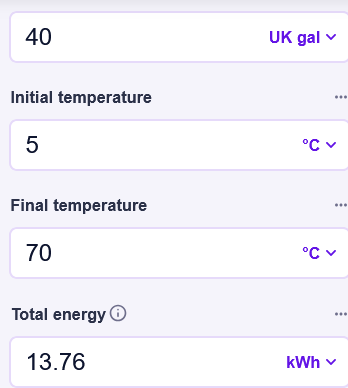

There are online calculators, 1722201402227.png I have used them to see how much power to heat my DHW tank, but in real life it does not work, as my immersion heater only heats the first 9" of water, so today exported 25 kWh to the grid.
