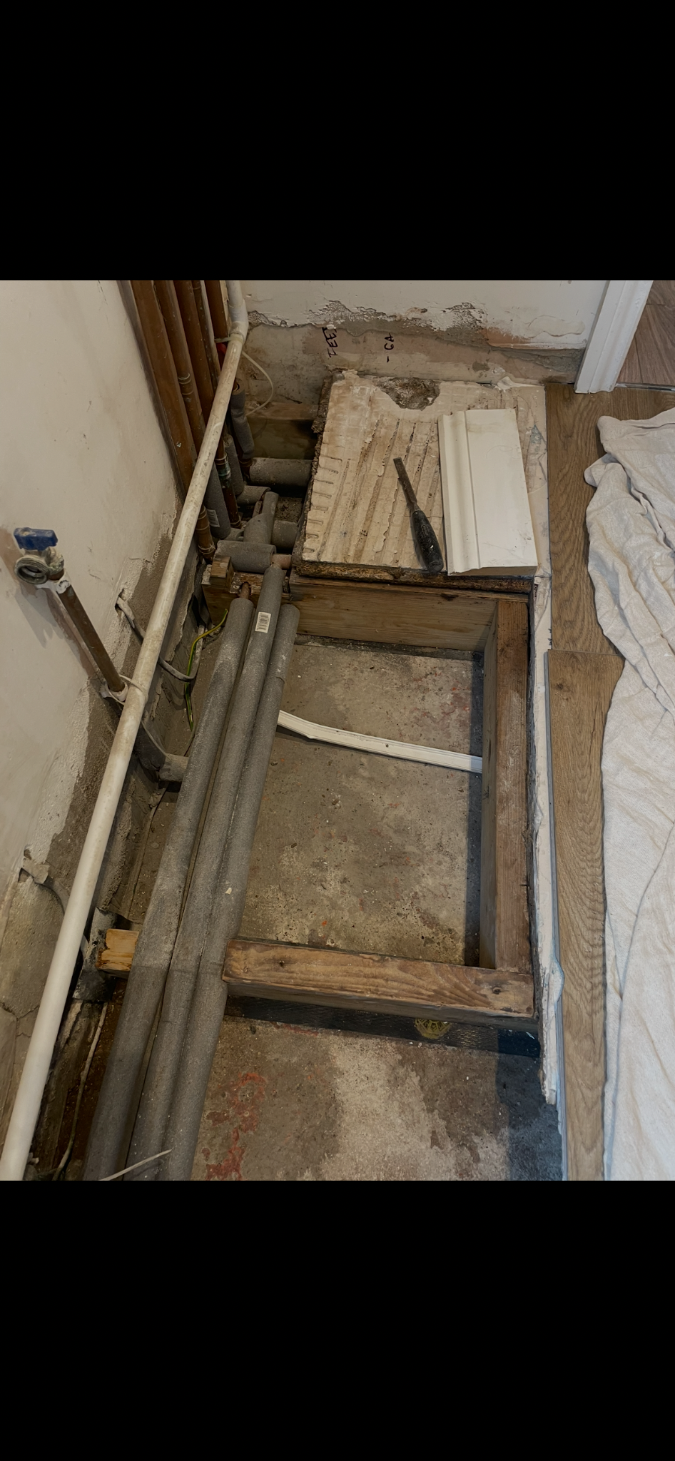

I’m about to replace the kitchen in a Victorian terrace extension and have noticed the concrete floor has 6x2 joists sat on strips of DPC. No ventilation to the floor.
Can anyone advise if this is normal practice and if it needs addressing?
Thanks in advance

Have you had a water leak as it does look wet. If that is how you found it when the floor was removed and there was no leak, then yes I would say you definately need some form of ventilation installing. Not sure how you would manage it with the joists the way they are though.
