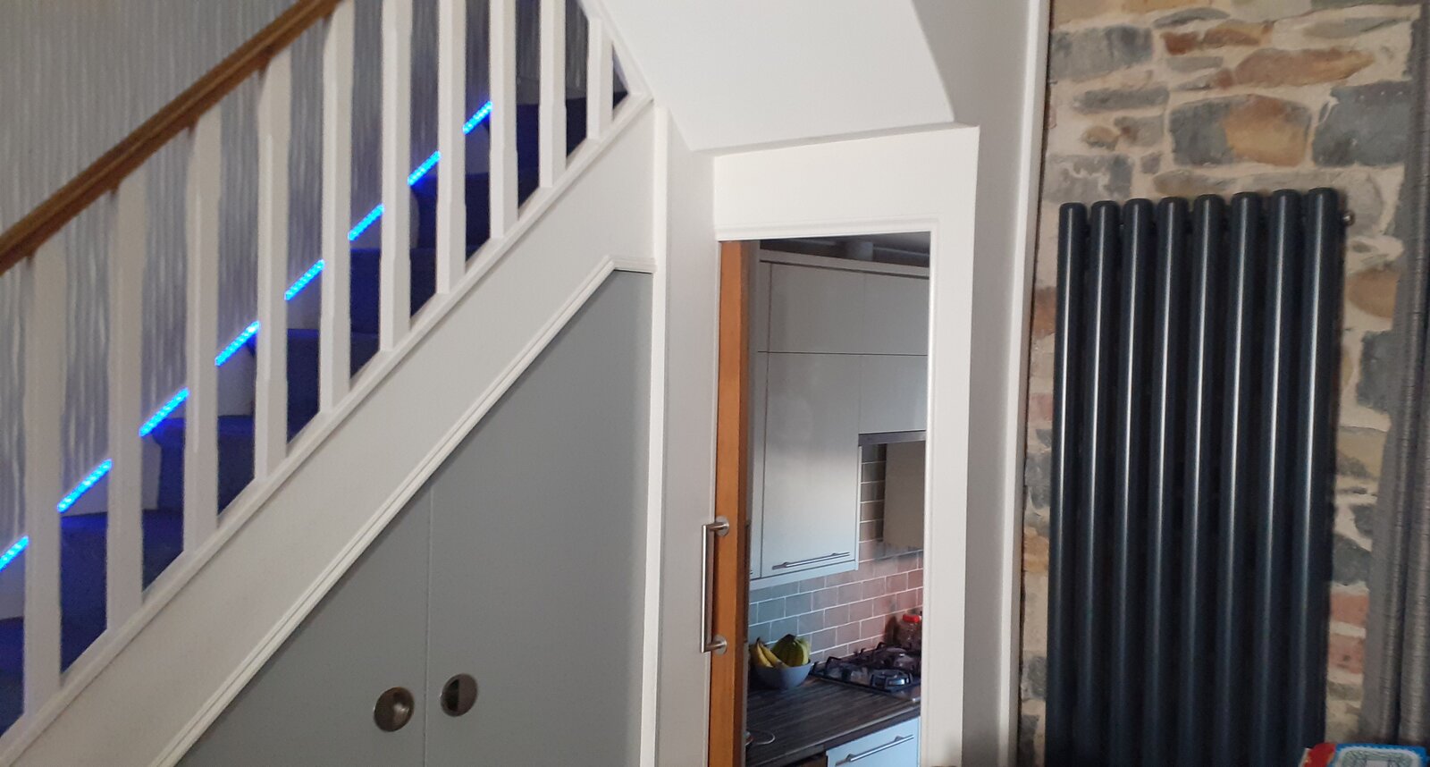

...and with the change in Victorian house design, of having stairs perpendicular to the street; the half landing would make a very low ceiling in my kitchen if it wasn't sunken! :)

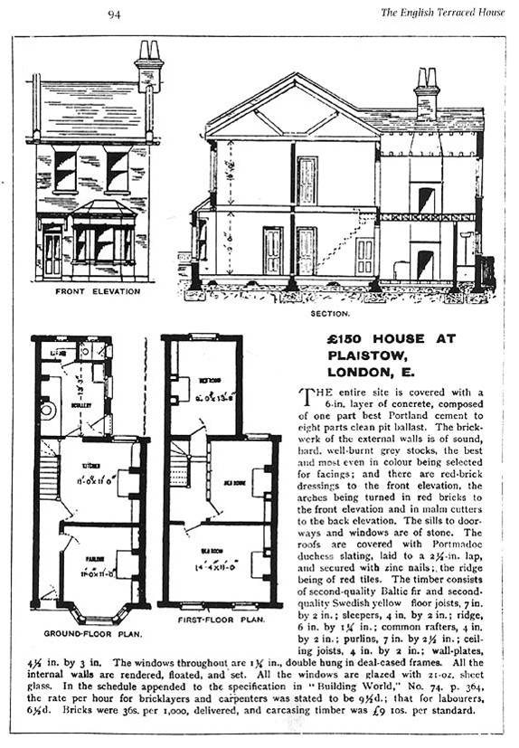

As the bathroom roof was designed as an extension to the main roof ie a ski slope without a gable end the head height in the bathroom was low hence the drop down.
Also, my memory having been jogged,…
A mate or two’s first homes had the kitchen and an outside toilet on the back “extension” (probably built from new)
There was often a smaller bedroom built above the kitchen.
Over time, the smaller bedroom was sometimes converted to a bathroom.
The thunder box became a shed.
Again, the stepping was probably roof related.

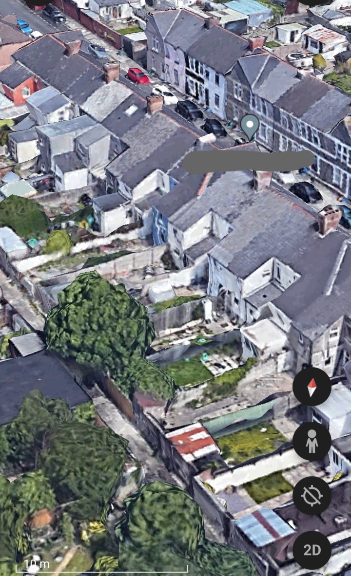

My brother’s house was a much larger terrace with a shared pitched roof with next door. This was a 90° to the road.
But it meant a flat floor to bedroom three and a bathroom more in the main house.

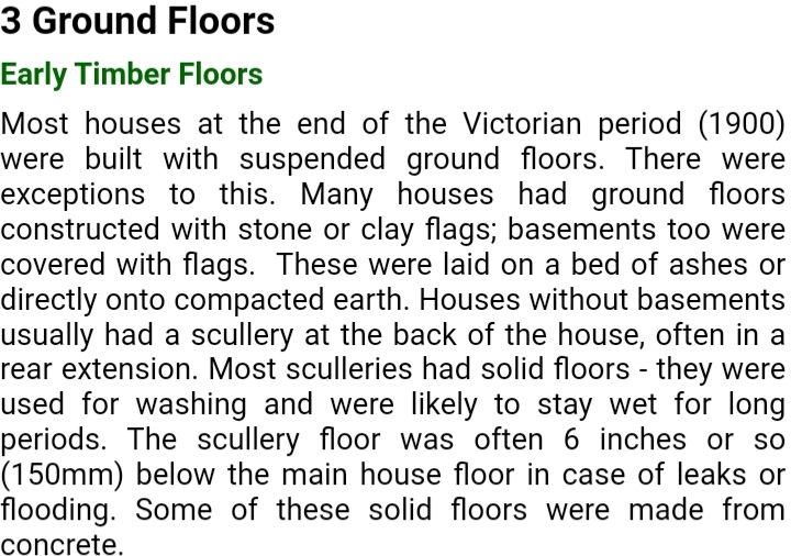

Stone flags in the scullery and a suspended floor for the living rooms
Would they make a bathroom lower than the next room lower to avoid water flowing through the house if there's any water spill from a bath or sink, or even a leak?
In some cases the back addition has a concrete or flagstone floor laid on the ground
This description seems to support the idea that the scullery was built on the bare ground, at the rear of the house, lower than the suspended floors (as decreed by the bylaws) of the living rooms, for the principle reason of avoiding leaks or flooding...
Again, possibly worth a read :) ...

After thinking about it further and looking at various photos, I've come to the conclusion that, at least in the case of my house (and the nine other houses on my terrace), the bathroom was sunken to bring the kitchen/first floor bathroom extension level with the existing roof, whilst ensuring sufficient headroom in the bathroom.
If the bathroom floor had been raised to be level with the first floor landing, unless the bathroom ceiling was vaulted it would feel pretty claustrophobic in there.
