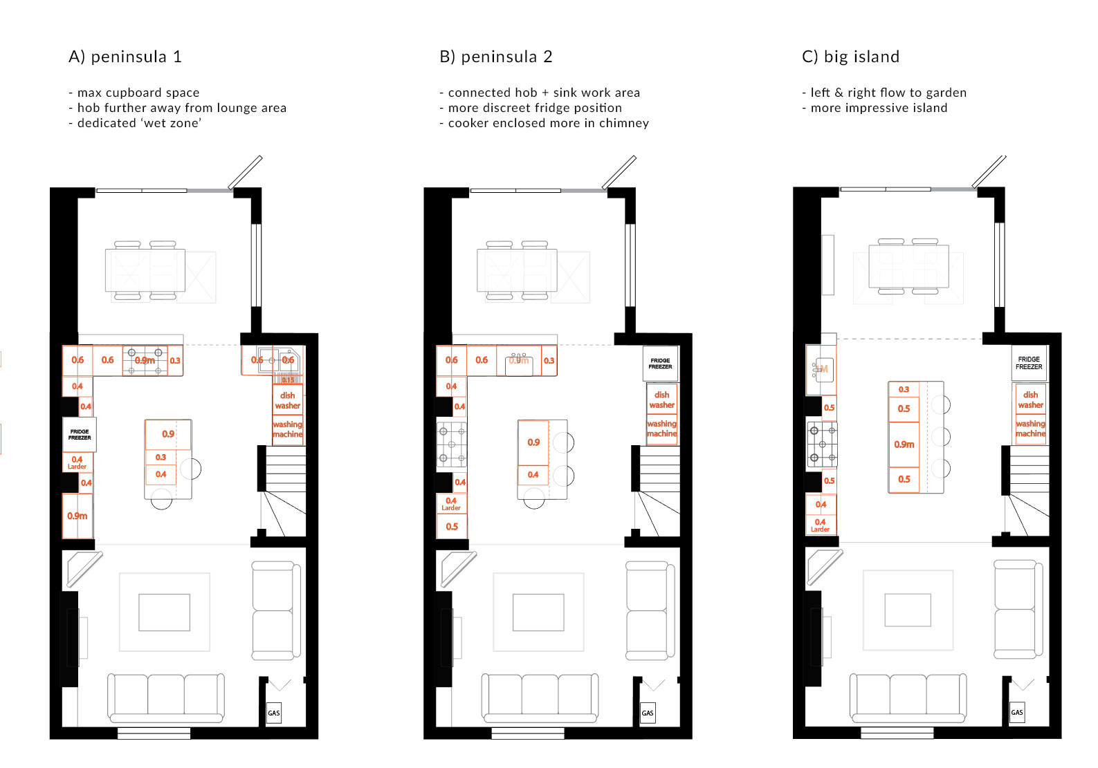

Hi all,
As it's not building-work specifically, I thought I stick this in here.
Designing a kitchen layout and I'm struggling to decide on what will work best from a functional point of view, as well as a livable space point of view.
Take a look at the attached and see what you think of these 3 options. I was thinking a massive island would be nice, but feel a smaller island and peninsula setup would probably be more practical.
I'd prefer to keep the kitchen action further up top and away from the lounge area (noise/smells etc). But it's not as sexy as a big island is it??
There's a respectable amount of clearance around worktops in A and B, ranging from 850mm - 1100mm.
note: restricted head height under stairs means base units can only go in the lower area. There is a step up in to the dining bit, then bifolds out on to garden.
All suggestions welcome.
