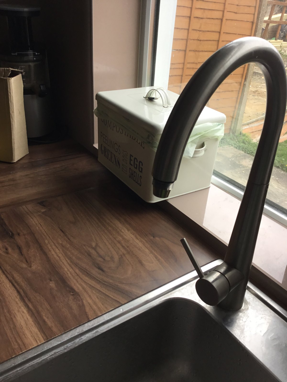

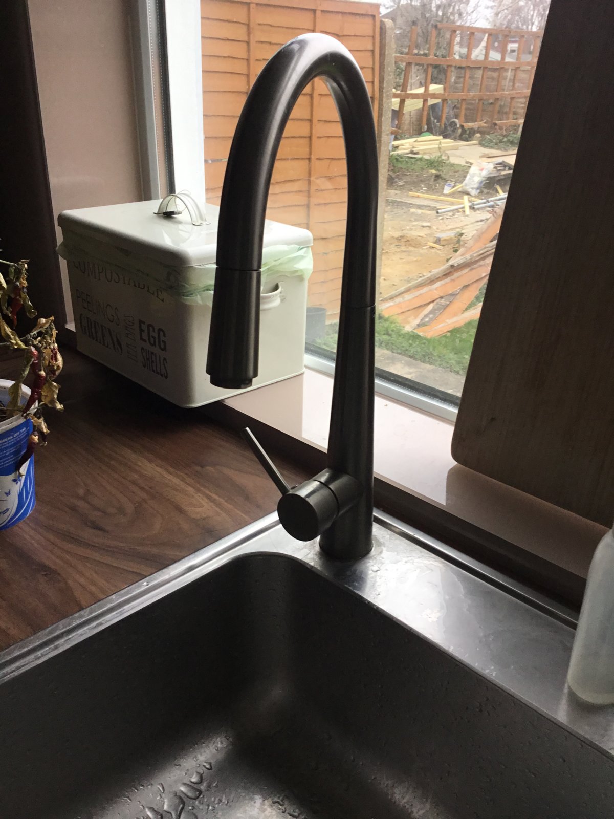

I have a flexi hose type tap which you can pull out.

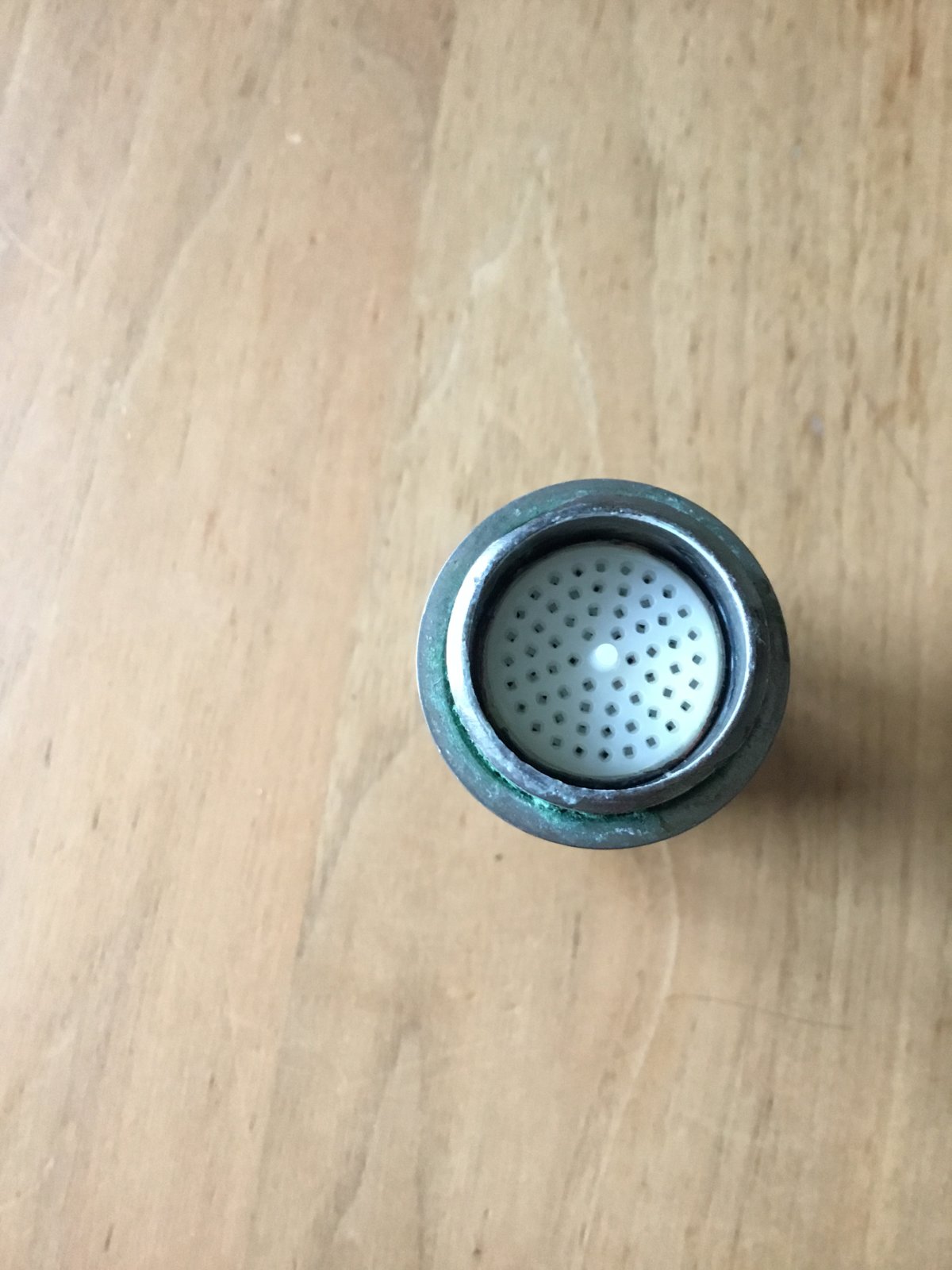

The mesh/diffuser on spout has broken causing the water to spray when the tap is in use. What is left is just the white plastic you see in the photo.
I can’t find the make of the tap anywhere.
Does anyone know where I can get the replacement mesh/diffuser or where I can get a new spout?
The spout is quite heavy and feels very solid so I am thinking it should be a reputable product that I can hopefully get replacement rather than have to change the whole tap.
It is brush nickel in colour

Footprints, thanks for your response. I need to find a female tap spout instead of a male.
I was hoping to find an exact replacement as the chrome and brush nickel will be a contrast. But I'll try amazon again

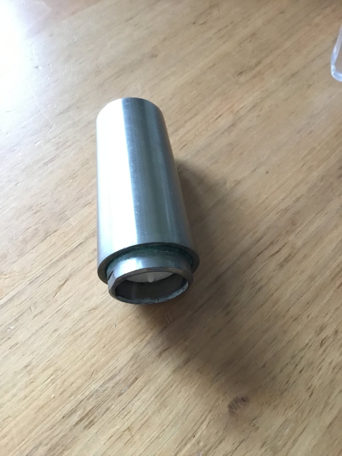

Look at your third picture looks like the part with two flats might screw out of the large chrome section. Try holding the chrome tube with a rubber glove and put a spanner on the flats.
Footprints, great observation. I managed to take it apart easily and now know exactly how to replace it and what part I need. Many thanks for helping out.
