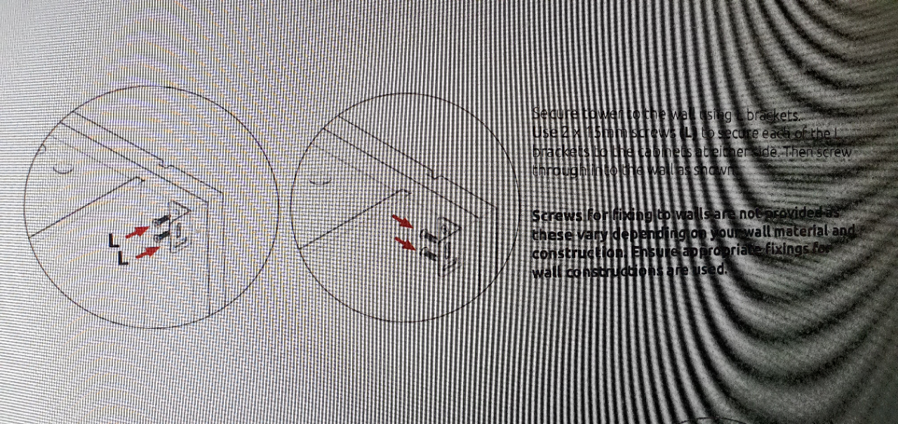

Hi
Please someone help me, I have got a Wren kitchen which I am trying to install but cannot work out for the life of me how to fix to the wall.
I have attached a photo of the instructions but I do not understand it, there is a back board at the back of the unit which would be the inside back and the fixings would go behind
I totally get the L Bracket that fits to the side of the unit but have no idea how the F to screw this to a wall, if the back board was not there, easy, but it is an cannot be removed
Anyone done this before?, I have 6 of these to fix to a wall
I can't screw through the bracket to the wall though, the back of the cupboard is in the way
The only possible way I can see this working would be to remove the back panel and then put back in once attached, the problem is that these slide in and would need to have enough space above (and below for that matter) to be able to do this which there is not.
The other alternative would be to cut a hole out of the back of the unit
I must be not seeing the bigger picture here
Position the cabinet, mark the wall where the bracket goes, remove the cabinet, fix the bracket, replace the cabinet, screw the bracket to the cabinet.
Do all of the above before fitting the worktop.
it will be much easier if you screw the bracket to the unit first, then, using it as a guide, drill holes through the back big enough to put your screw and driver.
Or you could use Cabinet hanging brackets. Although I think this is a floor-stander, they will grip it to the wall enough to stop it falling over. If it is a wall unit, the adjustable hanger is what you need.
Or, if you have enough gap above the unit, fit an "L" shaped bracket to the top and screw it to the wall.
Screw the stretcher plates to the wall first - it will be easier to fix a 2 x 1 batten to the wall then fix the stretcher plate to that. Then position your unit and screw through the stretcher plates onto that - a 150 or 300mm long magnetic bit holder will be a great help. Alternatively a right angle head for the cordless will do the trick
If setting out for, say, a 500mm wide unit, your 2 x 1 batten will need to be slightly under 464mm long (500mm les 2 x end panel thicknesses = 2 x 18mm - assuming a standard 18mm carcass). That gives you plenty of scope to level the batten and get a fix into masonry or probably at least one stud. How you tackle fixing the batten does depend on the wall type

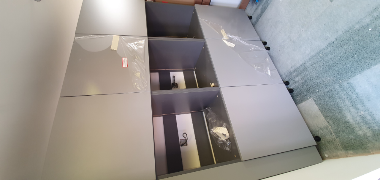

Hopefully you will see what I mean in the photo below. Although it is sideways, there are three units and according to the instructions I need to install the L brackets at the top. This would be in the top cupboard on each unit. As you can see in the middle of each unit (where the oven goes) there is a groove where the back of the cupboard is in the top and bottom behind the doors.
The bit that goes in the groove cannot be taken out which leaves me no room to screw it it, must be an easier way?
Perhaps install the L brackets in the middle?
In that case install the brackets below the top cupboard, fixex to the underside of the cupboards, behind the ovens where they can't be seen. Positioning isn"t that critical, just so long as you can hide 'em
Yes i will install these to the open bit that i can see in the middle where the appliance goes.
Wierd that the instructions are naff though. I have emailed Wren to see what they say on this

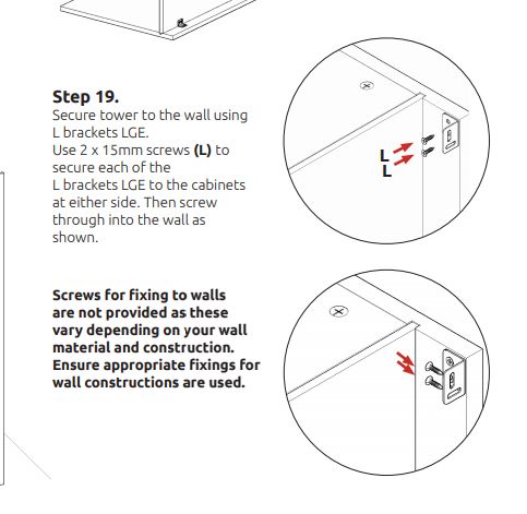

Just for giggles, this is going to need to be secured to the wall also and i am going to get in a pickle again, in this instance though there is no open area where this can be done. I have attached the instructions which i do not understand or maybe i am missing something. Instructions appear to point to screwing a fixing from behind the back plate into the wall (about 2 inches of space). Cant see how this is possible without making a hole in the back plate
No. it is secured in one of the previous steps, wierd huh, it is quite thick (not the hin 5mm stuff you get on some back panels)
