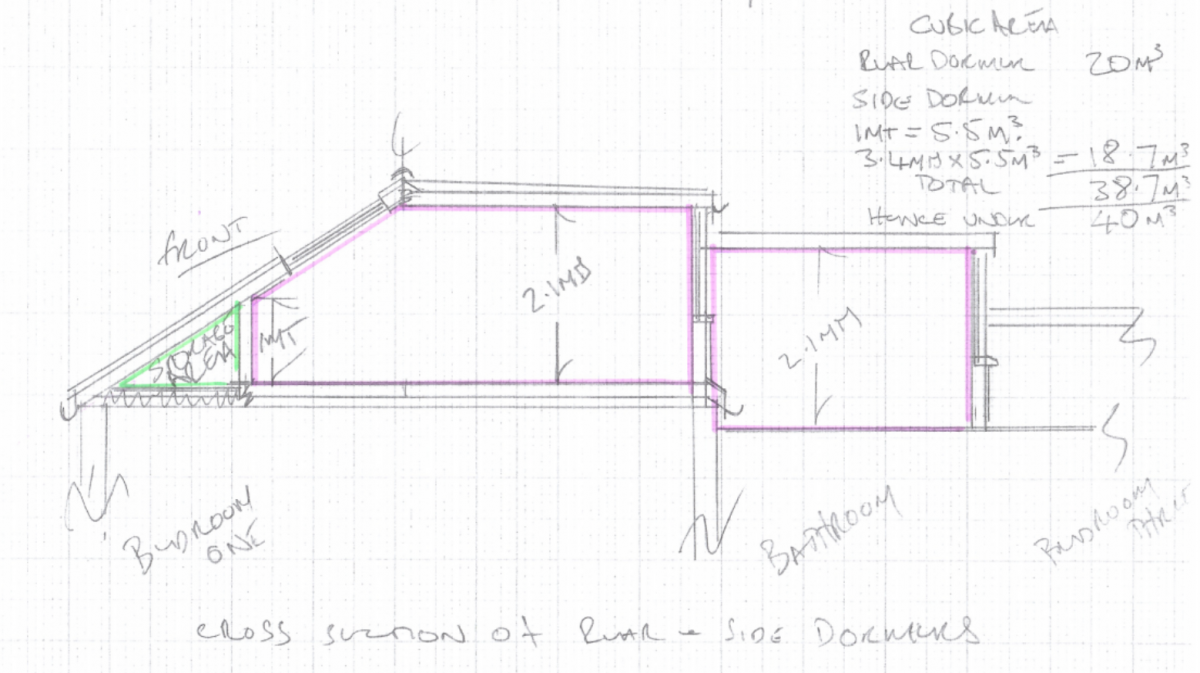

Under building regs for a terraced property, my understanding is that we can only have a maximum of 40m3 for our dormer extension.
Our has has a long rear roof of around 8m in length and 3.5 meters in width.
Is there anyway we could get this approved under PP?

Are you sure you are over the 40m3 limit? (It's the additional volume not including the pre-existing volume in the roof void).
I am not sure but I am assuming the company who has given as some plans have used most of the 40m3.
Please see attached pic.

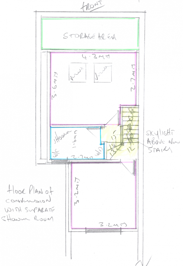

Ideally we want a bigger separate bathroom and rear dormer (we don't want to reduce the size of the front dormer by having the bathroom within it).
We was thinking of adding 2 more meters of length to the rear dormer but not sure if that will exceed the limit?
If you want to get it done under Permitted Development, you will have to keep the volume of the dormer
below 40m^3. If it is local planning policy to refuse dormers, that is the only realistic way to get it, even if it means reducing the size a little.

have you got any proper drawings to show the dormer? - without those it's difficult to give any pointers.
So it does look like you've incorporated the existing volume into your calculation. Is that right?
For the side dormer I think he hasn't but for the rear dormer I am not to sure?
Still hard to tell - might be about right for the rear-facing dormer, but not sure on the outrigger dormer. It depends on how high the
ridge is on the outrigger, which we can't see.
