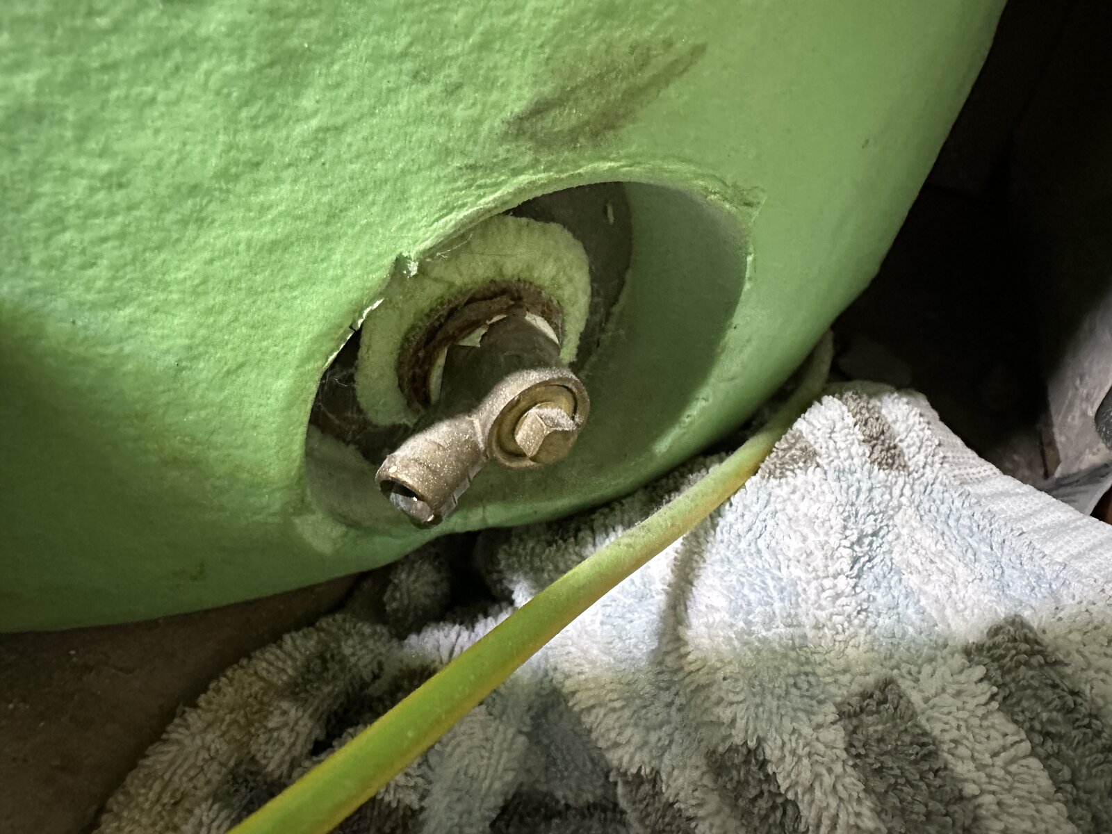

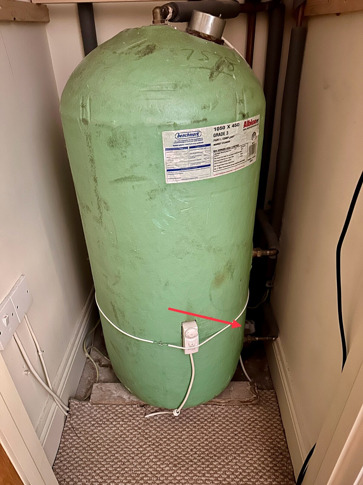

Ok. so I was having a nosey today to see if I could shut off the water supply to a bathroom tap as it needs a washer. While having a look in around the water tank, I found a new problem. I noticed a dripping on the floor from the tank. On further inspection I noticed the floorboard had been a bit wet at a previous time. Now, however I could see a drip.

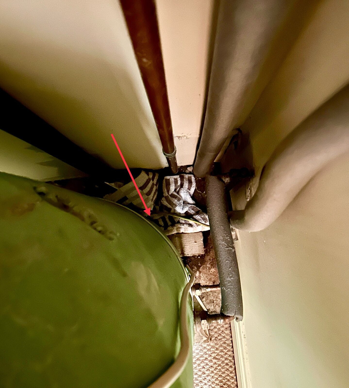

I got the phone out and took a few pictures. It was drpiing from a valve of some sort at the rear of the tank. I put a towel down and was able to turn the square looking nut to shut the water off. It really did take a good turn maybe half a turn or more to stop the drip.
While I'm happy the dripping stopped and I didn't flood the house, I'm a bit worried as I'm not sure what this leaky valve is or why it would just start leaking like a drip every 6 seconds. I'm in the house 10 years or more, so why would it start now And why was the square nut so loose...?

That is the drain valve for the cylinder, if it's stopped now then you should be ok. Keep an eye on it in the short term, just in case. If it starts dripping again in may need the washer replaced but that's a full cylinder drain down
The bubbling may be the water heating in the cylinder, is the CH system water (rads) quite hot?
Thanks Madrab, I will keep an eye on it for the next few days. Right now, 6 or so hours after I tightened if, all is still dry, no drips.
