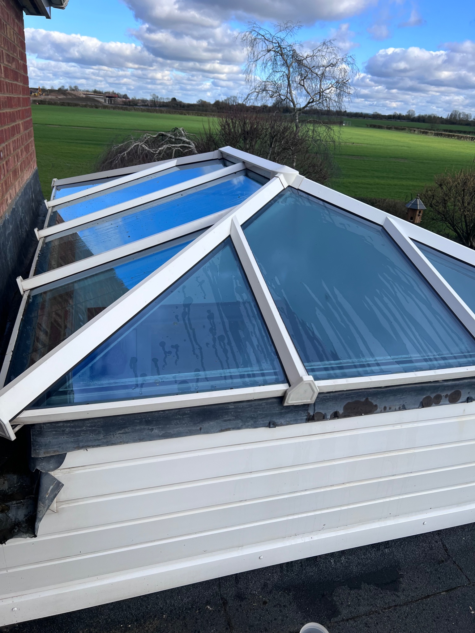

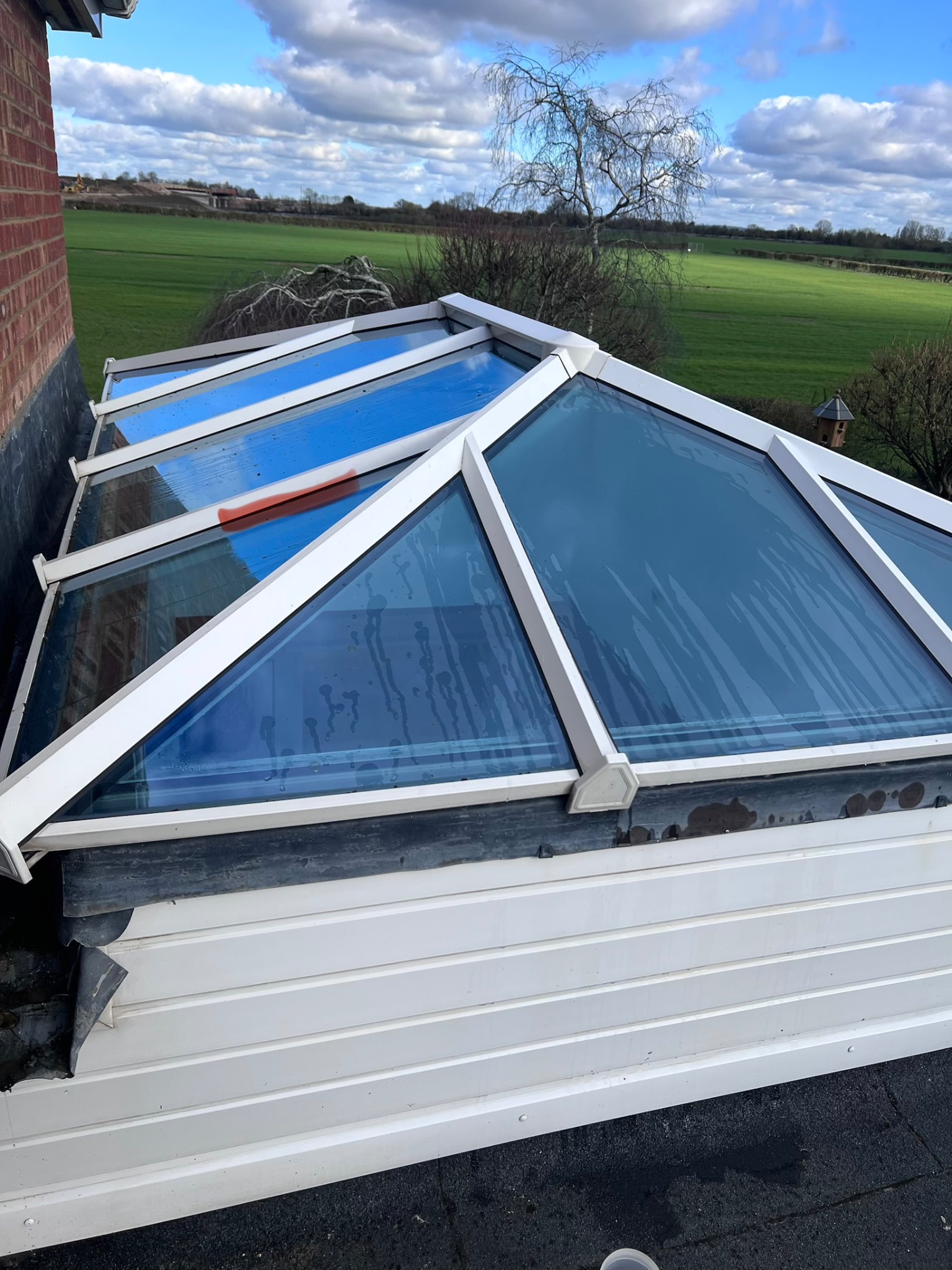

It was dripping inside along this rafter (marked in red):

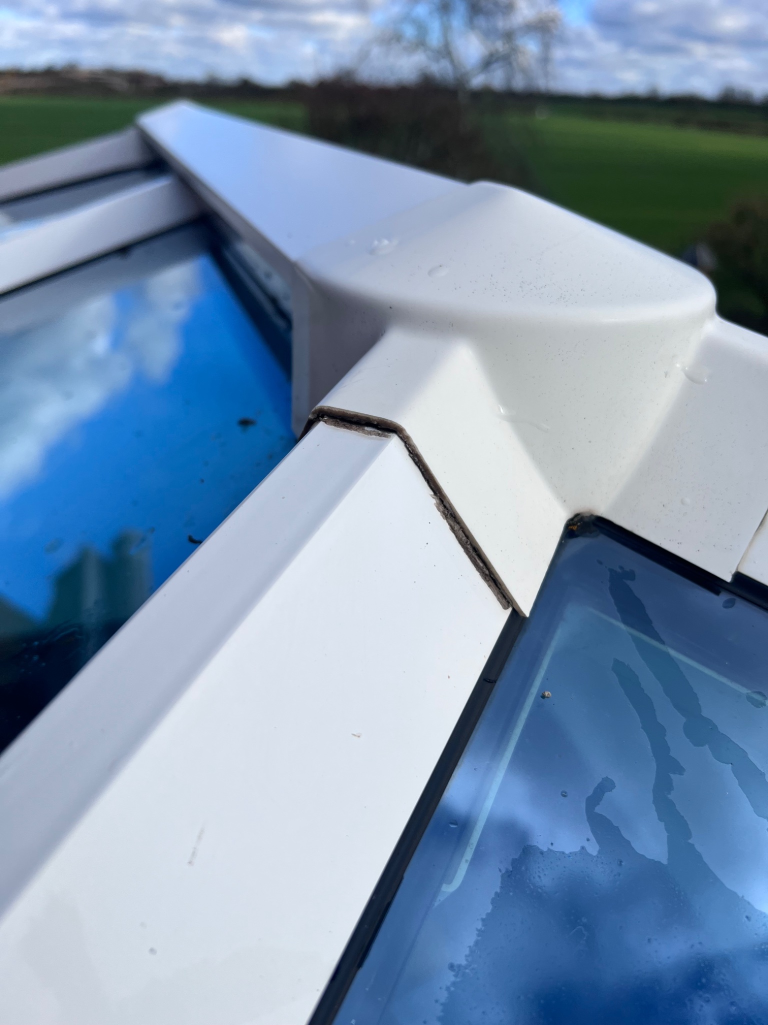

I had a look at the rubber seal and they seem fine but noticed that there is a slight gap at the top of the rafter here. There also seems to be some residue:

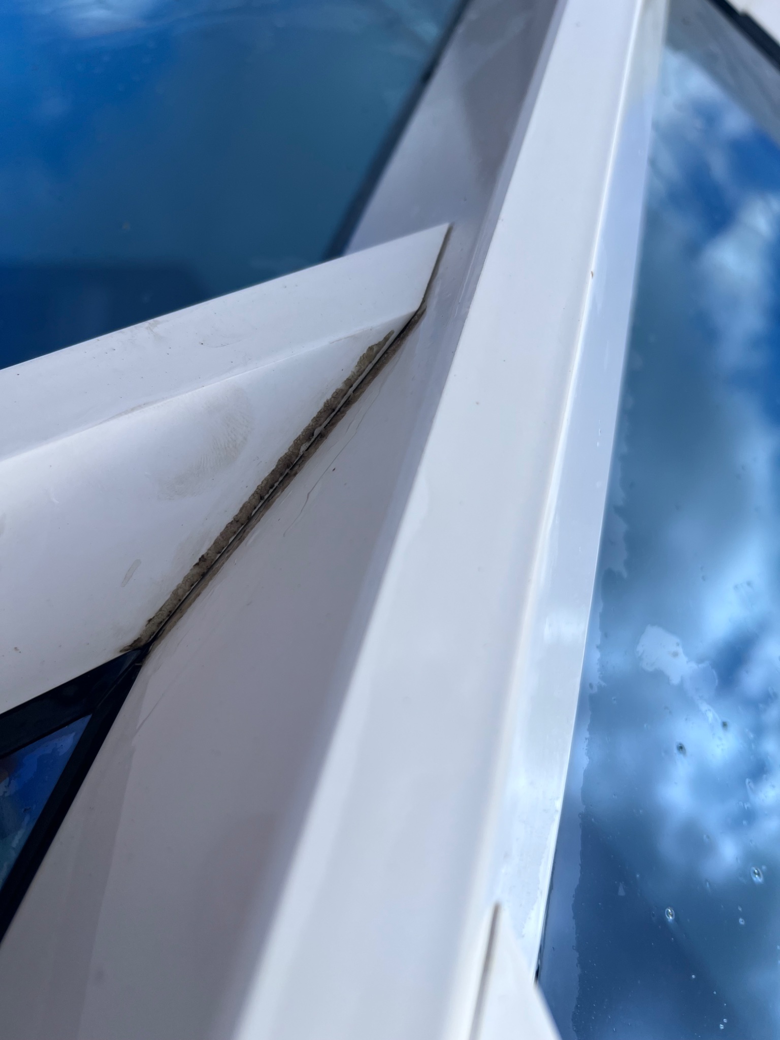

I can see this residue on other joins too:

Clean it up with something like white cif (.dont use the yellow it will stain ) , then apply a beading of white silicone where white trims meet white trims , and clear silicone in other locations you fear it might be leaking

Should I be using a certain type/brand of sealant? I assume CT1 is not suitable for this?
