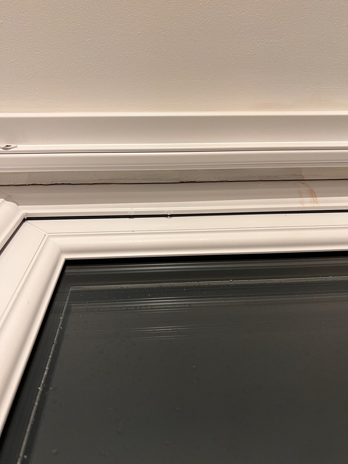

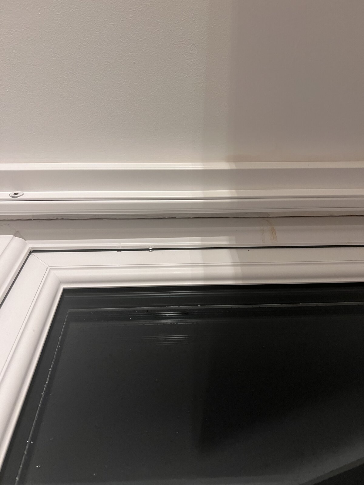

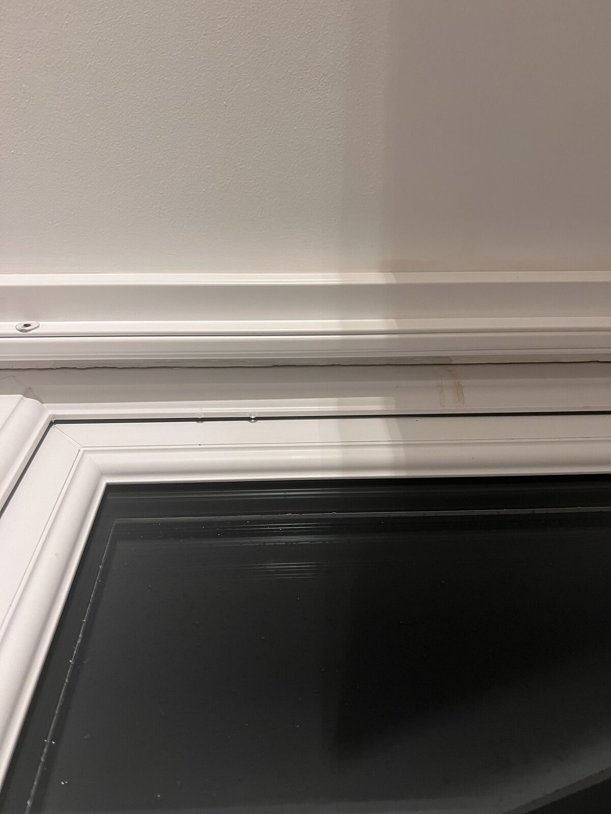

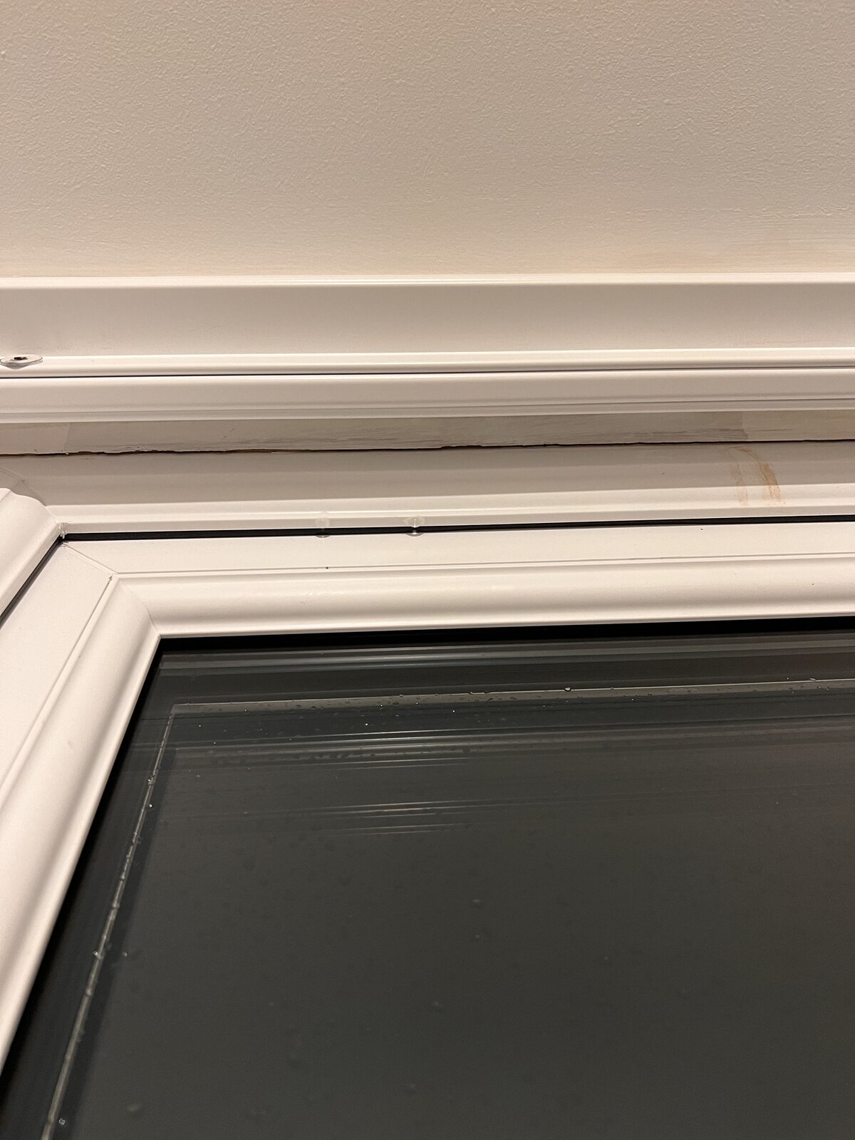

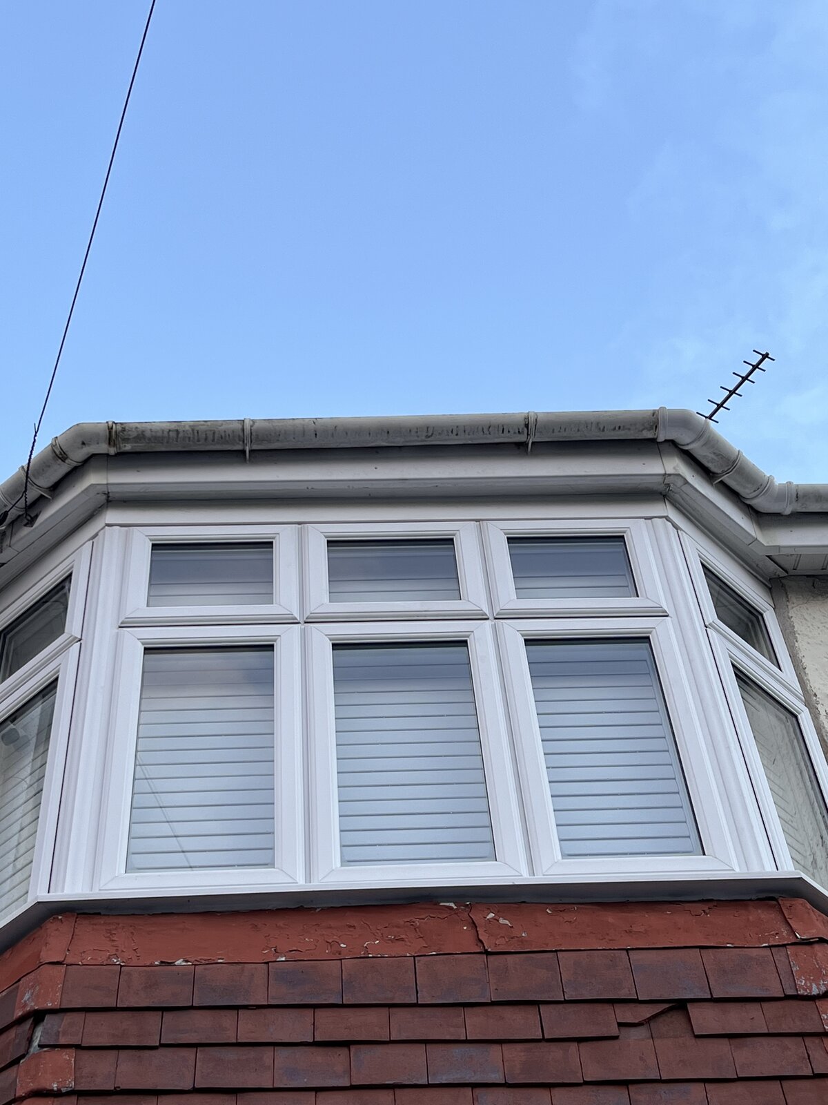

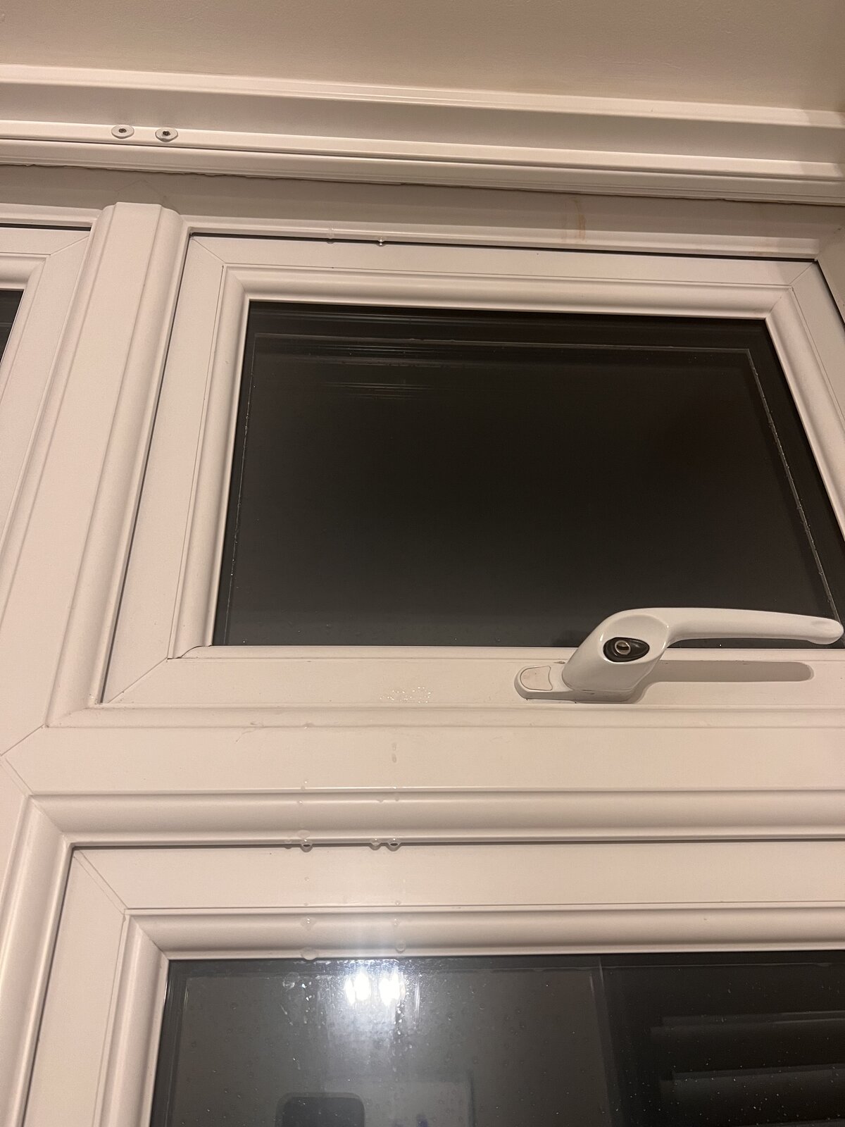

Can any recommend what to do with my leaking bay window in top bedroom. The windows are only 3 years old and it’s dripping only from the top as seen in pictures!?

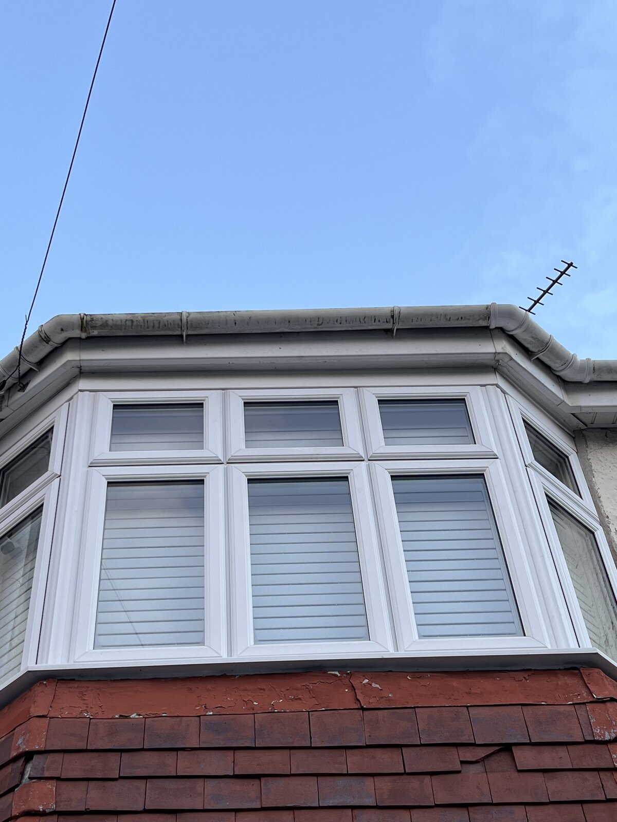

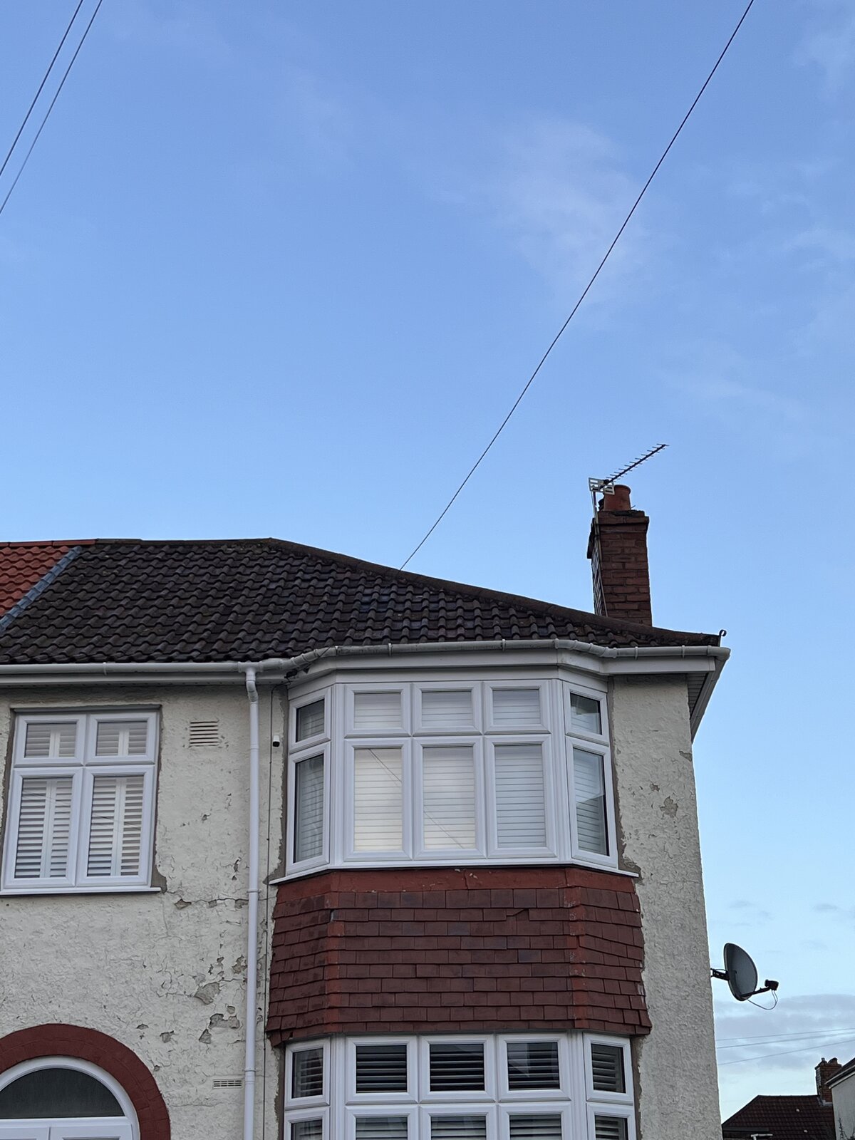

How old is the house?
Show us the outside, all the way up to the roof and gutter. Include all downpipes and any plumbing or flue.
Also show us the top of the window frame, and the brickwork or other structure above it.
Was it raining when you took the photo?

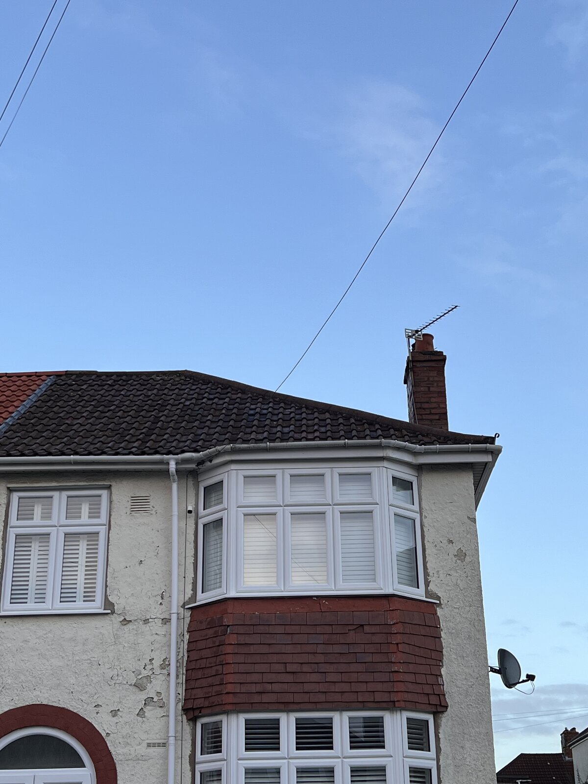

Yup it’s a 10930s and yes I did take
It when it was raining. I’ll try taking some more pictures later. But it is all decorated on the inside and I have fitted shutters also. But I’ll send of later. (I know the render looks terrible. Its old paint flaking off.)

Looks like you have a little flat roof over the bay.
They usually last 30 years, sometimes 50
I presume you can't get up there to look at it
So ask around for a recommended local roofer or someone with a drone
You might be able to poke a selfie stick out of the window to see if the gutter is spilling or if there is a defect in the detailing above the window.
The gutter joints look poor to me and the damage to the render may indicate spilling or leaking gutters. Watch them during and just after rain.
