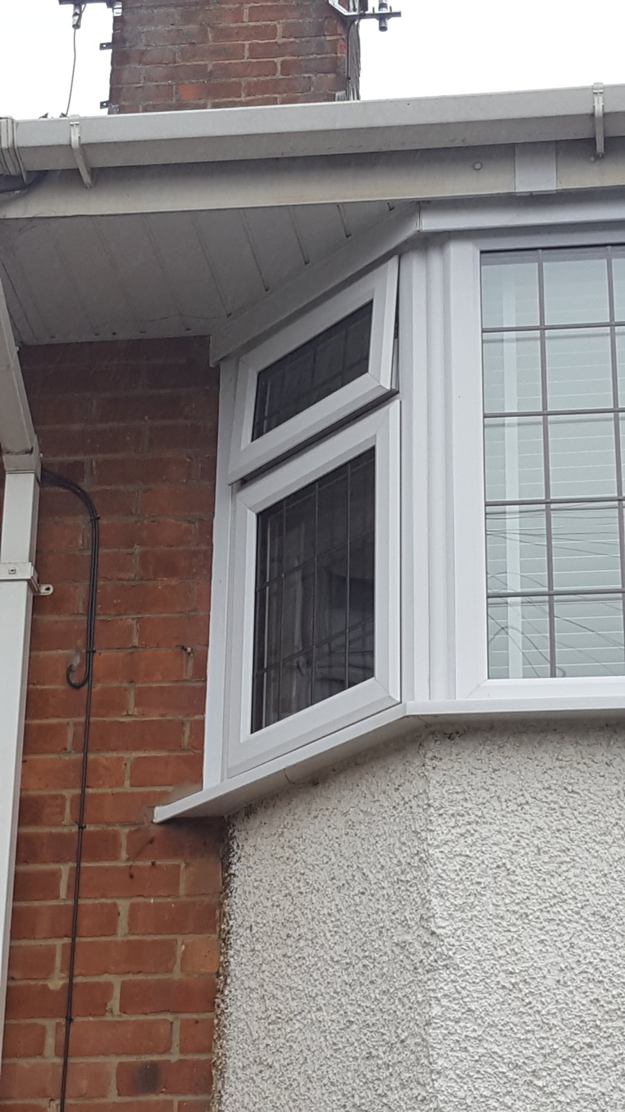

show us some photos of the bay, from the front and from above.
pay special attention to the lead flashing that prevents rainwater penetration where it joins the house.
Also of the gutter above.

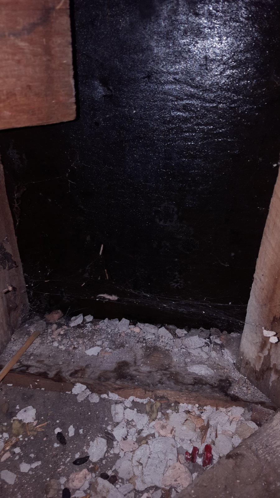

Thanks for responding. I have just taken a few snaps of outside the house and under the boards of upstairs. The black material is wet.
good overhang. So have a look in the loft, and from across the street with binoculars. The water may be leaking through the roof.

20190115_112625.jpg this is a membrane within the wall, it appears that the other side of this is brick and inside is lost insulation and then plaster. This membrane is wet
that looks like you have some kind of dry lining on the bay. If the water is only seen beneath the window, it might be that rainwater is leaking at the window. But it should be protected by that big roof overhang so I don't see why. If construction is correct then water should be on the outside of that felt or whatever it is.
