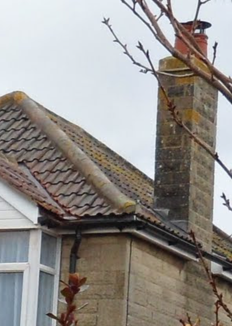

1933 house, chimney with 2 pots/channels, one capped, one in use for log burner (new 25y one in 2013). Roof was "reroofed" in 2013, so new battens/membrain/leadwork and same tiles. High quality job. Lead work was done by a specialist leader in their team and it looked perfect and was seam welded. (pic is from 2013 when it was done). No prior concerns over the work that was done and for sure last 11 years been perfect.
(though I'm sure in the flesh there is more of an upstand on the lead on the south facing wall than appears in the pic, and I'd have expected the lead to have diagonal steps rather than vertical, but as I say they were an expert team and didn't rush (fair fixed price) and it has been fine)
The front of house is south facing, so the pic below is looking north.

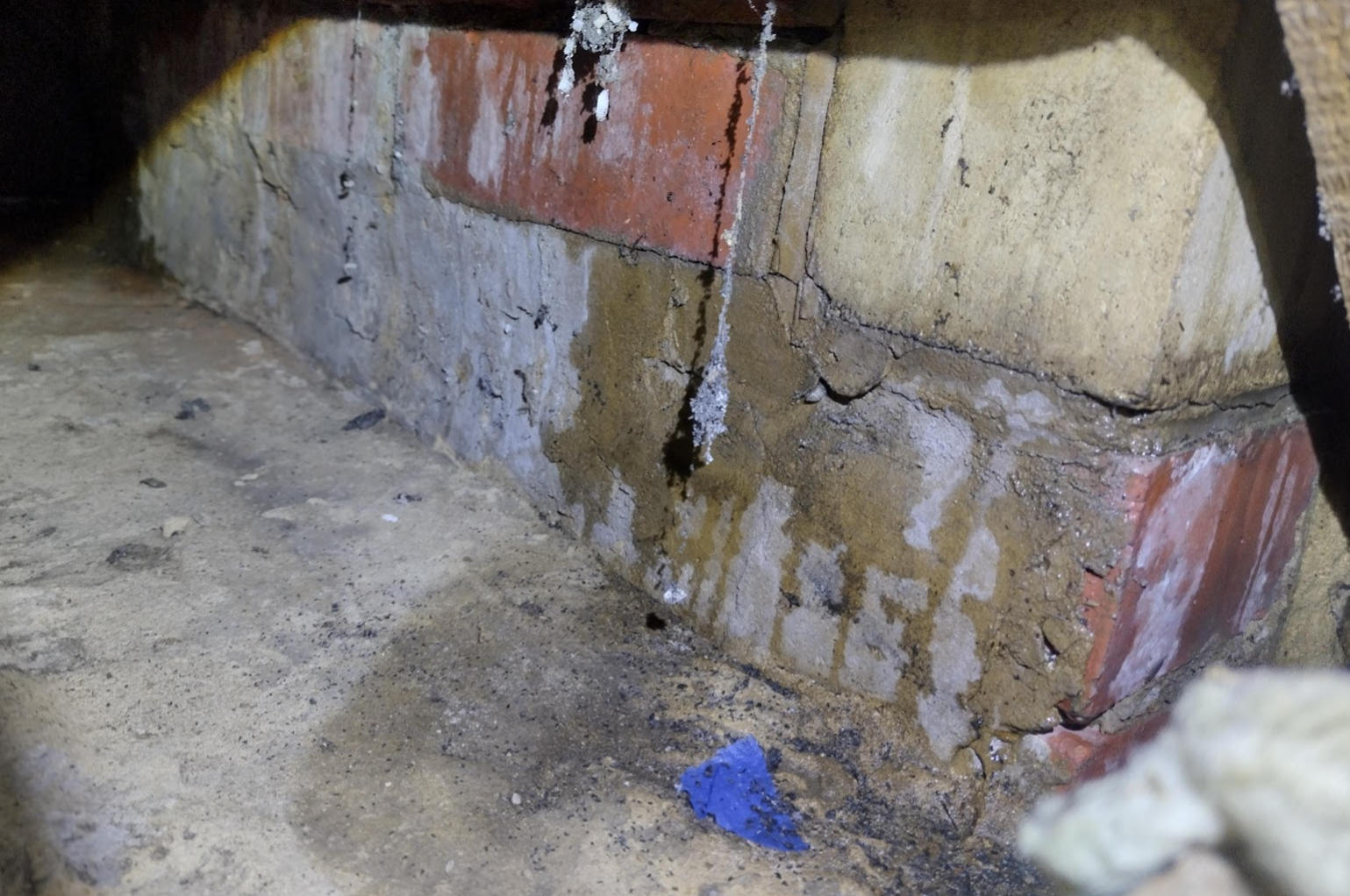

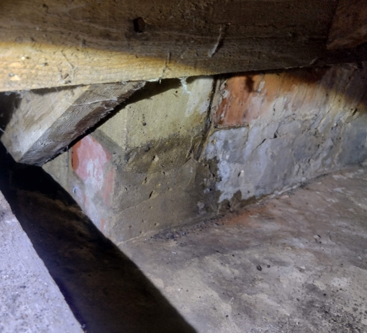

Been up in loft today and (as always) no sign of ingress anywhere else, but on the chimney inside the loft there is water coming in at the loft side front side (south west corner). I've run an inspection camera inside the eaves to the chimney, and there is cracked mortar pointing that is soaked but no sign of water running down onto it, so I'm *thinking* it may be coming from inside the chimney or from behind the flashing and then wicking through?

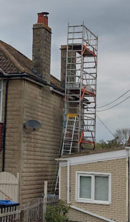

Internally, overnight, you can see the water in both rear corners. I can't believe both corners have failed as guessing water is getting in somewhere and tracking. Can't see the rear without scaffolding, so thats arriving end of week
The loft floor is concrete in that area (surprising to me!) so assume a little amount of water has been able to get in and sit on that and evaporate off and its only rarely gone into the bedroom below.

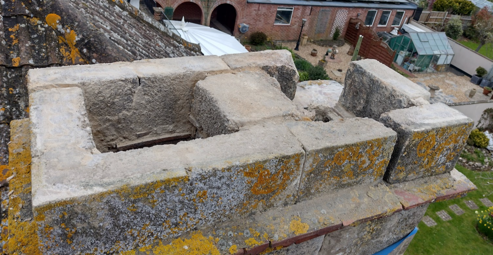

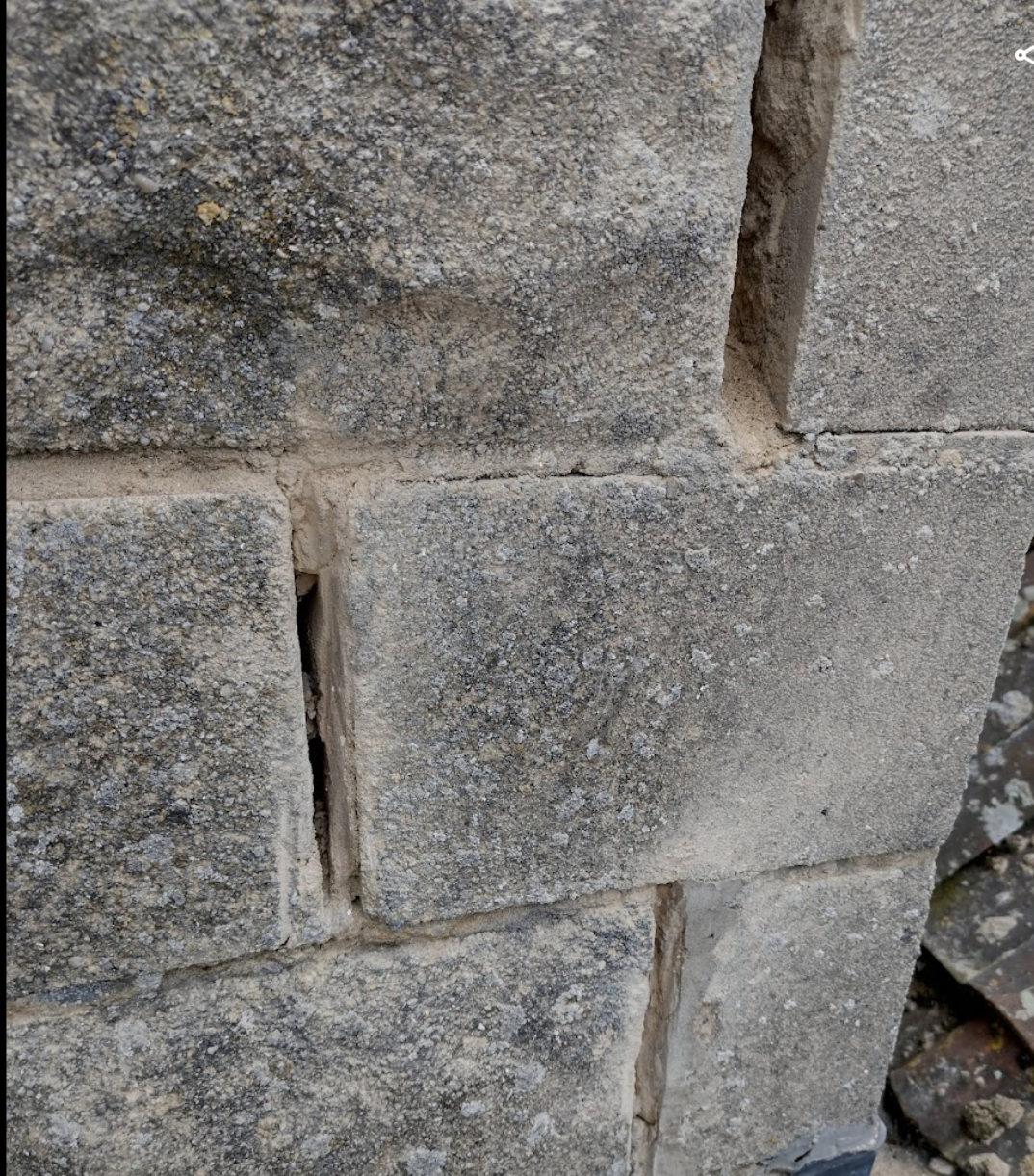

More pics from a look on the roof today.
Sadly my dream of seeing something obvious was crushed.
There are some vertical gaps at edge of the lead but thats how its done I think, and the membrane does go over the saddle so that looks OK. Rear gully was clear and pointing looks good. Not looked at pots/flaunching yet my arm aches too much to lift the last platform.
pointing looks Ok
No obvious failure that would affect both sides (obviously water can track)
Ideas welcome!

Found quite a few ways in. Think its beyond me to do safely at height. :(
