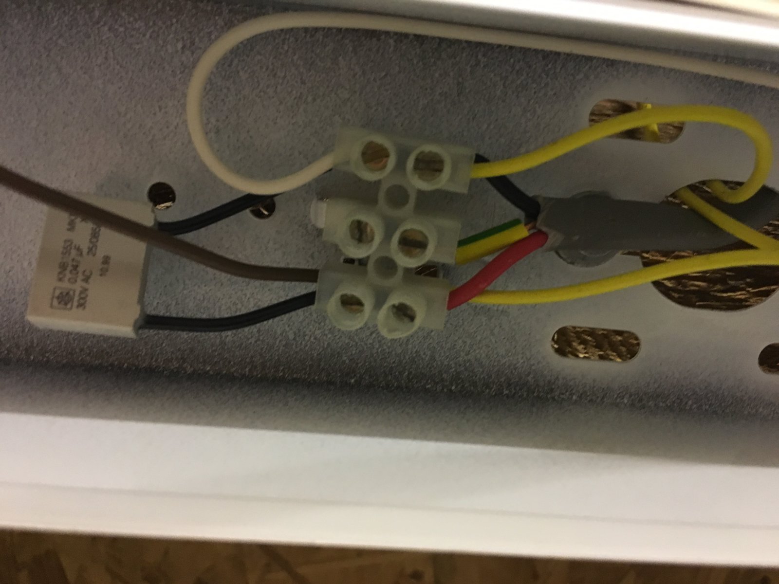

Hi, I have just replaced a traditional fluorescent strip light for an led one in my garage. All seems ok but when I switch off the brightness goes instantly but a feint light remains! Is this normal? Will this go over time or should it be instant? I have checked and double checked the wiring.
Ok, a very technical fix for what I thought was a simple fitting swap. Take a look at the attached photo of the fitting I removed. Is the small white unit with 2 black wires a capacitor? If so could I attach to the led cable connectors to solve the problem?
A similar capacitor is basically what is contained in this device http://updates.clipsal.com/clipsalonline/Files/Brochures/W0001507.pdf
It, or something similar, should be available from Schneider Electric - which owns Clipsal.
Ok I will give it a go next chance i get.

Hi, a late reply I know but I have tried a capacitor (Screwfix) and a supressor (Maplin) but with no joy.
Before I start changing the wiring, would changing to a one-way switch solve the problem?
