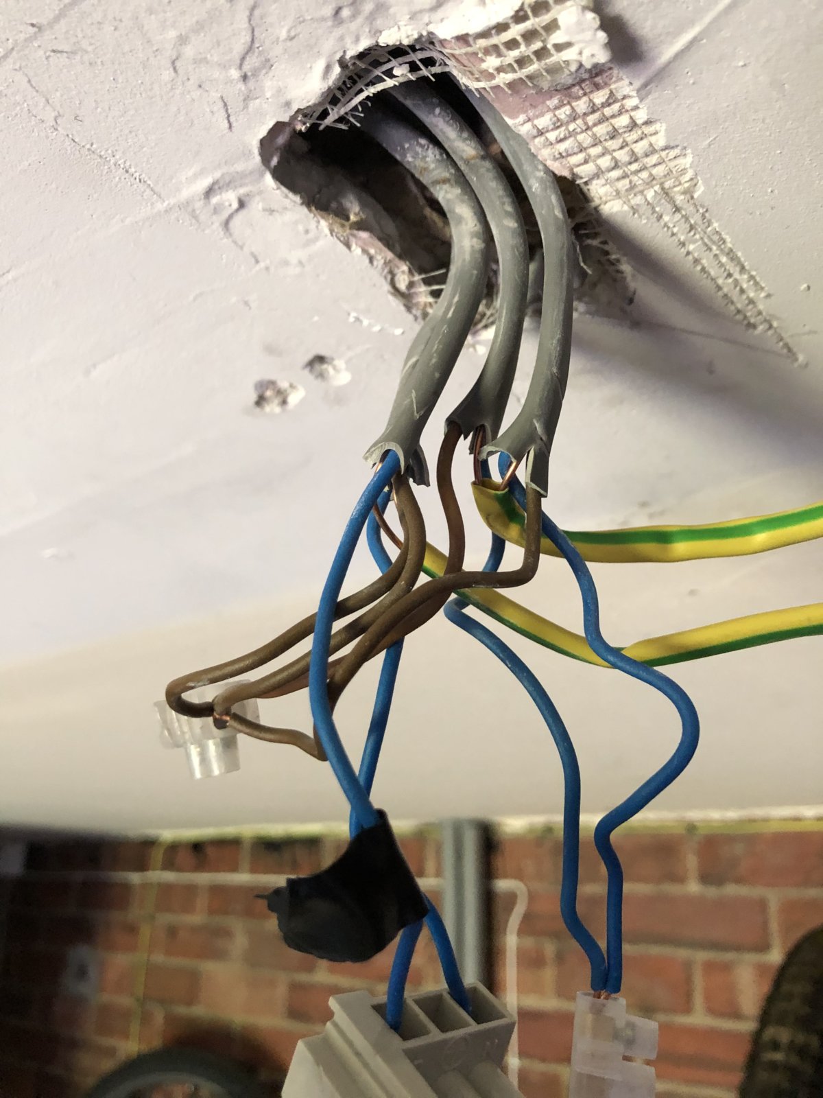

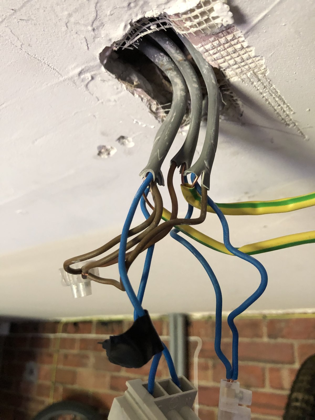

What wires do you have in the 'complicated' fitting? we like pictures.
I found the switched live or so I thought. This light is working fine but the other light is not working at all

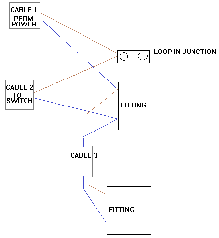

I assume the white block bottom left is the fitting and the choccy bottom right is just a junction for the 2 blues.
How many fittings are there all together, you have mentioned 2 so far?

I used the multimeter to check the neutrals and the one I have marked was the only one that had voltage...
Neutral does not mean BLUE.
Neutral is the name of the wire from the light back to the supply whatever colour it might be.
One of your blue wires is a Switched Live.
You have four cables, Supply cable, Switch cable, cable to other light. Where does the fourth go?

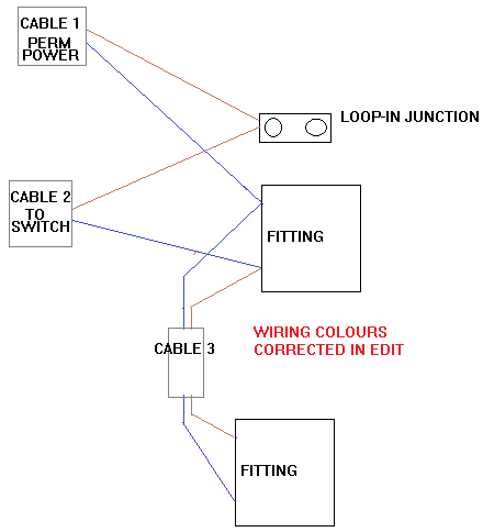

The first thing to do is identify which cable is which and this can only be done with the power off, disconnecting all the browns and blues and putting them into choc bloc [or some other way of making them very safe].
1) With power on CAREFULLY AND SAFELY
EDIT: WITH ONE PROBE OF THE METER CONNECTED TO EARTH, MEASURE THE VOLTAGE ON ALL 8 WIRES.
HOPEFULLY ONLY ONE BROWN WILL BE 230v. This CABLE is the live feed, label it '1'.
2) With power off identify the switch cable using the ohmmeter and label it '2' or switch.
[I assume that 1) & 2) are from the 2 blues in the fitting so that should be fairly easy]
3) With power off identify which cable is feeding the second fitting and label it '3'.
Wire like: SEE POST 11
4) leaving the 4th cable safe, Test these lights for functionality.
5) Go right round the house and check every light to see what doesn't work then report back.
Obvious warnings about not working on live cables, falling off milk crates, working in the dark etc...

OP- you've wired those LEDs in series either with each other or with something else. Presumably you didn't take photos or mark the cables before you pulled them all out (your pic is an AFTER pic?) - follow @SUNRAY 's guide (each wire needs to go into a separate terminal, not all rammed together in one hole. You do this to keep track of them, to make it easier to apply meter probes and to prevent them accidentally shorting out when you are applying meter probes).

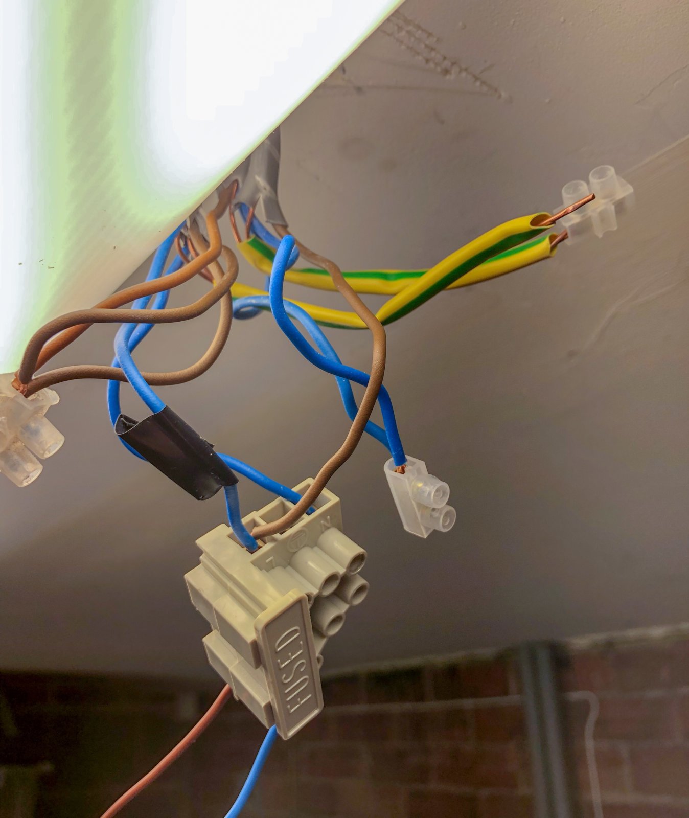

I have a multimeter so I took all the wires out and put each in a chock.
I then tested the blue wires for voltage and the one I put black tape around was the only one that had a voltage it was hovering around 160.
I tried all the live wires in turn. The configuration i left it with last night gives me power to the batten with 4 wires but nothing to the other batten in the garage. The wall switch works. Other configurations of brown give either nothing or dim power or one where I get power to both lights even with the switch turned off.

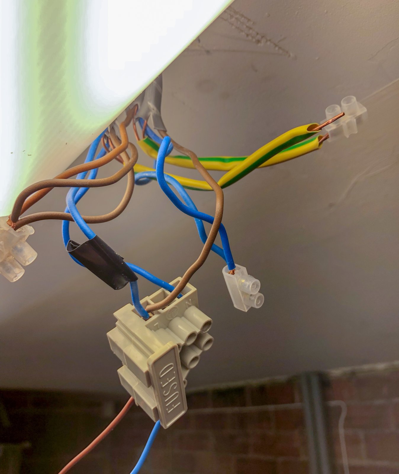

I have identified the live feed (brown wire) and labeled it 1.
I then tested the blue wires for voltage and the one I put black tape around was the only one that had a voltage though not up to 240 it was hovering around 160.
That is irrelevant.
You must determine, with the power OFF, by using the continuity setting, which cable goes to the switch and which cable goes to the second light.
