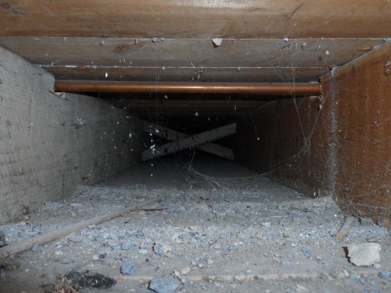

Yes herringbone, I thought so. These keep the joists perpendicular, and allow for maintenance in that direction, but allow horizontal displacement to take place unfortunately. I think with these spans you could place a row of full depth dwangs equidistant each side of the herringbone dwangs and their respective walls, leaving the herringbone undisturbed. As said earlier, assuming the ceiling could be propped from below and the props screwed up until a level floor was achieved, the full dwangs would give a torsion box effect i.e. when the props are backed off the floor & ceiling will remain all but flat as it were and the resulting floor, as you want it...pinenot :)

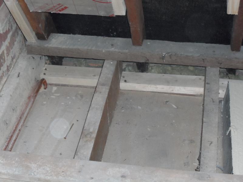

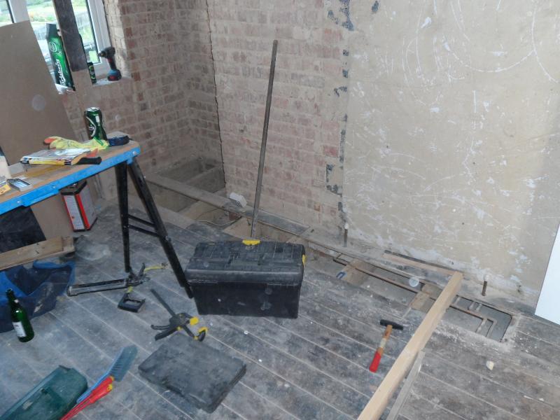

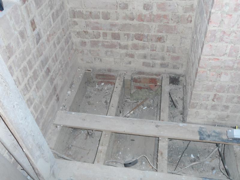

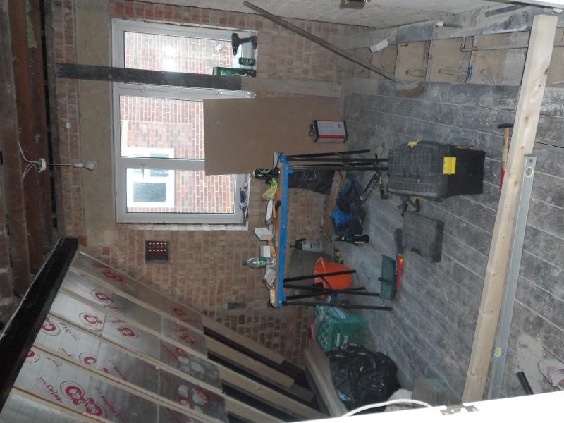

I did make some photos.
The room
The roof side. the joists just sit on the brick wall, I did put some noggins in at the bottom to stop them twisting on the end before I started looking at getting it all level.
The X :)
The other side
And the left side
I believe the hight difference has been build in then just sitting the joists on the brick wall and using slight different sizes of joists.
