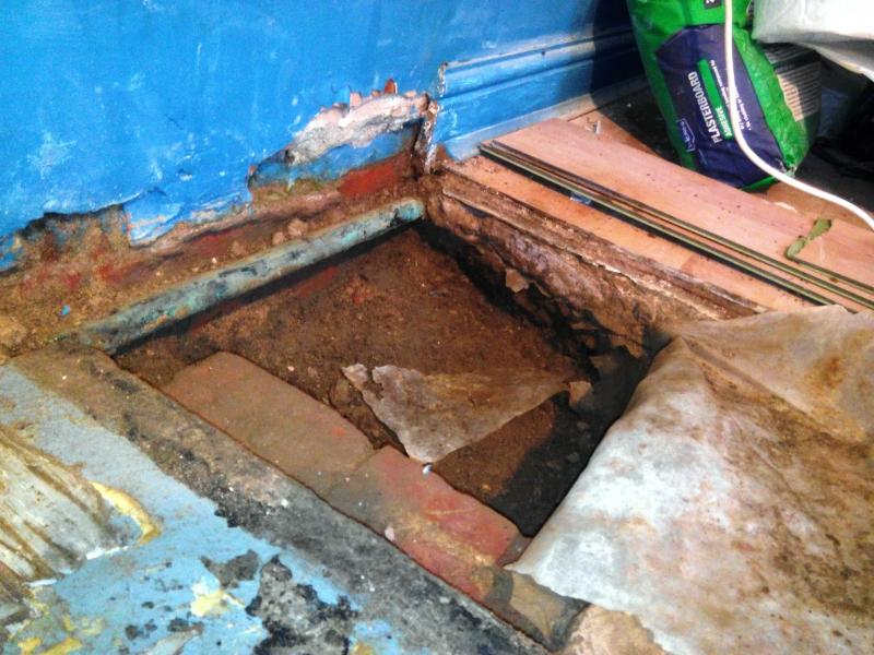

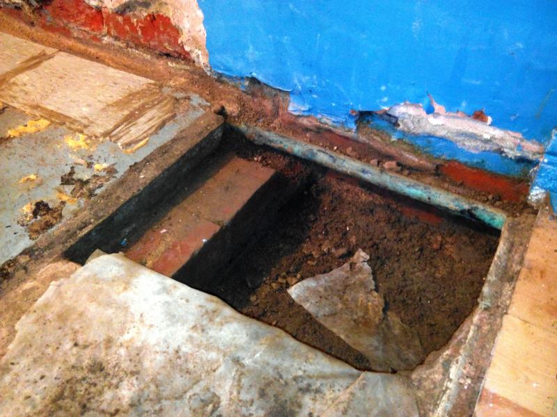

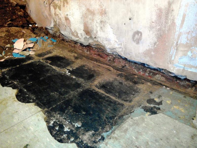

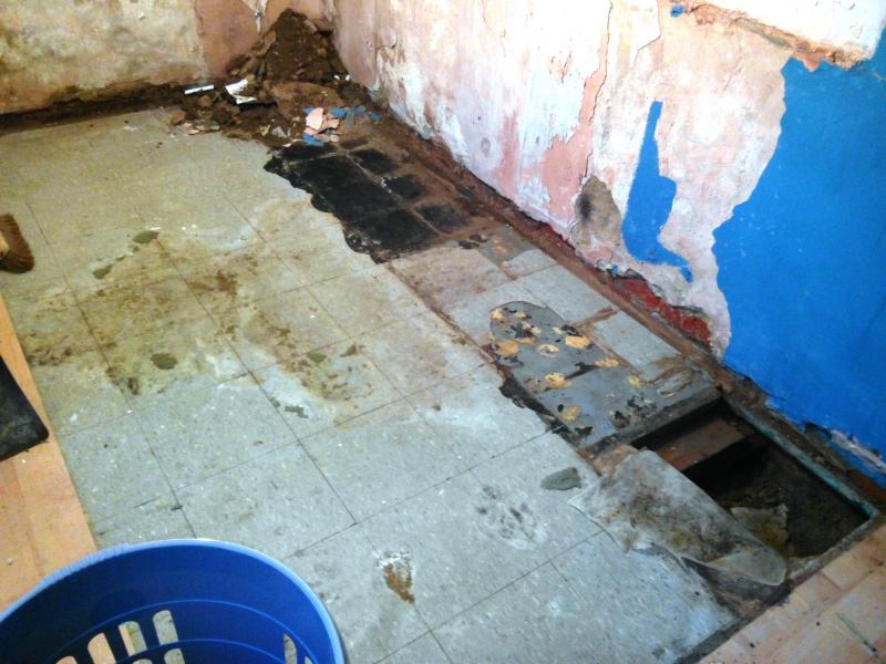

Please see images attached of sub floor.
I am still in the process of removing the old glued vinyl tiles.
The new flooring is likely to be laminate wood.
The moisture on the floor appears to be working it's way from the edges of the floor. Last night I dug out a square patch of concrete that appears to have been repaired at some point in the past. As you can see, there is a water pipe running along the edge of the kitchen and the DPM on the repair seems to have been compromised, explaining why the repaired patch was loose.
The concrete floor appears to be about 2 inch thick, laid directly on top of bricks for the majority of the kitchen. I can't see any DPM on this area. The area that I have dug out is mainly 2 inch concrete directly on DPM which is on top of clay/debris. I intend to repair this patch properly with some new DPM and some form of tanking to enhance the seal around the edges.
As the moisture is working its way in from the edge of the floor, I guess I need to tank the edges up to the brickwork. The brickwork appears to have some DPC at 150mm above ground level.
Any suggestions would be gratefully received.
Right mess that eh. Really it needs digging up and a new sand & cement screed putting it but if putting laminate down and you want to help stopping moisture getting through the sub floor you could
1, remove all tiles an as much adhesive as you can.
2, leave floor as long as you can to air an dry out a bit.
3 latex screed with Ardex NA
4 Ardex dpm 1c dpm
5 a good dpm underlay for laminate
