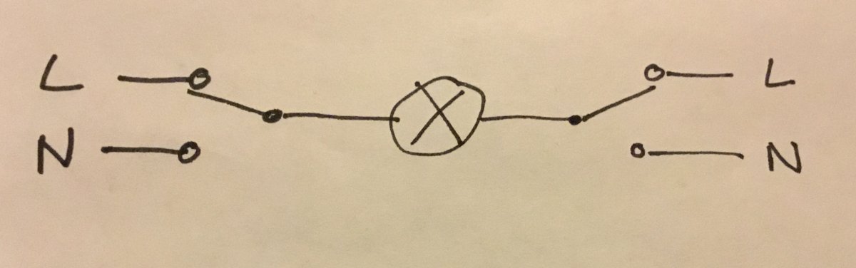

PS: In case anybody's interested, that third two-way circuit has both L1's connected to live and both L2's connected to neutral - or the other way round if you prefer. The light goes between the two COM's.

Anyway, can anybody help post a diagram of the 'third way' of wiring a 2 way switch that is unsafe?
I read the above but don't quite understand why it's unsafe.

endecotp said:
.Imagine that you have a two-way-switched hall light wired in this "not recommended" way, and the switches are set as shown, so the light is off:
image-jpeg.110211
I found that two way system in a couple of houses in the distant past. More recently I came across it when the house owner mentioned that the light switches on the stairs needed replacing frequently and often tripped the MCB. When the switch was operated the arc between the fixed contact and the moving contact continued until the moving contact landed on the other fixed contact. The arc was now crossing the 3 mm gap directly between Live and Neutral and maintained itself until the MCB tripped or the switch burnt out
In the old bakelite and ceramic two way switches there was a large gap between the two sets of fixed contacts. Often they were two separate make switches with a common toggle. The moving contact was far enough away from the fixed contact that the arc collapsed before the moving contact reached the other fixed contact

The danger is that both sides of the lamps can be Live when the lamp is out. This could be a hazard to anyone who assumes that because a known good lamp is out then there is no Live in the fitting.
Of course - hence my question!! As I said, it appears just as dangerous as switching the neutral which presents the same hazard.
Kind Regards, John
yes it's not as dangerous as exposed live parts, but it's up there with reversed polarity and switched/fused neutral.
Also as it turns out, through the various switch states you can have a borrowed live and neutral with this setup, ie the light could be powered off downstairs live and upstairs neutral, or vice versa!

Thanks for the diagram. I can see why it's not safe. It pays to be careful to switch off the breaker even if one is changing bulbs.
