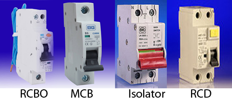

so at first i had the trip switch on and the lights in one room on for about an hours or 2. Then the fuse tripped; so turned it on again, then it tripped again about 5-10 minutes later then switched it back on again. then tripped again and i turned all lights off and tried it and as soon as i tried turning trip switch back on, it would instantly trip and there was light/ a spark showing inside the box behind the switch
So where do i look first please?

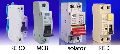

Umm. Fuses don’t trip.
What exactly is the device that is “tripping” ?
Post a photo if you aren’t sure.

What is tripping?
It might just be a faulty bulb or loose wiring in the switch/ceiling rose. Check bulbs and switches and get a sparky in if still a problem, especially if there is a spark at the board.
Start simple, take all the bulbs out and see if it still does it

as i said before that I switched everthing off and still tripped

There are three tools, the RCD tester to show it is OK, the insulation tester to test when there is no power to the circuit, and the clamp on ammeter to test when it has not tripped.
One of these VC60B.jpg costs around £35 there are more expensive which are calibrated, but I got this one for £35, it uses 500 volt DC to test, so clearly you need to know what you are doing. If you can't be sure it is the RCD in spite of pictures, I am not sure it is safe for you to try to DIY the diagnosis?
