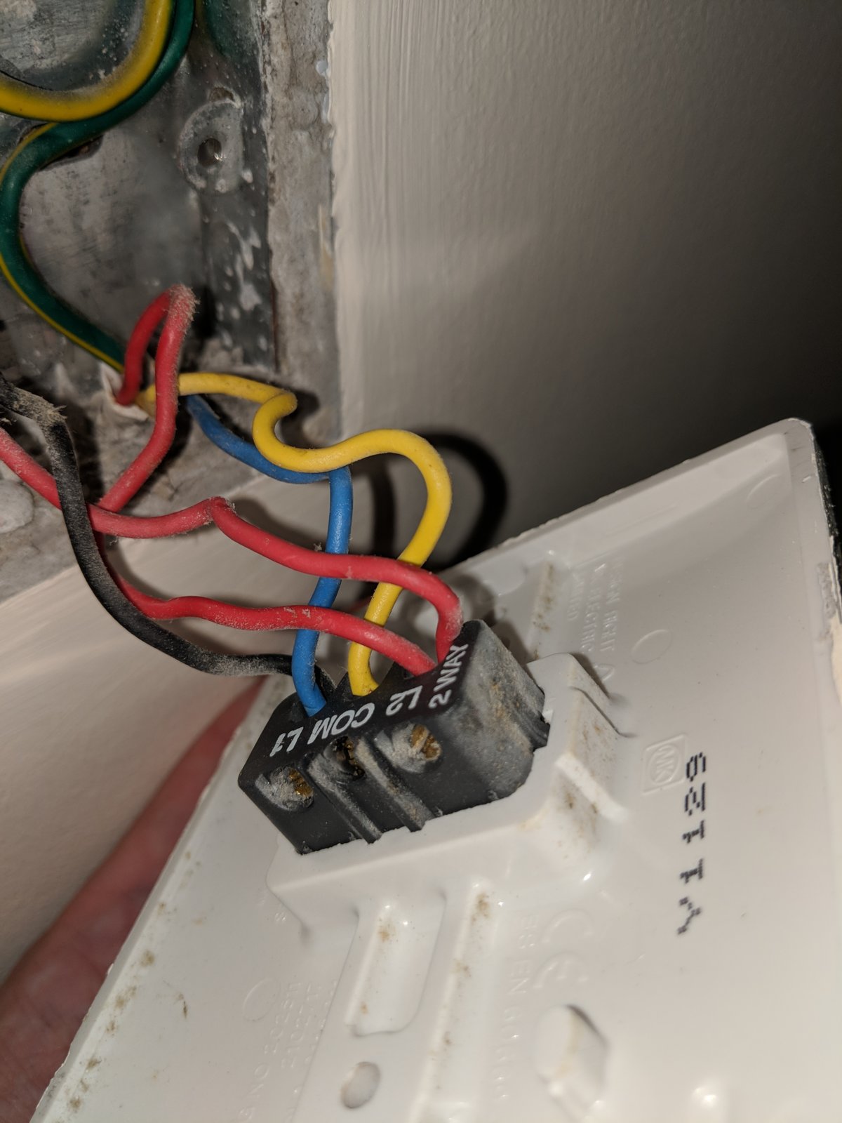

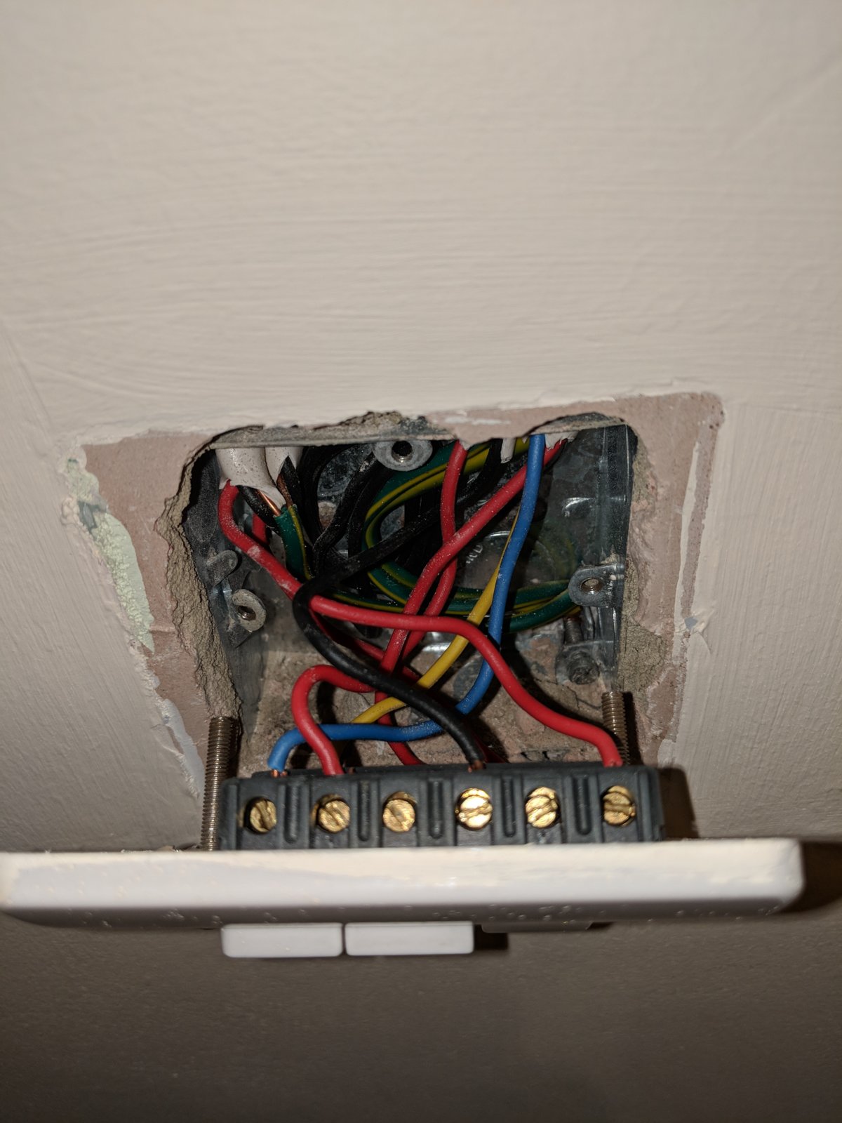

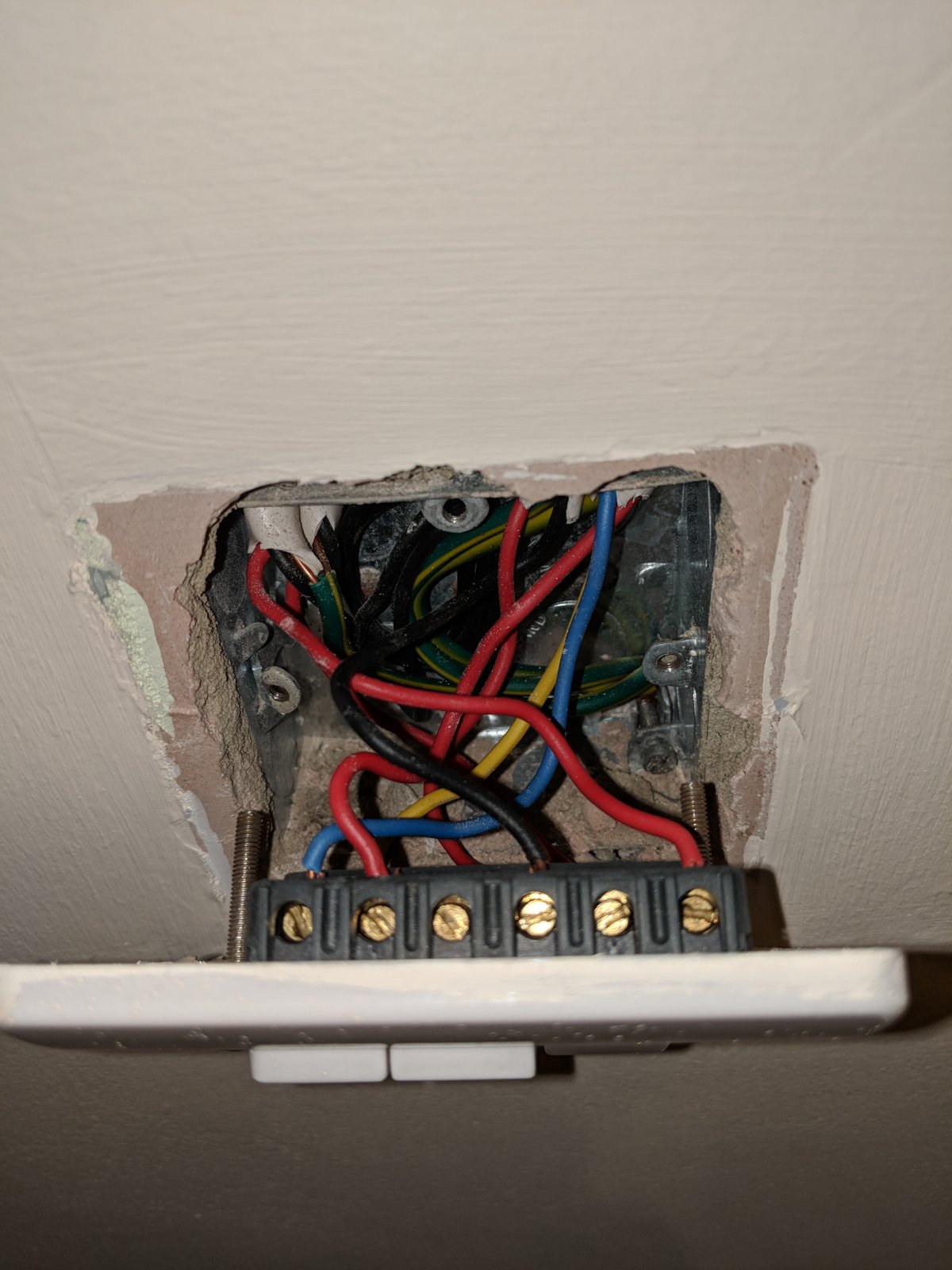

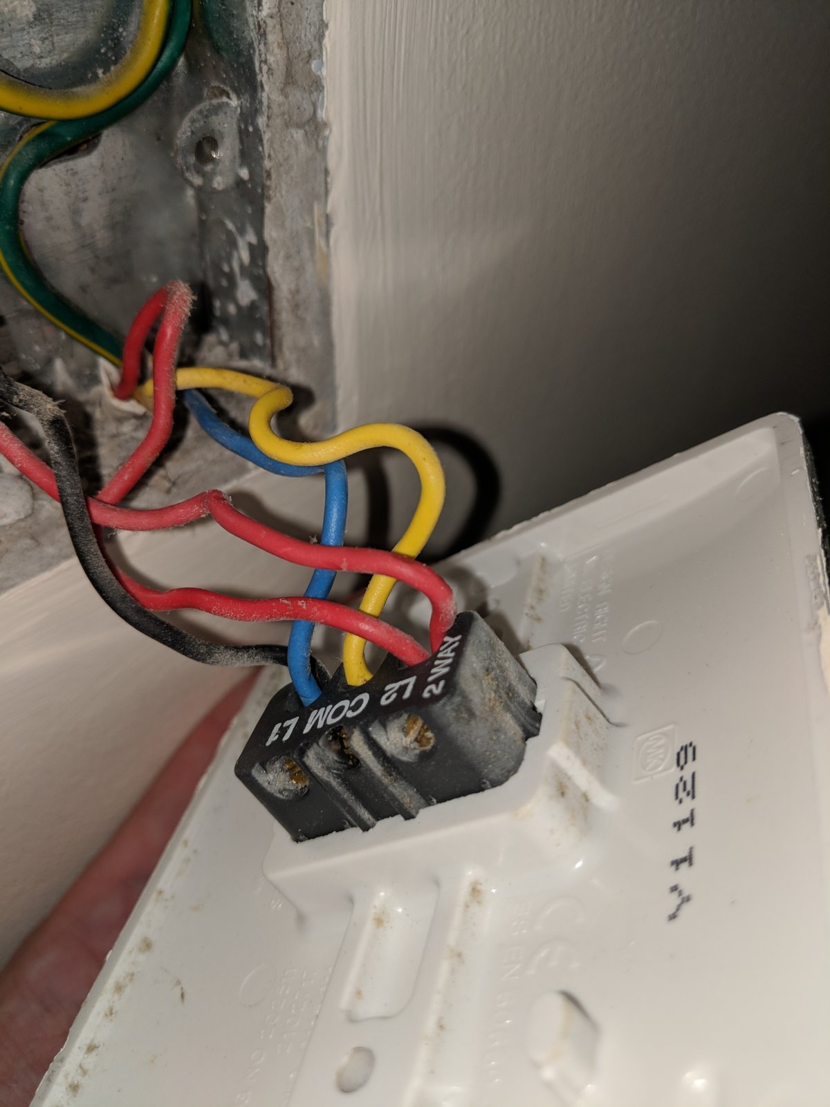

The original wiring can be seen in the photos.
Upstairs:
Switched live (black) and 3 core blue to L1
3 core yellow to COM
Live (red) and 3 core red to L2
(Note this seems somewhat different from most standard wiring diagrams)
Downstairs: (the left most gang)
3 core red to L1
3 core blue to L2

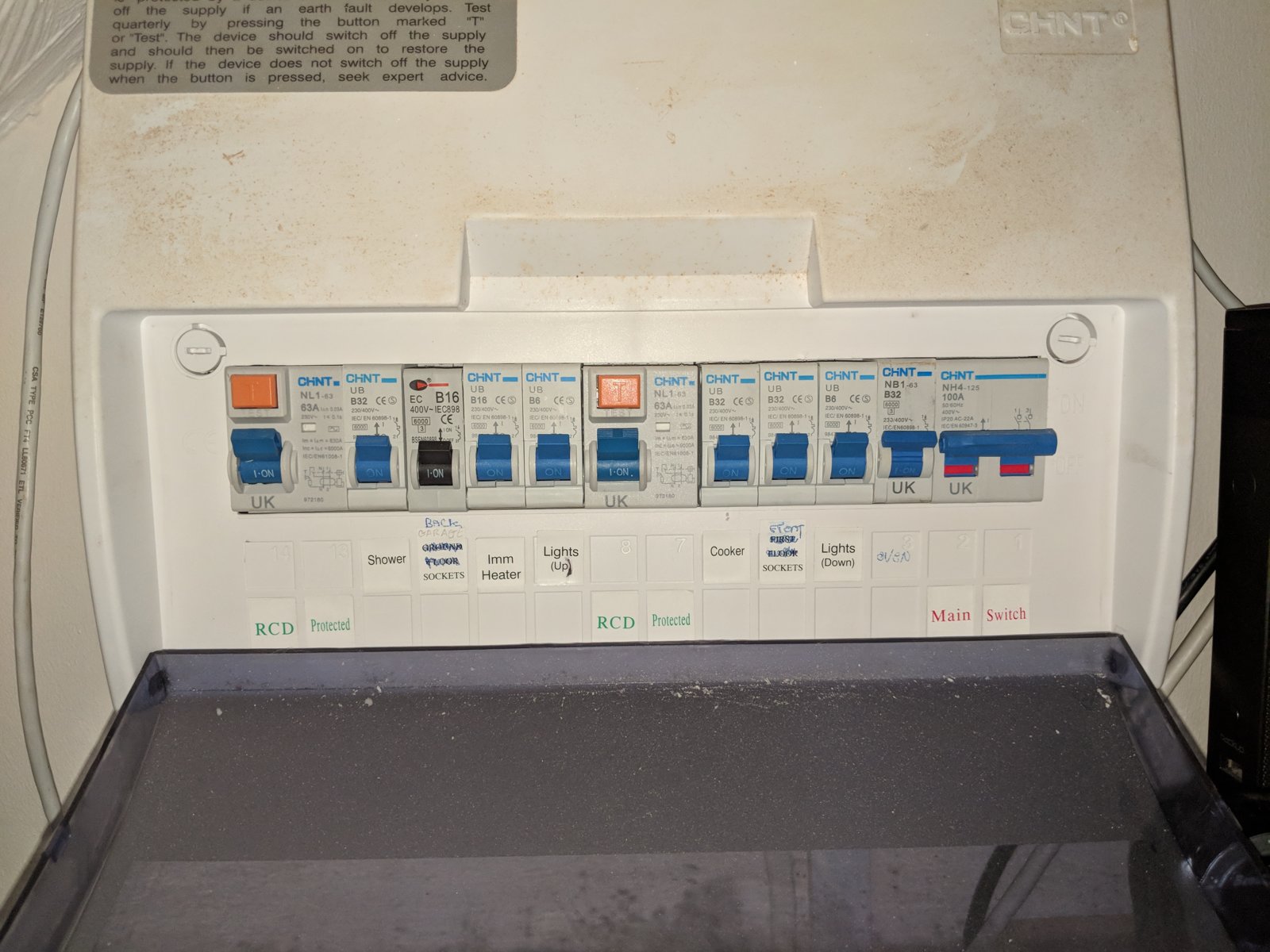

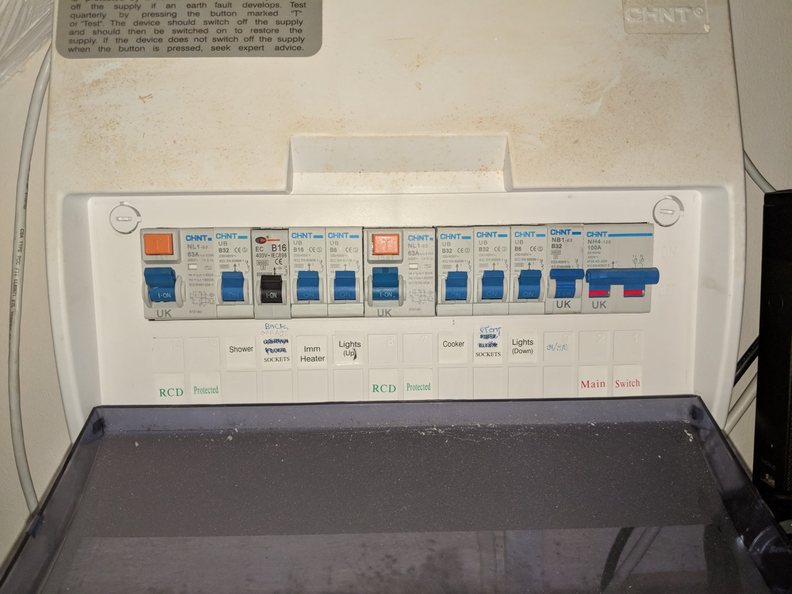

Hi
Picture attached.

Your CU is in two halves. Each half is protected by a separate RCD.
You have the upstairs lighting on one half and the downstairs on the other RCD. This is the normal way of doing things, as it means that, should something trip, you don't lose the lights for the whole house.
As you have essentially combined the up and downstairs lights in your fancy switch, the RCD sees it as a fault and trips. It is doing its job.
A quick and dirty way of fixing your issue would have been to move the upstairs lighting MCB on to the other side of the CU so that all the lighting is on one RCD. This would have solved your tripping issue, but you can't easily do that as your bargain basement consumer unit (Chint, ugh) has no spare spaces. It can be done, but it would need some serious re-engineering of the consumer unit.
