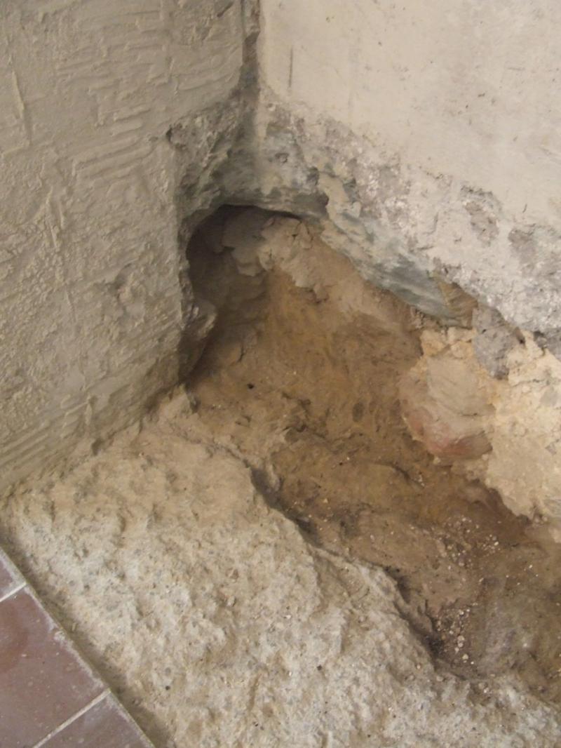

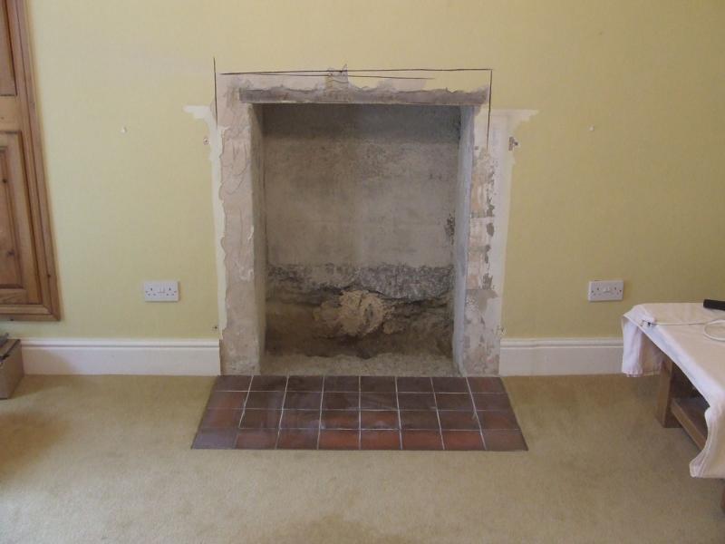

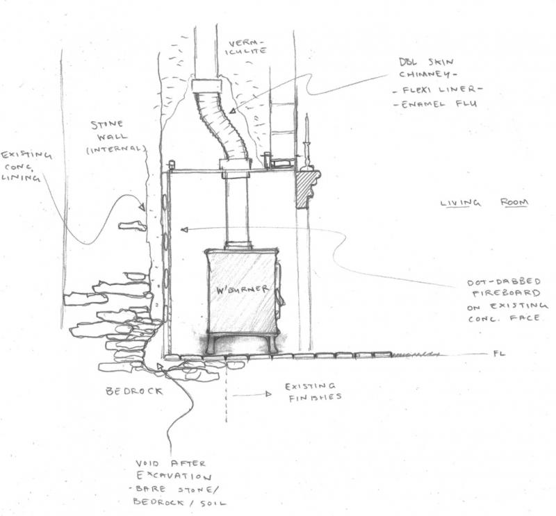

I am in the process of reinstating an old fireplace in order to take a woodburner. The recess of the old fireplace is already concrete lined and exists in an old stone wall, as per cross section diagram. Unfortunately, during the excavations to get to the fireplace, we had to created an opening in the lining, revealing the base of the stone wall and some bedrock (see pics) and I'm wondering whether this will be an issue.
After doing my homework, I figured a dot-dabbed, fire resistant non-gypsum based board would be good for the lining but I'm at a loss as to what to do with the revealed stone, especially when considering damp issues?
An additional minor issue: The base of the existing chimney lining terminates half an arms length above the register plate and is packed with vermiculite. It should be easy enough to attach an adapter to a flexi liner in such confined space, right? If it needs a screw it'll take some contortionist driver work.

Cross Section for your amusement
Fireplace as it stands (n.b. decommissioned gas pipes enter through the centre-bottom, packed in yellow sand, visible)
Detail of the revealed bedrock
Do some more homework; silica (non gypsum) based boards are what you need but you can’t rely on dot & dab to secure it in a high heat area. Read this little lot & a it will give you some pointers;
May or may not be acceptable; what you doing is controlled building work (as you will see from the links) & you should either be getting a HETAS registered installer to advise/install for you or submit a building notice & have LABC inspect/witness test.

I guess my main question, what should i do to fill the dirty gaping hole at the bottom of the recess? I need it ready to render or board up, so, would it be okay to lump some concrete in there? with a heat resistant mix? Or is it okay to board over it as it is?
Basically, this needs to be filled square and true:
I would definitely fill the hole; use a sand/cement/lime render mix & fill it out in at least two stages; info on this in the archive links I posted.
You can board it out but as I said don’t just rely on dot & dab, you need to mechanically fix or it will probably fall down in a very short space of time. You could also consider rendering it after filling the hole but that looks suspiciously like tile cement on there to me so you need to get rid of that before rendering; use a 2 coat sand/cement/lime render with the second mix slightly weaker. Don’t know what sort of fire surround you propose but don’t use Gypsum plaster to dress up the area around the opening either, it will fall off. I would also get existing liner checked out for condition/suitability before doing too much work on the fire opening itself.
The opening doesn’t look very big to me; can you get a freestanding log burner in there? It depends on the “look” you want but have you considered an inset stove? We have a multi-fuel which offers greater flexibility & higher heat output, 8Kw in my case.

I've got some lime in store so I'll get the hole filled as you suggest. Beyond that, I might render/board the recess and tile up the base but let a HETAS engineer deal with the rest, depending on my ambition when I come to it. Whatever the case, I thank you for supplying info on mixes and such. And yes, that is tile cement ;).
As for the opening, the pictures don't do it justice and my diagram is way off scale, the recess is actually plenty big enough (up to standard, too!) and since we already have a decent wood burner (plus a ready supply of wood), that'll be what's going in there.
