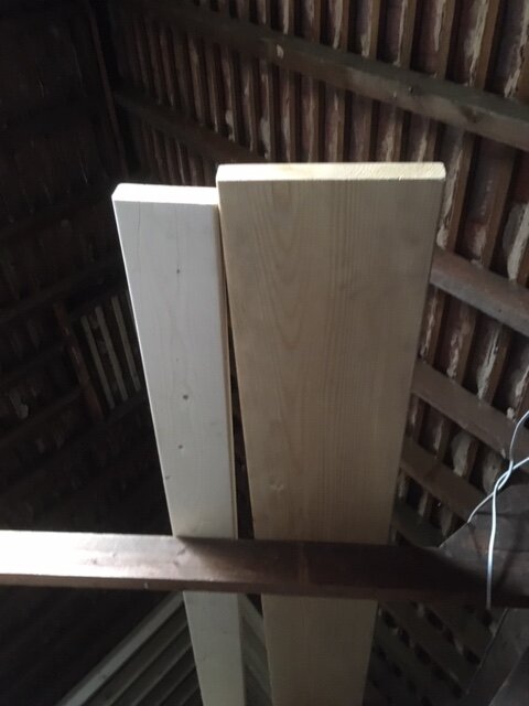

Hello everybody,
We're doing loft conversion in bungalow. I have two nearest supporting walls 502cm apart inner sides and 532cm apart outer sides. Our builder uses 30cmx5cm timbers for load bearing and the longest you can get is 520cm. So there'll be only (520-502)/2=9cm overlap between the timber and walls.
Is this long enough to work as load barer for the loft floor? Is there a building reg requiring a minimum overlap between load bearer and support wall?
Thank you

300 x 50 is a strange size in oak TBH, hence why I assumed it would be a softwood joist
I cant visualise why you would want an oak joist section.....
that is a big ask getting oak longer than 5.2m even that is pushing it.
12 x 2 (300 x 50) is the sort of size you see in ring beams. Never seen a joist that tall but so narrow - in older buildings they seem to go for wider and shallower on heavy joisting , (e.g 200 x 73 in C24 on my current project) although we did one job a few years back where the replacement joists had a 5.5 to 6 metre span and came in at 300 x 100 in 6.2 metres long lengths (C24). Those were bears to handle

This is not a joist - but large support timbers that runs doubled (or even trippled) in thickness along the edges of the roof (~400 to 800 mm away from edge). The floor joist are attached to them on joist hangers and run perpendicular to the timbers.

I apologies I' ve mistaken and misguided you - our timber is not oak, it's a soft wood (attahed). Probably pine.
