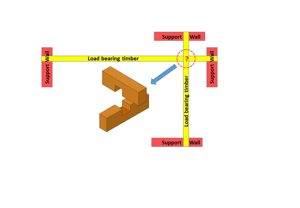

Hello everybody,
We're doing loft conversion in bungalow (1928 built) and it looks like the only option we have to run the load bearing timbers is to cross them over. Phisically it should be doable, but are you allowed to cross-half the load bearers by building regs?
P.S.
Image attached.
Details:
Soft wood timbers 30x5cm in cross-section, 5.2 and 4.2m long, ends resting on support walls.
Timbers run doubled (4.2) or trippled (5.2) in thickness.
Thank you

Not a chance, though I've seen it done and condemned it a couple of times.

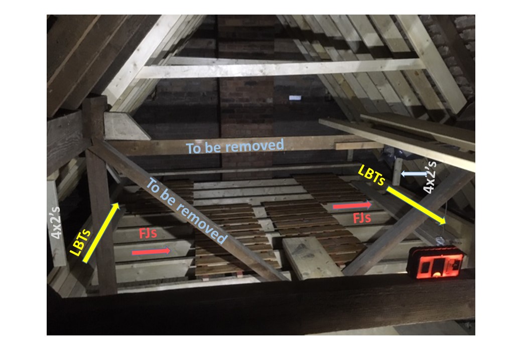

These LBT's are not floor joists (FJs), new FJ's are fixed perpendicular to the LBTs with joist hangers.
LBT's are also there to support the roof via vertical 4x2's attached to them after existing support timbers are removed.

In that case they are normally referred to as beams, and the existing joists are ceiling joists. Just to clarify, are the two "beams" in yellow both 300x50mm timbers? You photo shows 2 beams running parrallel and the drawing shows to beams crossing each other.
Thanks for explaining. So my LBT's are beams.
I called them floor joists (FJs) because they will form floor joists for the converted rooms in the loft.
Also they are not existing (old) joists but new ones 7x2's (freshly put). The old ones are ony ~2x2's and you can't see them as they are hidden by the new. They run in parallel to each other of course.
In general - all whitish timber in the pic is new one, while all dark/brownish - is the old original one.
Exactly. And they are doubled on each side (i.e. total thickness is 100 mm on each side)
You are right. The image is for the other half of the loft (part 1 for clarity) which is partly done in terms of new timbers.
There are no problems with doing this side.
The drawing is for the other half (Part 2) which is untouched and that's where the problem of how to run beams to provide adequate support for the loft floor arose. Sorry for the confusion.
It's part 2 I'm struggling to find solution for.

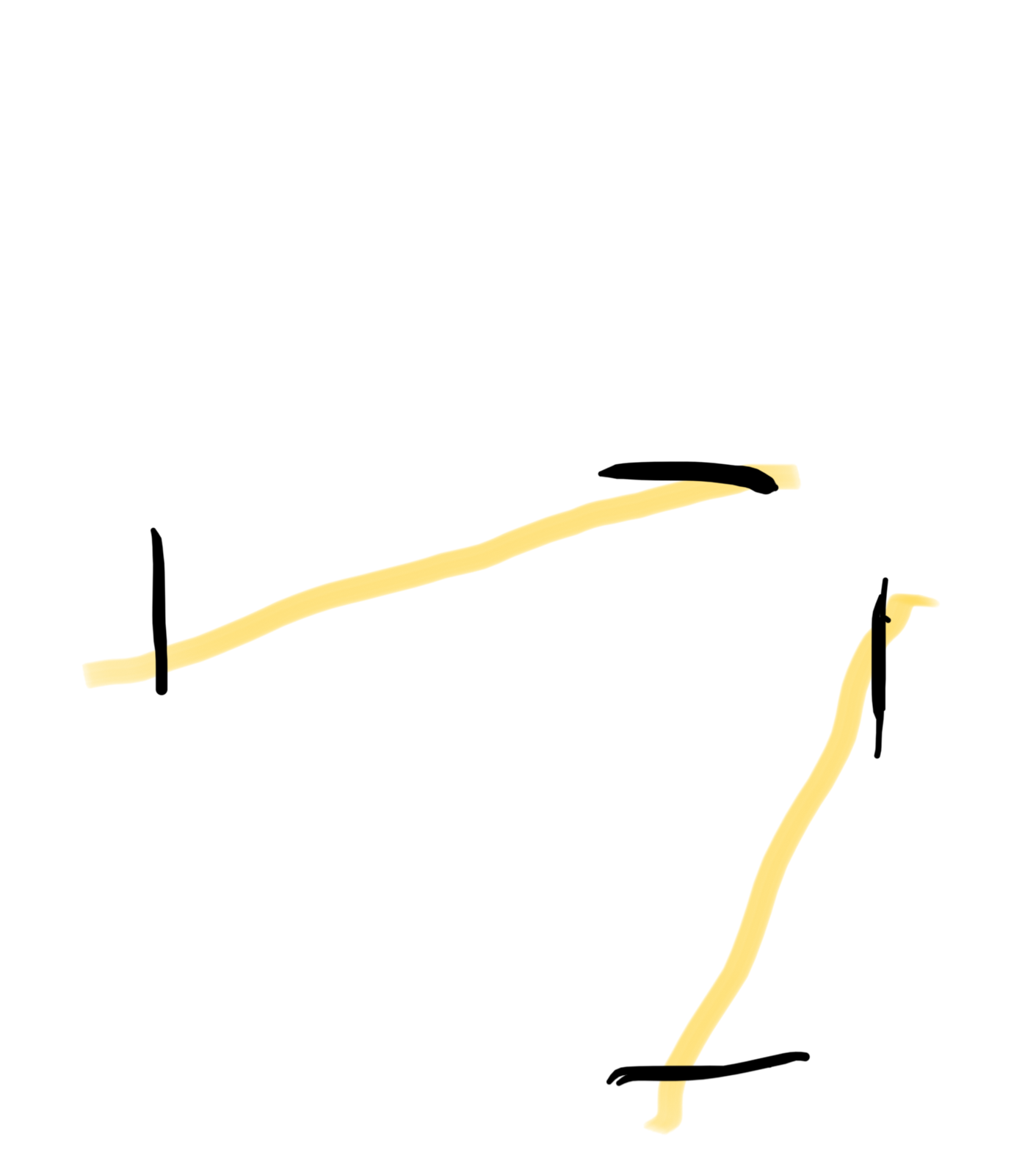

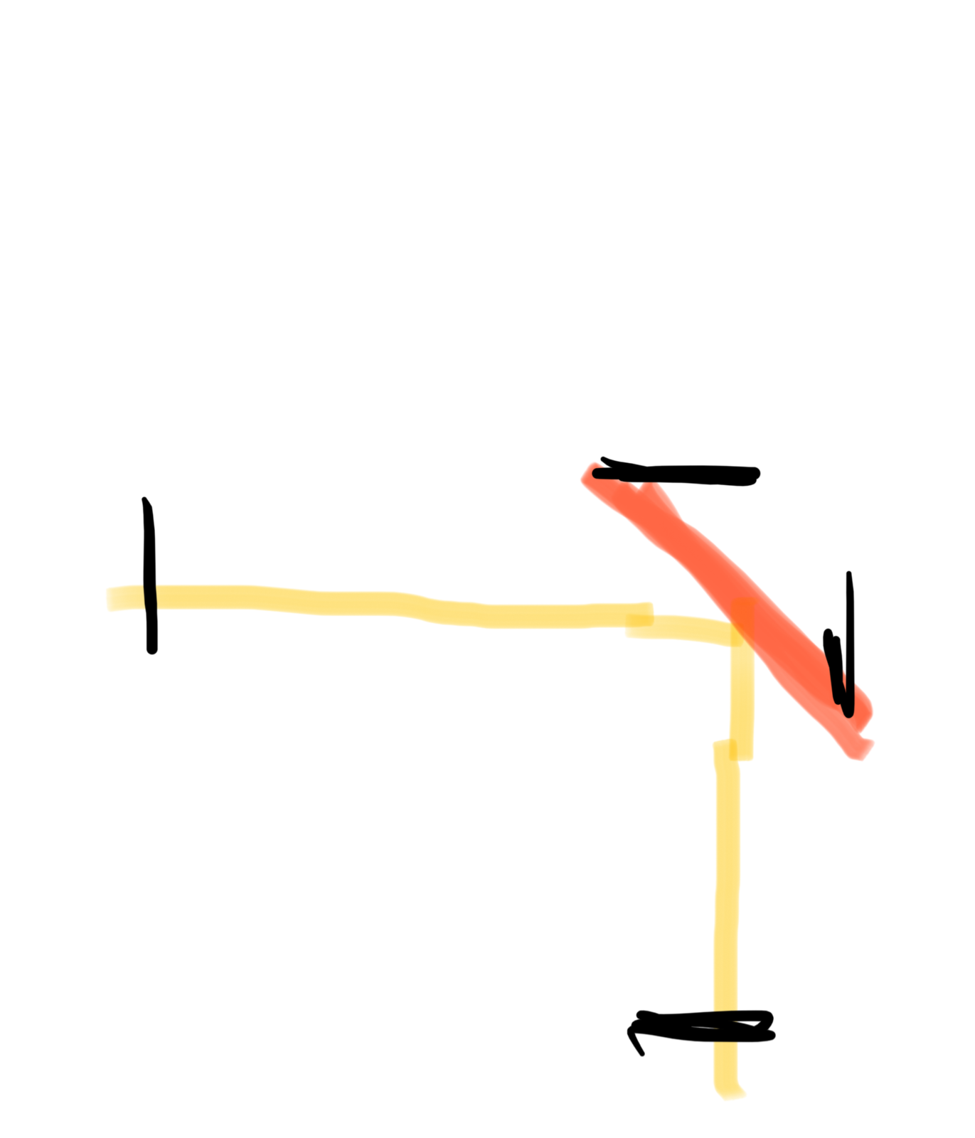

Stupid idea, but do they need to be square with each other?
Or could you span something very strong from the 2 top right supports and fix them onto that?
Thank you Ian for your ideas. To avoid going off topic I'll create new thread with better drawing and photo of the 'difficult' area.
