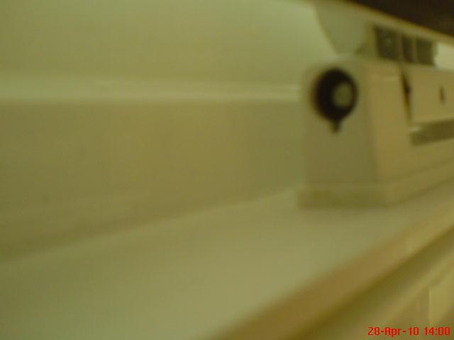

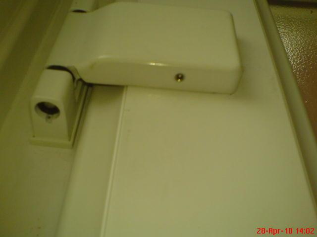

Following on, looked today. These do not appear to be 'flag' hinges ! No allen key spot at bottom, only what seems to be an end bolt surrounded by a sort of black seal. Right in the centre of the hinges on the front is some adjustable screw (like an allen key but one of those more modern phillips screws i think - like hexagonal but smaller). Wondering whether these sort of hinges are adjustable ?

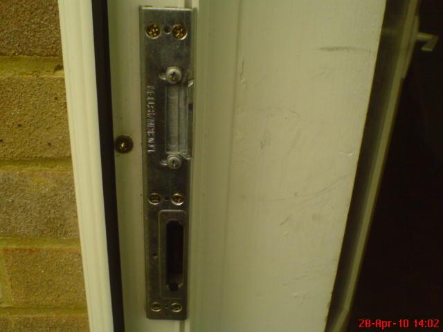

Checked the strike plate which still seems alligned ok to the block (lock). I suppose i could unscew it and move it down but it still looks comfortably central now. However , there does not seem to be away of adjusting horizontally rather than vertically (as mentioned before)

In the 3rd picture if you take the little grub screw out it will probably release the front cover plate off the hinge, this maybe will reveal an allen bolt that you can wind sideways but instead of the bolt moving the door does..........im guessing mind :!:
