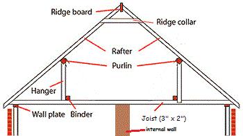

Our house is a semi, built in the 1950's. It's a cut roof, in the hip style.
Here is a cross section.

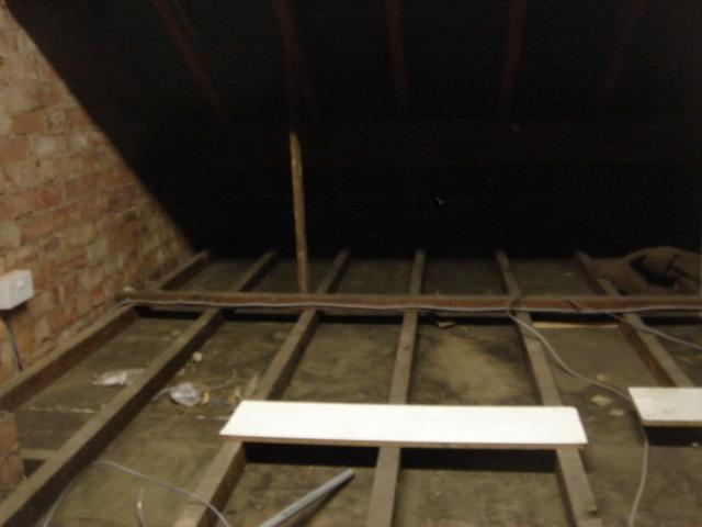

I've ripped out and thrown away the existing insulation, it was years old and wafer thin. Here is a photo of the empty loft, showing 1 of the 6 hangers. There are a total of 3 hangers on each binder.
Unlike most ceiling joists talked about on this forum, our ceiling joists are only 3" by 2", and I've found it impossible to find 3" (75mm) loft insulation on rolls, so in between the ceiling joist I plan on using 75mm Kingspan (or Celotex or Quintherm) rigid silver boards.
I then intend to cross batten the 3"x2" ceiling joists with 4" by 2" at 600mm centres and insulate between those cross battens with 100mm fiberglass rolls and then board over the top of the cross battens with those big green tongue and grove boards. In total this will give us 175mm of loft insulation (95mm short of the recommended 270mm but far better than nothing).

1. Am I ok screwing 4" by 2" cross battens into the 3" by 2" ceiling joists using say 130mm (5") screws? What would the best length and correct type of screw be for this job.
2. After the cross battening, would the extra strength be increased enough to allow the 6 hangers to be removed? If not, what’s the best way of boarding those big green tongue and grove boards around the hangers? Or could I recreate the loft hangers by attaching them to the top of my green flooring somehow? Or should I just be boarding the centre of the loft up to the hangers?
